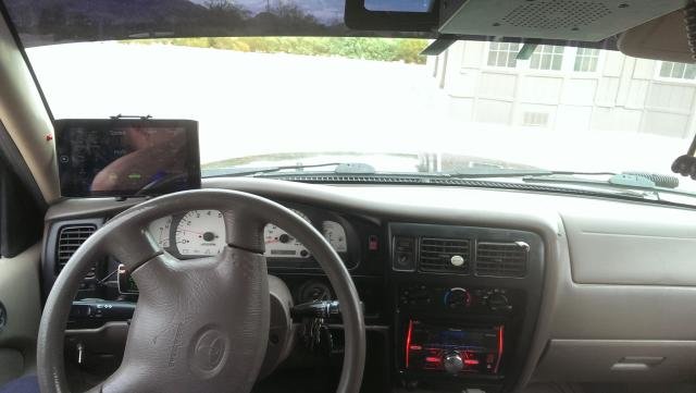

    Daytime shot. I guess it's not THAT big. Doesn't really bother me where it is now. Was about to rma but I decided to try and do a manual update to ICS, after having a hard time figuring how to do it, and it runs soooo much smoother now. Touchscreen response is fixed too! It's a keeper.

    Holy chit, I've done a lot already!!
    Just curious, is that on all the time? do you turn it on? or somehow does it switch on with vehicle power and start torque? May be dumb questions, but I was wondering.

    [QUOTE="OldManTan";9529292]Just curious, is that on all the time? do you turn it on? or somehow does it switch on with vehicle power and start torque? May be dumb questions, but I was wondering.[/QUOTE]
    Well for now I turn it off at night. Then back on. Lasted me a few days before needing charged. Doesn't use much battery having everything off except GPS and Bluetooth. But It boots up pretty fast. It has an ac charger so I bought a little power inverter for it and will have it charging while ignition is on. Although Idk if that's a good or bad idea. I heard you don't want to leave tablets on while charging. I'll try it and see if it gets hot. Or maybe I'll put in a momentary switch for the power inverter and switch it on when needing charged.
