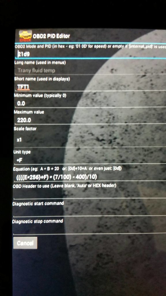

    Well, no such luck.
    Still get really weird readings when I use the '10+ formula with "21d9", variable between 13°F and 40°F while I'm driving.
    Re-typed the '09 formula and got the same "Equation: 0.0" results.
    I'm at a loss...

    My settings.

    Well, I've tried every combination of spaces, no spaces, different math symbols, etc with no success.
    21D9 only gives me readings other than zero when I use either A&B or C&D in the formula. But not proper temps.
    E&F or G&H give me ZERO.
    Thinking maybe whatever brand of ELM bluetooth adapter I bought might have issues?
    If only I knew someone else near me with one I could test.

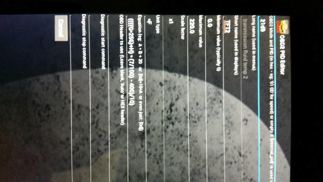

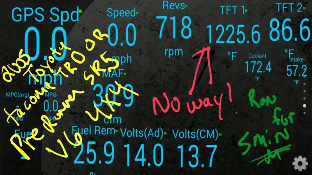

    Used these settings and am getting really weird readings. TFT 1 ranging from 0-320 at idle and with a slight rev. TFT2 went from -37 to -34 in about 5 minutes.

  12. Mar 21, 2015 at 5:59 PM

  13. Mar 21, 2015 at 8:51 PM

    I need to look at the temps again. My truck had been sitting for 5 hours before I turned it on. Read 85° for the TFT 2. Then the other was what you see above.
