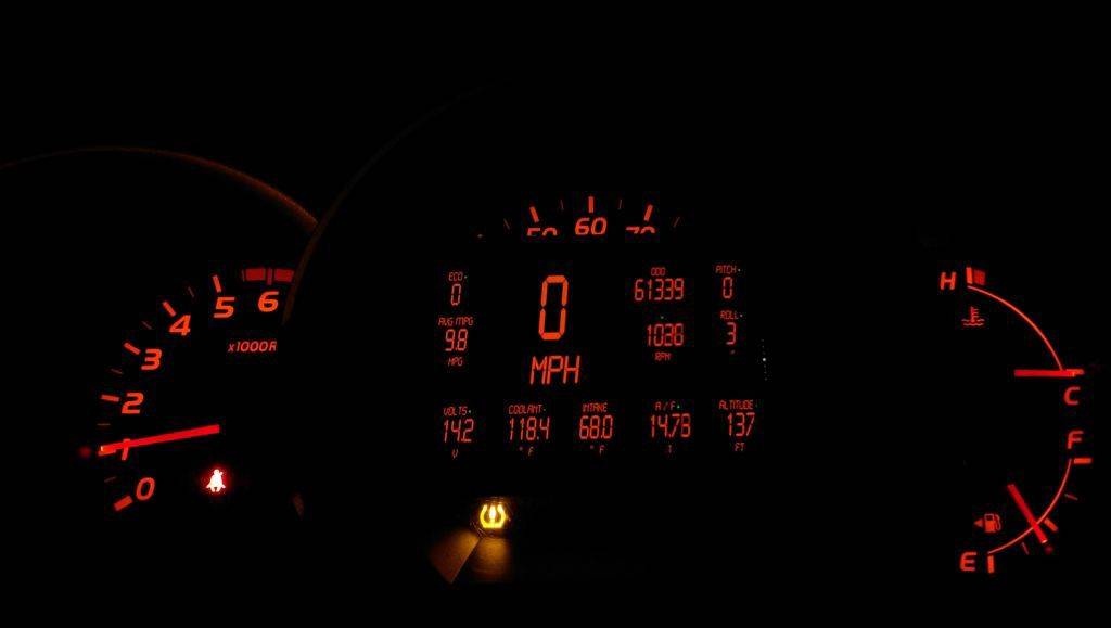

    replica9000
    replica9000 Das ist no bueno
    Apr 6, 2008
    #5782
    16,371
    Lake Chargoggagoggmanchauggagoggchaubunagungamaugg
    2019 T4R ORP
    I'm just using digital gauges. I blacked out the backgrounds to them. I've also lowered the DPI of the phone to fit more of them on the screen. The display is only 3.5".

    odomandr
    odomandr Well-Known Member
    May 14, 2011
    #56643
    5,876
    Andy
    Fort Collins, CO
    2010 DCSBTRDOR silver streak mica 2023 T4R Ltd blizzard pearl
    Icon, SPC,, ARB, BAMF, Warfab, SCS, Michelin, Leer Stock
    I only have one option for the roll and pitch to display, it's the image of the vehicle rather than a value representing degrees

    replica9000
    Apr 6, 2008
    #5782
    16,371
    2019 T4R ORP
    I kind of had to hack those in there. I had to create a pid for them, add the digital gauge, then delete the pid for them to work. They're really sensitive anyways. Only really good if you're stopped on a hill/steep bank.
