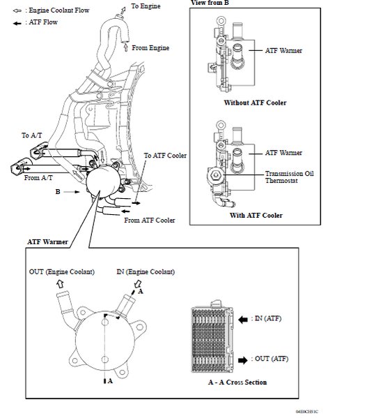

    This info shed some light on expected temps for the tranny fluid.
    http://www.toyotatundraforum.com/pdf/A750E.pdf
    Page 8:
    The ATF warmer uses engine coolant to warm up the ATF quickly and keep the ATF temperature higher
    (within limits). Consequently, the friction losses of the automatic transmission are quickly reduced, thus
    improving fuel economy.
    Models equipped with an ATF cooler have a transmission oil thermostat to switch the ATF passages.

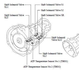

    Page 15 of that pdf also shows the temp sensor locations.
