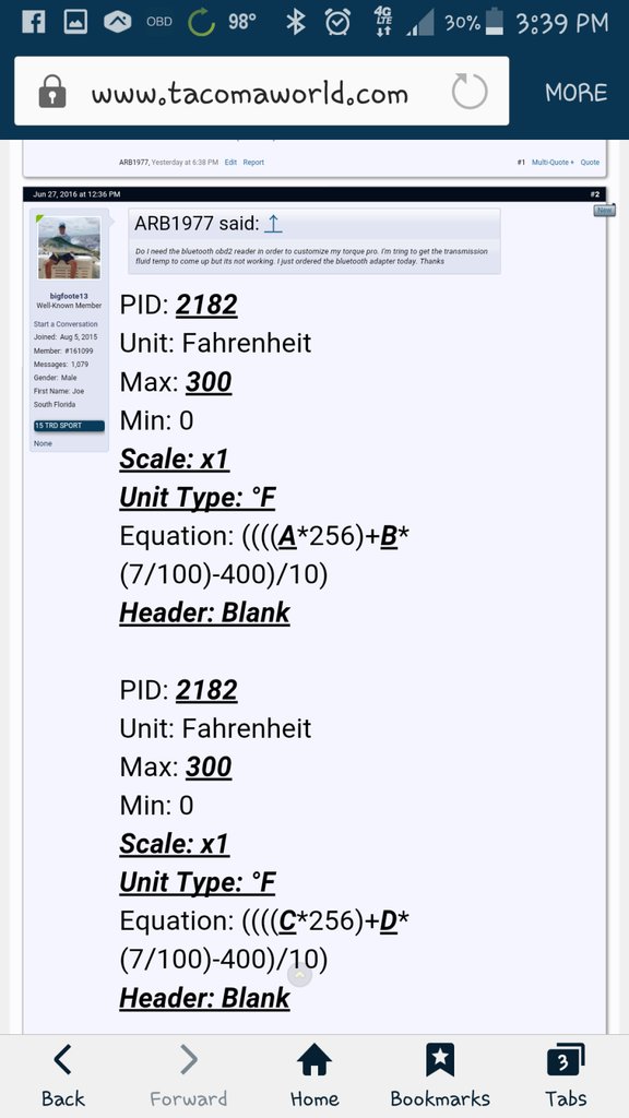

    Anyone know if this works for 2015?

    This is what I got on my 2015

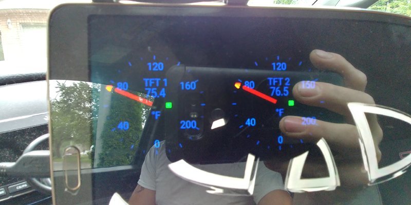

    Yes I'm reviving this motherfucker.
    I used this formula and got my temps to show. Fuckin love this site. (had just started the truck) 20170604_085148_HDR.jpg
    Is this stickied anywhere? It should be.
