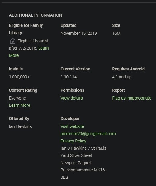

    On the Android side? I only see November 15, 2019?

    Scratch that, my phone says August 29, but the play store says November 14, 2019 :notsure:. Im still on Android 9
