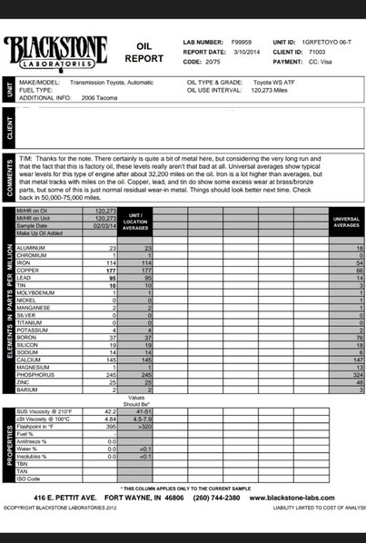

    And here's mine for comparison at 120k, first fluid change.

    Interesting..wonder why I got considerably more iron in my sample than you with nearly half the miles

    Someone better check their trans for an overfill...
    Thanks for posting the oil analysis' fellas. As I originally said when I first posted in here I'm not for or against WS other than paying Toyota when I could use cheaper and more available Valvoline MaxLife. We'll see what comes up when I run an analysis on it in a few thousand miles (unless it explodes from not using WS!)
    My report also had an average of 17,000 miles so my readings were showing high for having 50,000 on the fluid but it looks right around the same ball park for what their new average mileage is so I'd have no qualms running WS again.

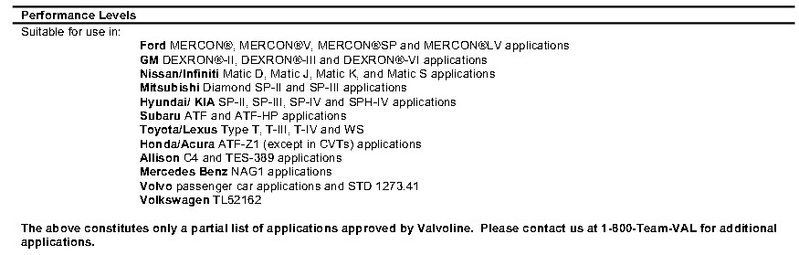

    As for the previous debate on always following Toyotas recommendation, there is some merit to that, and a bunch of crap. The simple fact is that GM (who makes all the fluids used) continually supercedes old fluid with newer varieties as improvements are made. They dont make older fluids like Dex-1, Dex-2 anymore. So when you look at these replacements, they meet the specs. For example
    Valvoline Maxlife Product Information

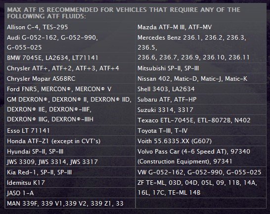

    Royal Purple Max ATF Product Information
    WS not listed and here's why:
