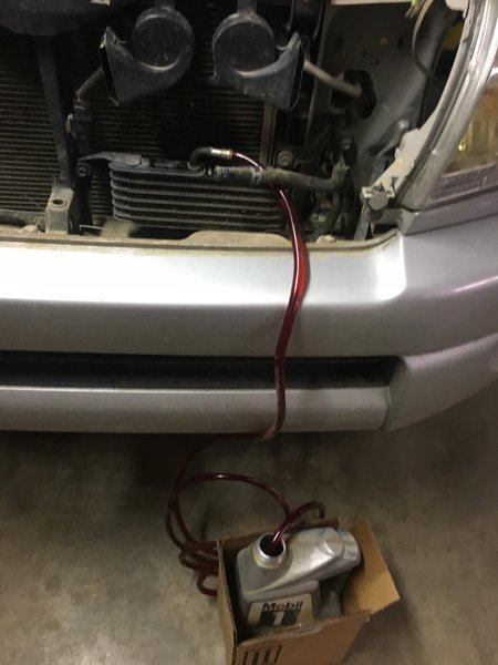

    If you have the cooler, the fluid flows out the top of the cooler, I like to hook in there. It's easy to take the grill out and hook onto the cooler outlet.

    This is exactly what I did; except mines a 2015 so the ATF Cooler looks a bit different; it has both hoses attached to the bottom; the far left one that is mounted towards the middle of the cooler is the one you want to hook into to drain the old stuff out just like so

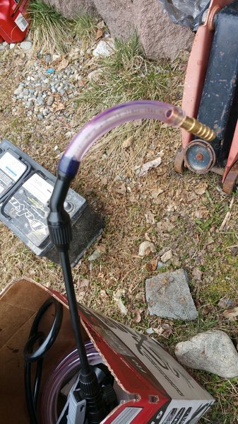

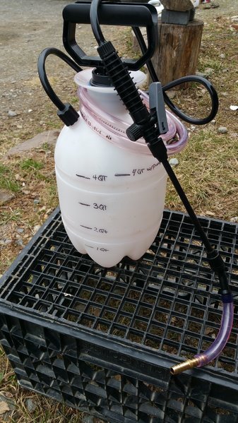

    I attached my homemade pump to the return line that went back to the transmission and pumped fluid into that; let the transmission pump out 3 quarts then pump back in 3 new quarts; rinse/repeat until satisfied. I uploaded my setup on another thread but I'll put it here too.
    ^^ Wal-mart Garden Pump made for spraying your plants with water and what not; cost under 6 bucks and works like the professional pumps. Cheap and works excellent.
