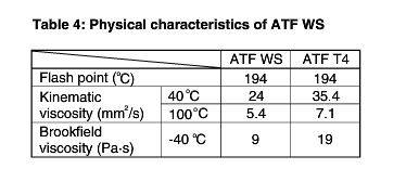

    Ive found an SAE Paper explaining Toyotas WS fluid and its developement for anyone that is interested.
    Toyota ATF-WS[​IMG]

    I'd love to hear opinions from others that know how to interpret the data better than myself.

    I looked at the MSDS sheets, and the Valvoline is as good as or better than the WS fluid. I fail to see what gear cruncher was telling us about when the flash points are so close (Exxon WS) vs. Valvoline. I've got valvoline in mine now and I'm very happy. I'll flush every 50K (5 years, for me) My total cost was $67.

    I agree, I don't think it's anything special, it looks to me like its a glorified Type IV with a lower viscosity. If you wanna use WS that's fine, if you wanna use Amsoil ATL or Maxlife that's fine too. I suspect you'll get good service and life out of your transmission as long as you're changing it on schedule. I'd rather have clean Maxlife in mine than WS with 100k...
