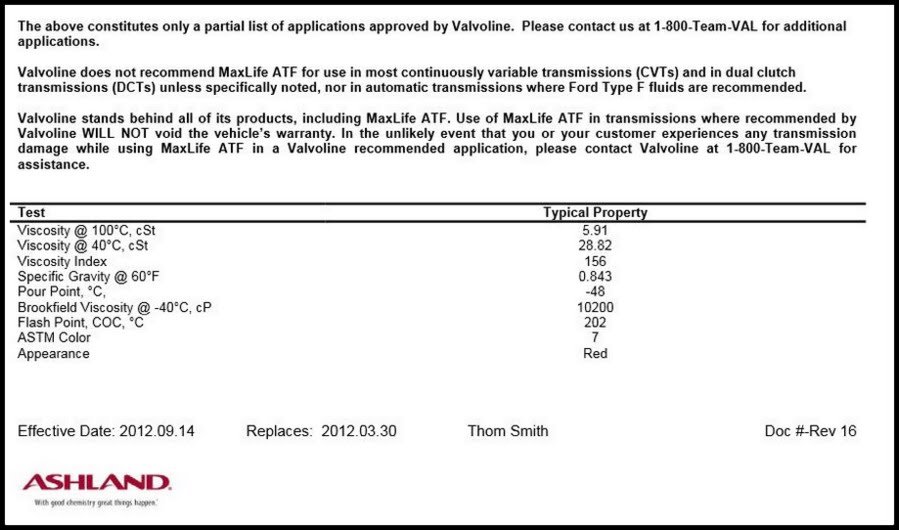

    lol! It's a truly horrible thing to do, to take legal advice from someone who is not a lawyer, or who does not understand product warranty law. Geeze...
    Sorry, but what you were told was fundamentally wrong, and basically a bunch of B.S. The Valvoline Maxx Life is a suitable replacement. It says so right on the back label.
    Here is a good place to start reading up on auto maintenance and warranties.
    https://www.consumer.ftc.gov/articles/0138-auto-warranties-routine-maintenance

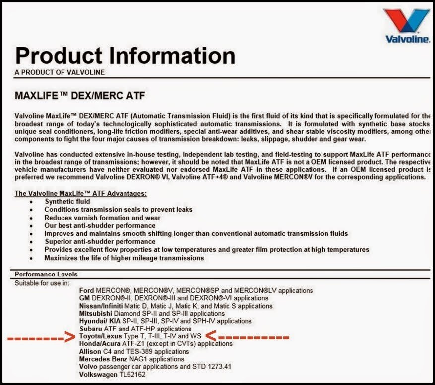

    As far as I know there is no legal distinction for the term "certified", all that usually means is that an independent entity, usually a credible laboratory, has verified claims made by the manufacturer. It then usually entitles the manufacturer, by way of a license to display a logo on the product in the market place. It's a form of marketing and helps the consumer make choices, and lends credibility to the manufacturer. That's it. That's all it does, it has nothing to do with product warranties.
    For an example take a look at API's website, see the enforcment section here: http://www.api.org/certification-programs/engine-oil-diesel-exhaust-fluid
    Now take another look at Valvoline Maxx Life ATF. You will see in the second paragraph that they submitted Max Life for independent lab testing.
    Also note that Valvoline correctly informs the reader that using it (as recommended), will NOT void the product warranty. (Third Paragraph)
    I hope this helps.

    To me, the second paragraph is Valvoline's attempt at a get out of jail free card. Paraphrase, "Use us unless you are not comfortable, then use the manufacturer's product." Nothing that specifies they are certified for WS spec.
    Careful with this one, what they are actually saying is that if you have a problem while under warranty, they, Vavoline, will "take care" of you. Not that the vehicle manufacturer's warranty will still cover you. Again, sticky grey-area legal-ese.
    End of the day, this is just a warning to anyone reading this, just do your research and make sure you are comfortable with your choice(s). Whether I am right or wrong is not even relevant, do your research, decide, move forward.

    I would never call attempting to understanding the law B.S., and no disrespect, but you should only speak for yourself. I've done some 500+ hours of legal research and reading legal opinions on various topics over the last 7 years. I love the law and learning about it. I am quite comfortable within certain areas. With product warranties, it basically comes down to this: The burden is always on the manufacturer to show that owner modifications, or lack of maintenance for a particular product caused the warrantied product to fail. Toyota for example, can not summarily deny a warranty claim without due process which usually involves investigating a claim made by an owner.
    So to put this post on topic, you can use whatever ATF fluid you want, so long as it does not actually cause the failure. :D
    I do agree with you on your point though; caveat emptor. i.e. everyone should do their own research to make sure they are making the right choice. :)
