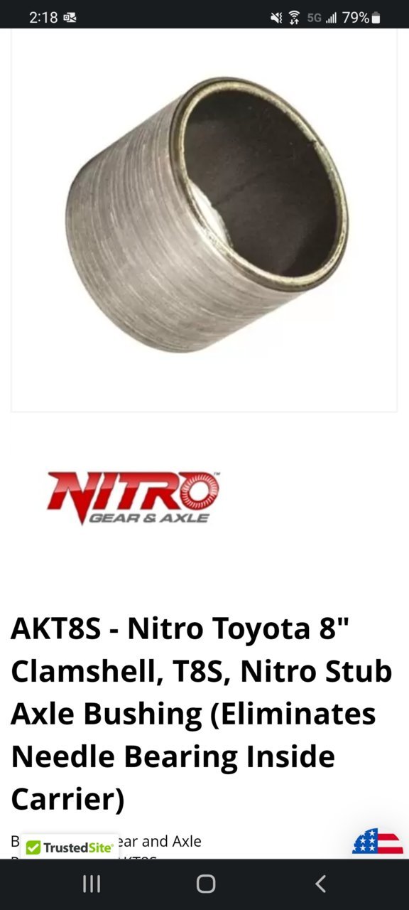

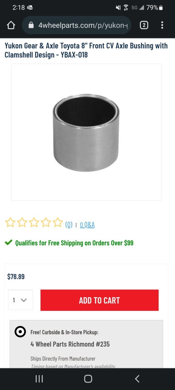

    The bushing is not a unique invention of ECGS. Sintered bushings (PTFE bushings in particular) are used across numerous industries. This is not a unique application.
    Not surprisingly, there are many manufacturers and it's a safe assumption that they're all of similar quality and design. There's really not much to change or screw up.
    I also wouldn't be surprised if these all come out of the same factory.
    While I understand your sentiment, that you've never heard of Yukon, that does not justify warning people not to buy them. There are plenty of members here with the Yukon bushing.

    My point wasn't to prove that Yukon bushings have reviews, which they do, if you seek them out. My point is that there are many manufacturers for this part and it's ridiculous to warn against using them, because YOU have never heard of them.
    Would you avoid buying shoelaces, because they have no reviews? Do you insist on only buying Nike shoelaces?
    Probably not, because it's a ubiquitous part and really doesn't need or deserve a review.
    Let me know when your mind is at ease...
