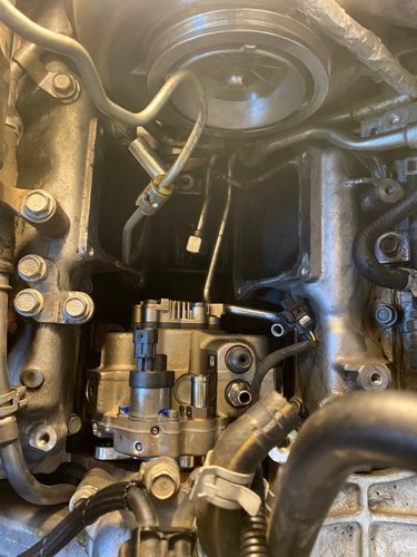

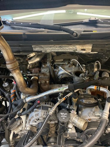

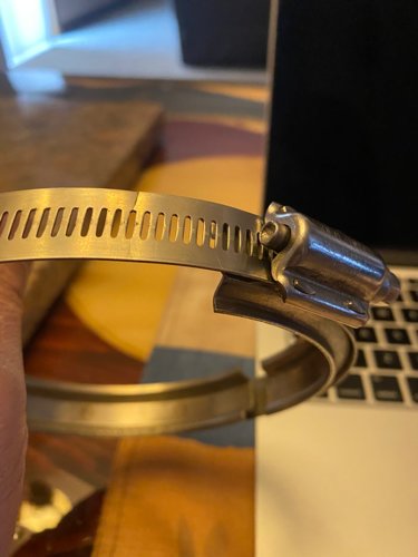

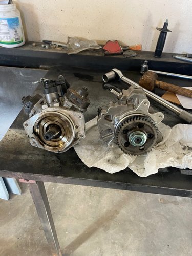

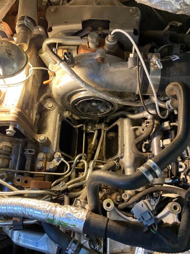

    Hell we have all done it. Get all excited to complete a job, tear it down, and them realize....wrong part.
    I just did this six months ago like a jackass. I was changing out the injection pump on my LML Duramax before it exploded and cost me 12000.00. Had my truck all torn apart, tried doing this job 3 weeks after foot surgery (highly recommend not doing that), and a few parts needed replaced that I couldn't just go to the dealer for (turbo inlet band clamp was cracked/serpentine belt for the dual alternator upgrade). I just laughed:
    -Snow was coming in and needed my truck.
    -Commuter car is a Lexus IS350 rwd.
    When to Discount tire and purchased 1300.00 in snow tires.
    See...it could have been so much worse...and this job is no joke.
    Never thought I would actually say this, but I was literally in a one legged ass kicking contest with myself.

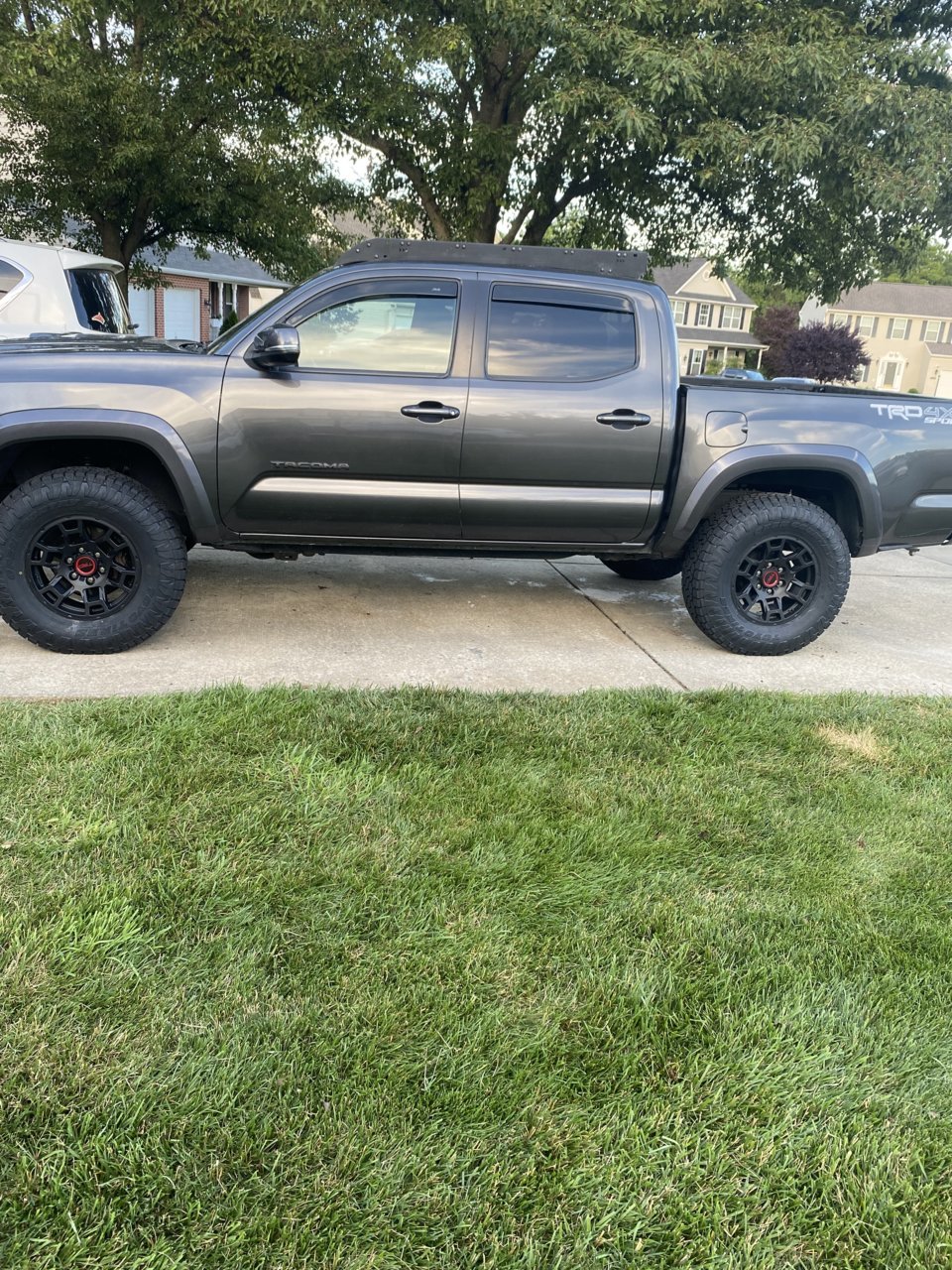

    Here is the end result for all that are wondering. Really happy with it, but it was a pain in the ass. I think it was more than worth it!
