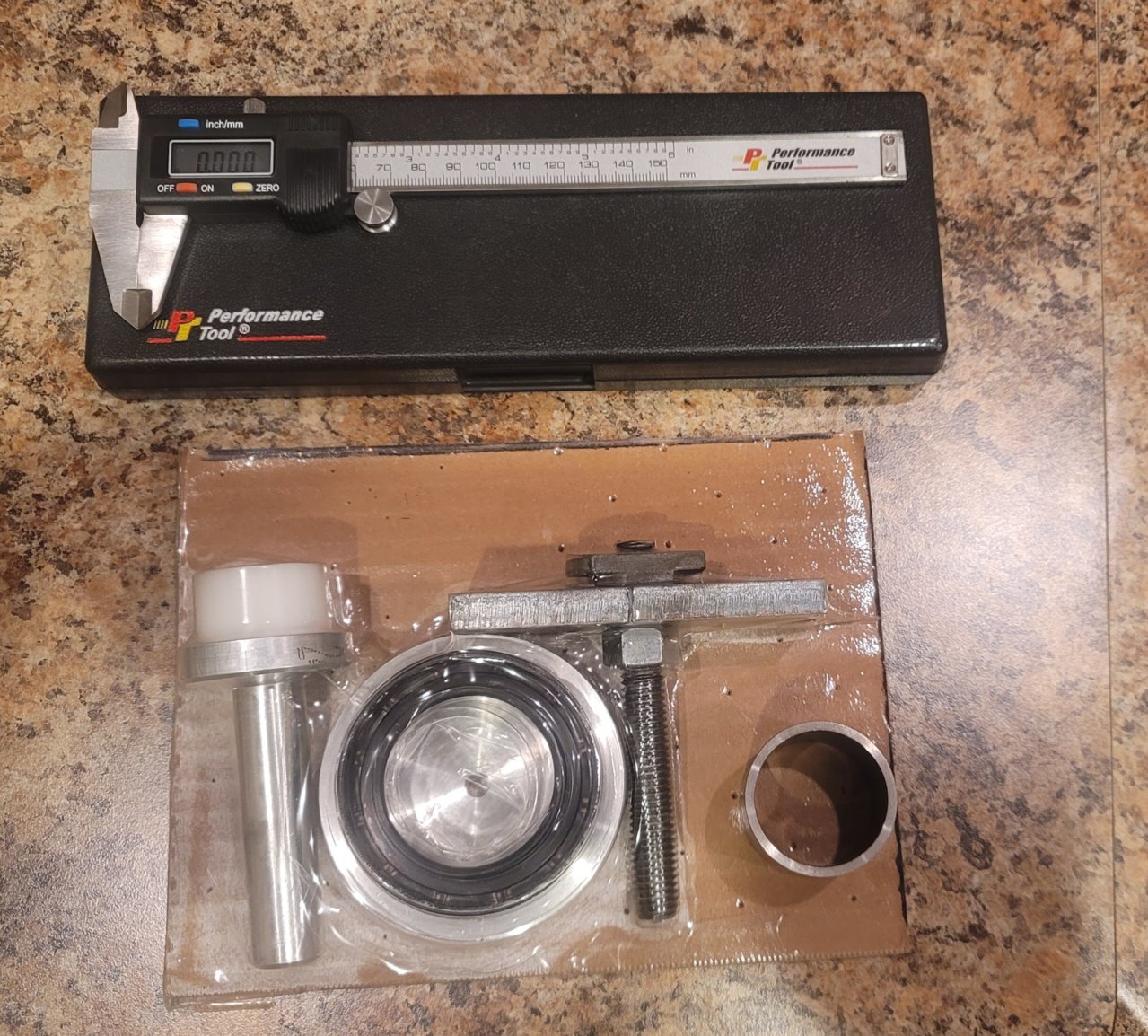

    Got my ECGS kit yesterday & was looking for info before I did mine but found this thread so I figured I'd measure the bushing. I used some calipers that had been calibrated at work for reference
    Length 1.250
    O.D. 1.594
    I.D. 1.378

    That’s some nice packaging . Mine were just loose in a box .

    Yea it's heat shrinked all together nicely. Cost about $190ish shipped as the whole kit but should be worth every penny to have all the tools with it
