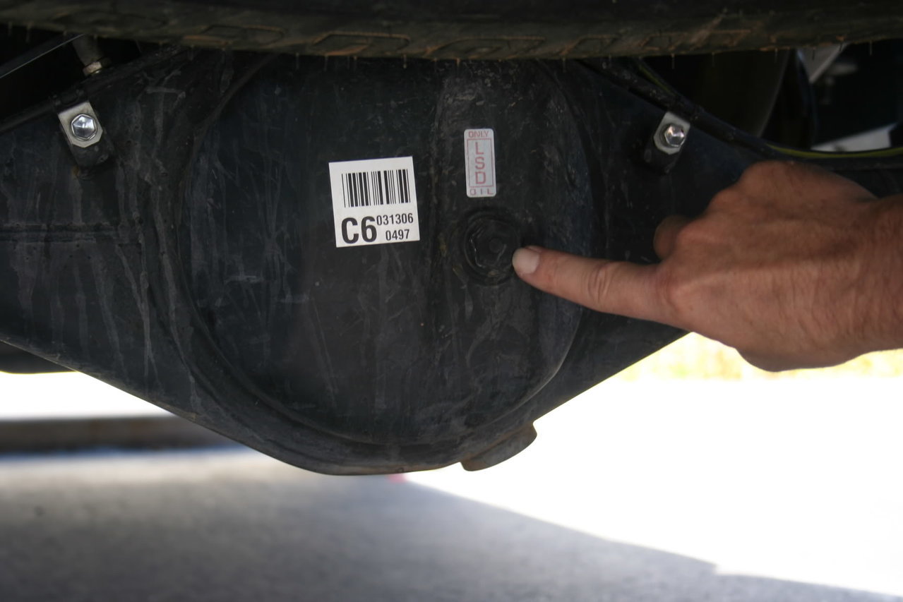

    Some non TRD trucks were in fact equiped with an LS diff. Only way to tel is by checking the rear diff for a sticker like the one in this pic

    just scraped the mud off the rear diff and i do have the LSD oil only sticker, great success!
