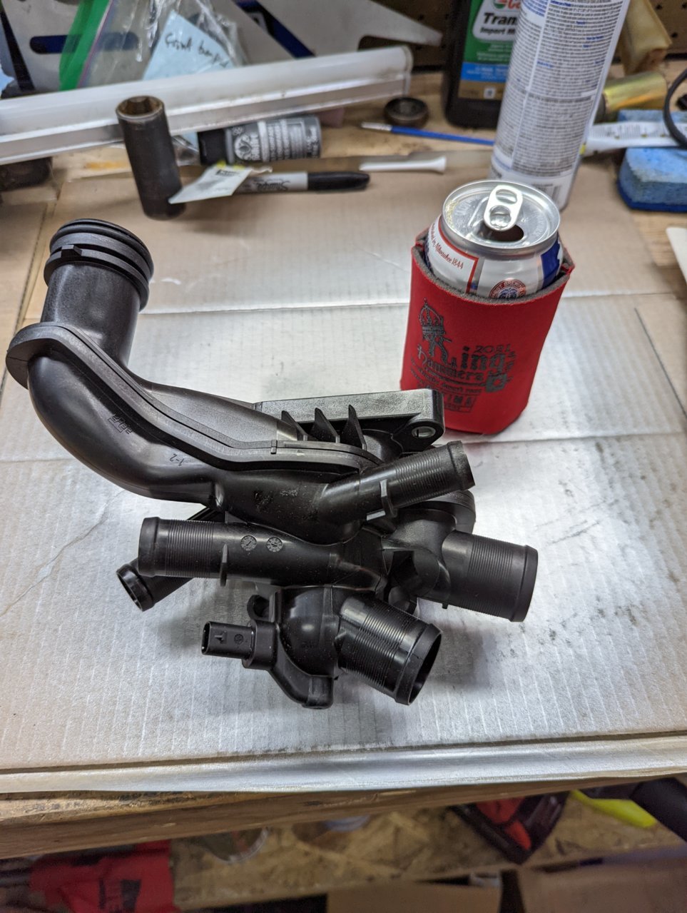

    Just a simple thermostat.

    I mean...it is just those connections....
