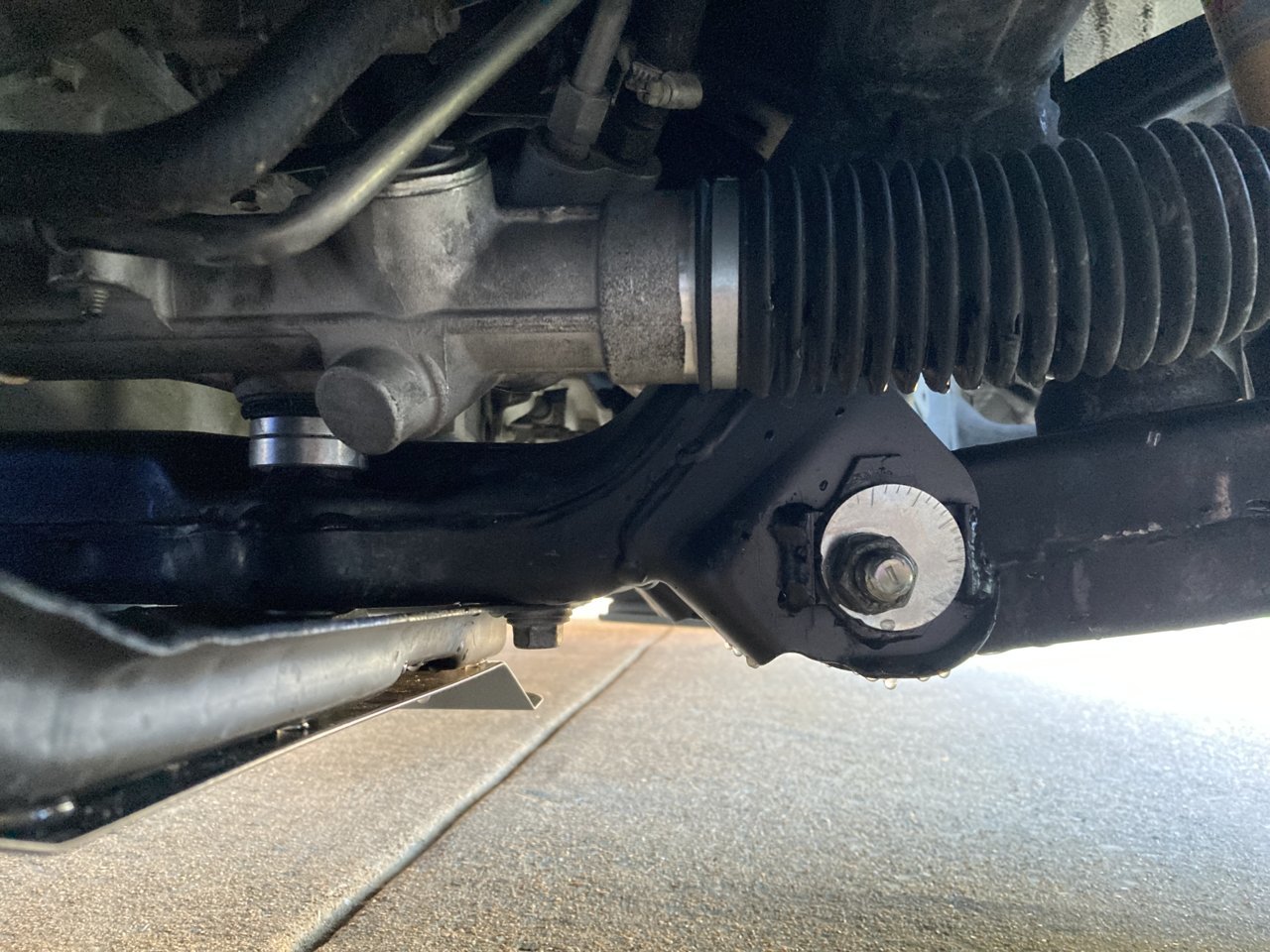

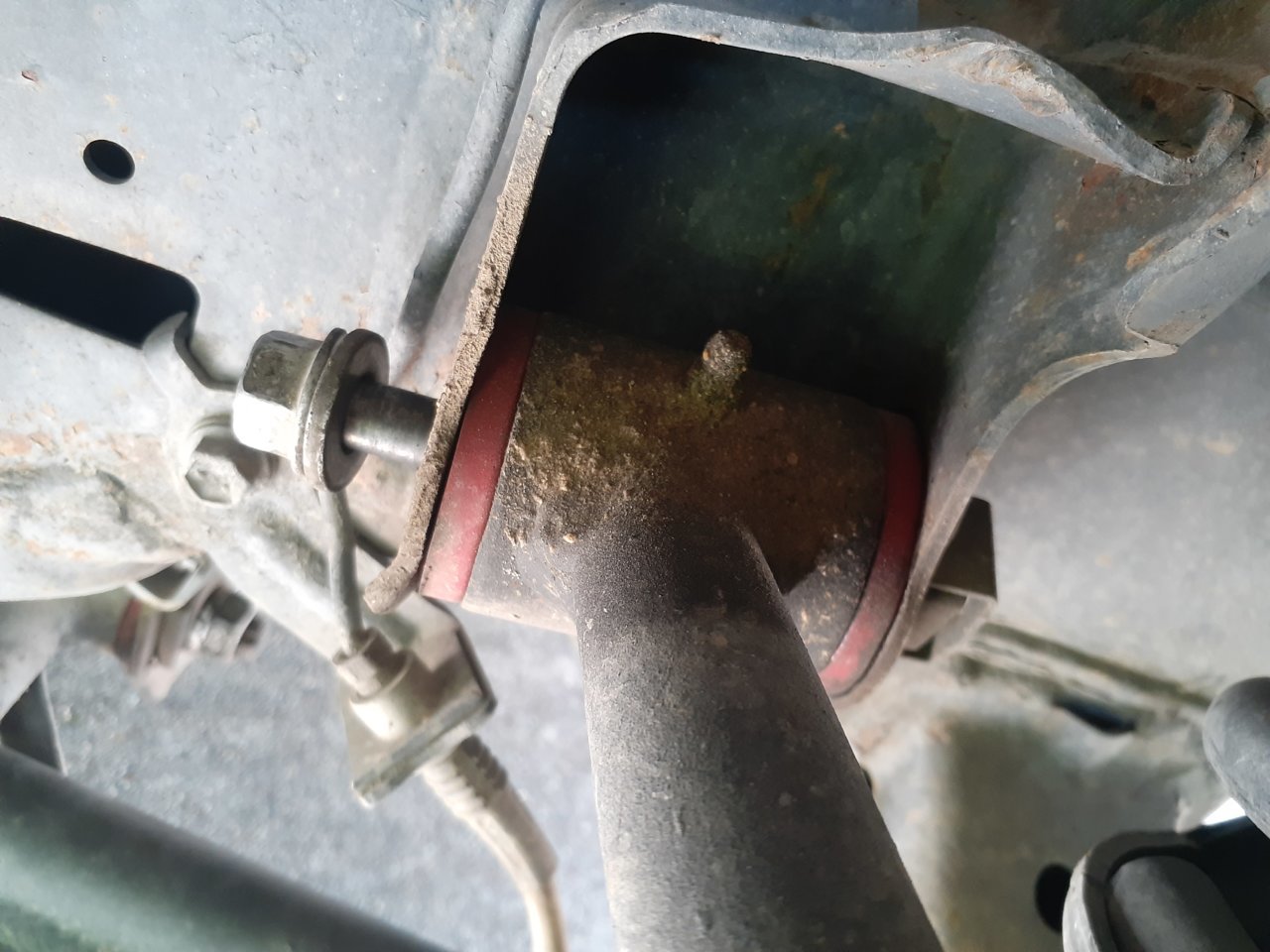

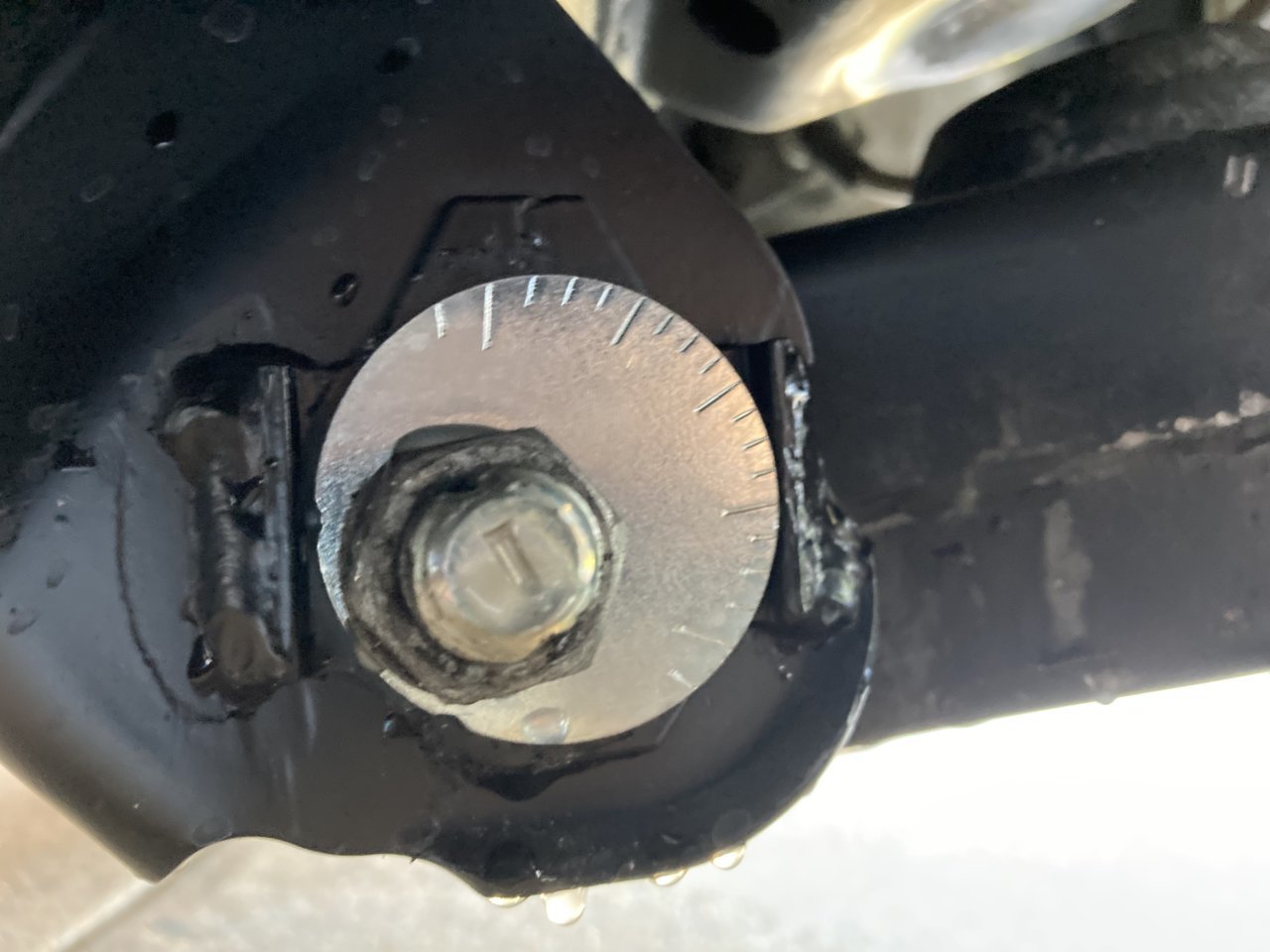

    IMG_0424.jpg IMG_0425.jpg I had a very similar experience with having too much negative camber but mine was only on one side of the truck. I installed SOS performance F-1.5" / R-2" lowering kit and went to get it aligned. They told me that one side way maxed out and they couldn't get rid of the negative camber and that was all they could do. I went thru the front end and tighten everything and basically re-did the lowering install. I took the truck to another alignment shop and was told the same thing. I didn't know what to do... so I just happen to take my truck to a track racing company to talk about other options. They put my truck on the rack and with in seconds knew what my problem was.... the synkro washer of the camber bolt was on top of the tab. There are metal tabs on the left and right of the cam washers to keep them in a certain area.. somehow my tab got bent back and the camber slid and was on top on the tab. I could not believe that the other 2 alignment shops didn't tell me about this, especially since they knew there was too much negative camber only on one side. This track racing company was able to weld my tabs back and make them strong than factory. They also replaced my camber bolts and new synkro washers. Then they did and alignment for me and everything is great and within specs again. There are some pictures of the tabs after they were fixed. I wish I would have taken a picture before it was fixed.

    Sounds like I may need to do something like this forsure. Sucks as I already paid for the lifetime alinment with firestone.

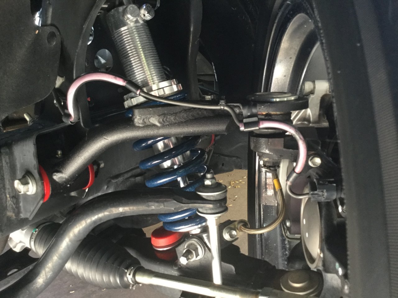

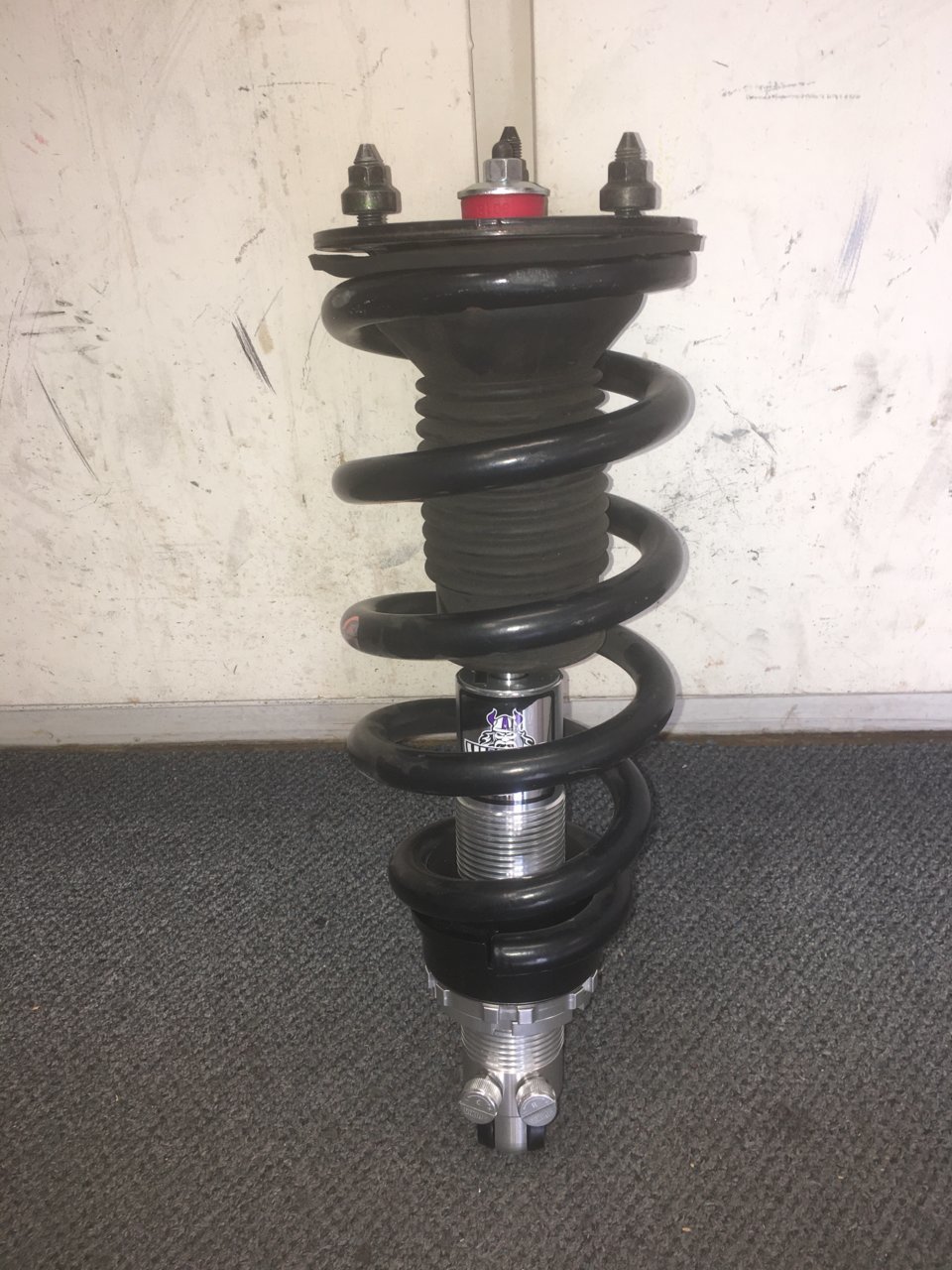

    Install rubber with more sidewall! I have 19” staggered wheels myself.
    But I’m only lowered 2” in the front & 3” rear.
    And for God’s sake please don’t use “Strictly Street” I contacted them 3 times about their upper mounts and the price changed each and every time! I think they price stuff on how they feel that day or what they can rip you off for…
    Plus I’m changing my front springs to used the OE springs like this gentleman did but I had the bottom of the lower SOS spring mount/perch machine to flip the adjustment nut/collar over.
    https://www.tacomaworld.com/threads/height-and-ride-adjustable-front-shocks.717946/

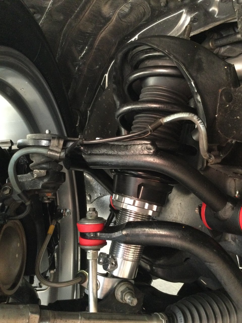

    211DC425-632F-4BDC-8D70-F2C71D5E26EE.jpg DED294DC-2169-46C3-826A-A8A62BA3EA39.jpg
