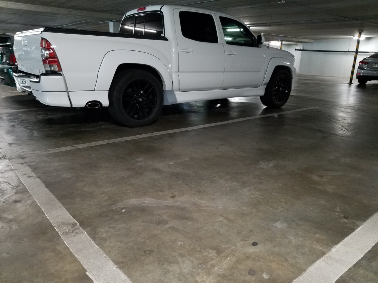

    front lip of Tacoma X-Runner 12 to 14 adapted to x-runner 05-11

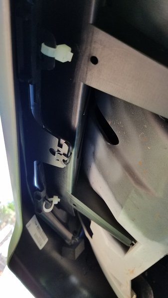

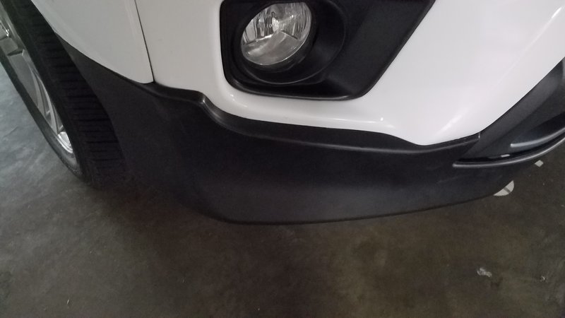

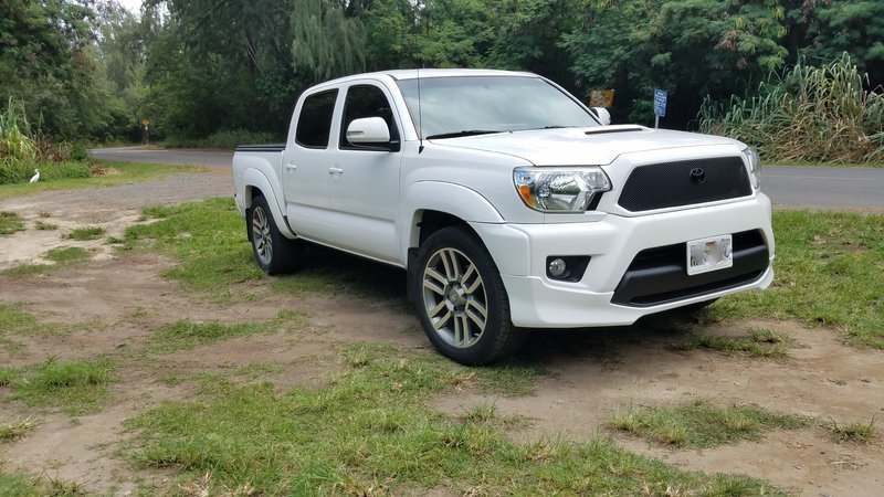

    Picked up spoiler and lower grill from rockauto for my 2010 prerunner . (lowered tundra racing kit ) Did 12 up conversion about a couple years ago . Had to cut bumper extension other wise would have had a big gap. Going clean up extension than paint spoiler on my next vacation. For prerunner needed to make holes for spoilers (12 all together) Solder gun sliced through bumper no problem.
    Painted spoiler .Need to repaint one
    Repainted

    Don't know about tires you want to use but theres threads on here on fitment on different tires . But I can say that the 4runner lips sits about an inch or less behind stock flair. See if I can take a pic latter.
    As for skid plate definetly wont fit . I don't have factory skid plate but has metal panel covering bottom side of engine.
    From what I seen on here 33s will give you rubbing issues but like I said skid plate wont work and lips its about an inch behind stock flair .

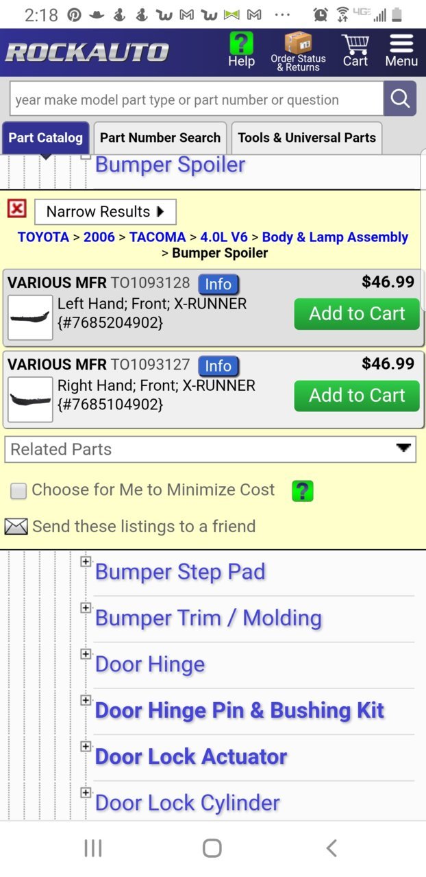

    Can someone provide the part number(s)? Having a tough time finding it. Thanks!

    Forgot part #s but picked mine up from rockauto. Look under xrunner . Xrunner lower, grill left and right spoiler
