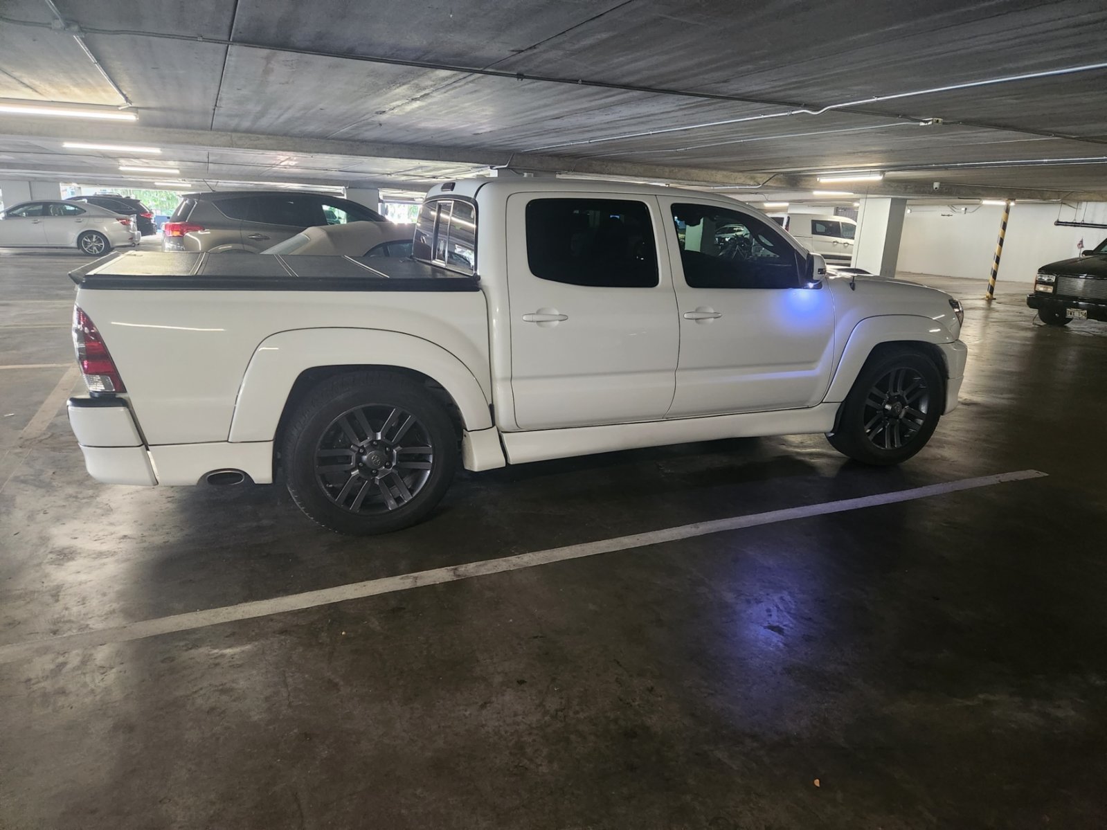

    Picked up 4runner replicas . Specs on invoice . Couple years ago I put 285 x 50 x20s . Minimum rubbing on wheel linners on dips in road at speed but since heated and clearanced and no problem since . In rear with the 285x50x20s very slight rub on big dips on road above 35mph depending how big a dip in road . No damage though. With the 265 x50 x 20s had no rubbing .
    This pic is the 4runner replicas with 265x50x20 with the xrunner spoilers . This setup no rubbing . Mines lowered with the SOS kit but added coilovers in front so about 1/2 in lowere in front which was reason for slight rubbing with the 285s .

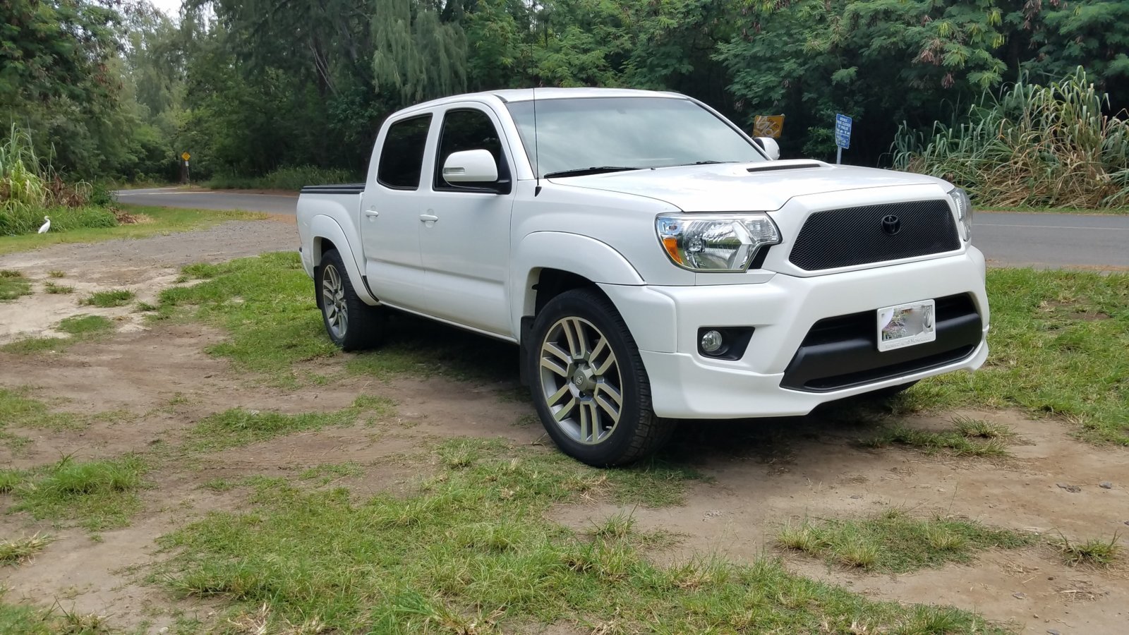

    Forgot to post the wheel specs. Also diff between to sizes
    with 285 x 50 x 20
