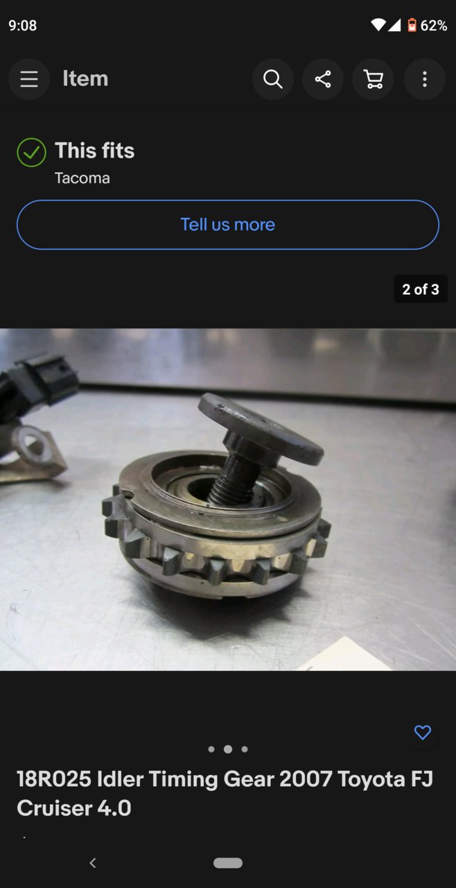

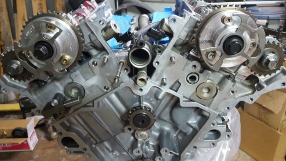

    Went searching through my old photos, then you found that. Well done. :thumbsup:

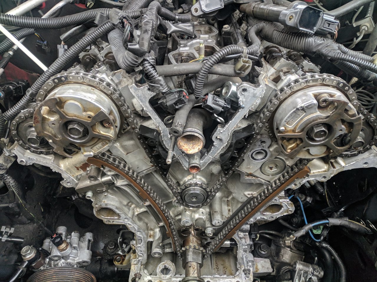

    Not sure how I overlooked this (maybe because the new hole was drilled & tapped pretty darn well?) but it appears not only is the idler busted, but it appears the PO broke off the top tensioner bolt, then drilled a hole nearby instead. Definite concerns about timing jumping now as the tensioner was pretty much at it's limit. Damn.

    The previous owner took the time to drill and tap a NEW hole.
    That’s like mak8ng it worse, before you even try to make it better?
    I’d at least tried to get the broken bolt out.
    I would have tried to find a bushing, put it into the tensioner bolt hole, and make a “guide” for the drill bit.

    Looks like a dremel disk was taken to the bolt hole to maybe get a flat head on it, which also ground into the head too. And then gobs of RTV to seal the mess/tensioner to the head. I'm going to throw some heat into it and try a flathead, otherwise try the bushing method above to drill and tap or do something similar to how distributors are held into engine blocks as a last resort...

    Looks like the guy drilled a hole for a 6x1.0 to brace the top side of the tensioner. It may have backed out or was never installed and they just got out of there
    Ugh, what a can of worms
