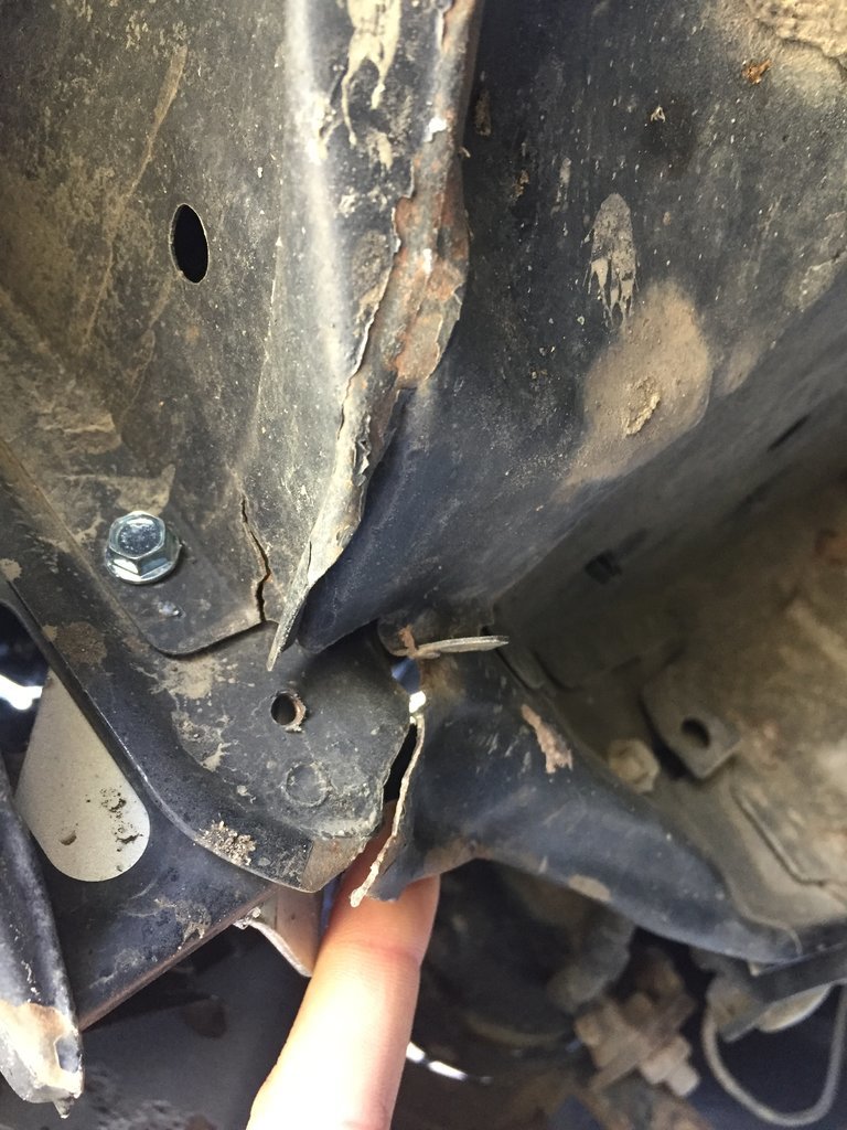

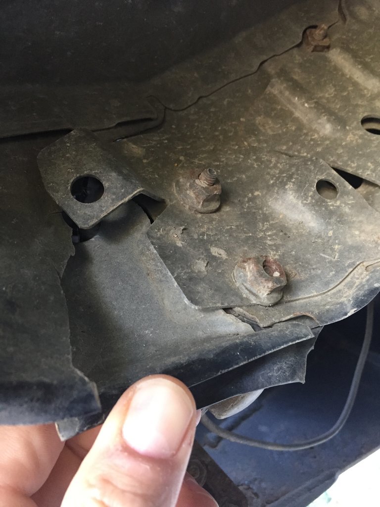

    Any of you group 31 guys having issues with the inner fender cracking? Below my group 31 odyssey battery and behind my headlight the inner fender is cracking to shit. I'm thinking it's the weight of the battery. I don't have it in a battery cage, just the oem battery hold down. I'm wondering if the pelfreybilt cage somehow places the weight differently and prevents this from happening

    Do you have any photos of the damage?

    I'll try to grab some later.
    It seems like a common issue, I've found people talking about it in other threads and relocating the battery to the bed. I'd just rather keep it in the engine bay if possible.
    Pretty much behind the headlight

    No problem. Another local guy has very similar cracks and he’s using a pelfreybilt battery cage

    After reviewing your photos I inspected my truck very carefully and couldn't find any cracks. I have my battery cage torqued down pretty tight and generally check it every oil change.
    Thanks for the heads up though. It's something to keep an eye on.
    I wonder if @Pelfreybilt could chime in with any long term experience or insight into this issue?

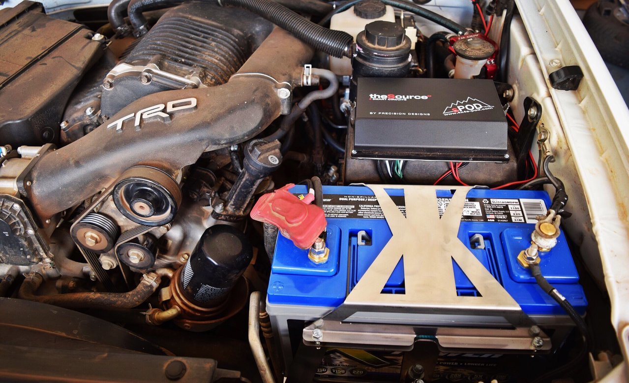

    All of them
    Yes sir!

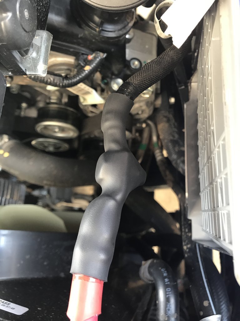

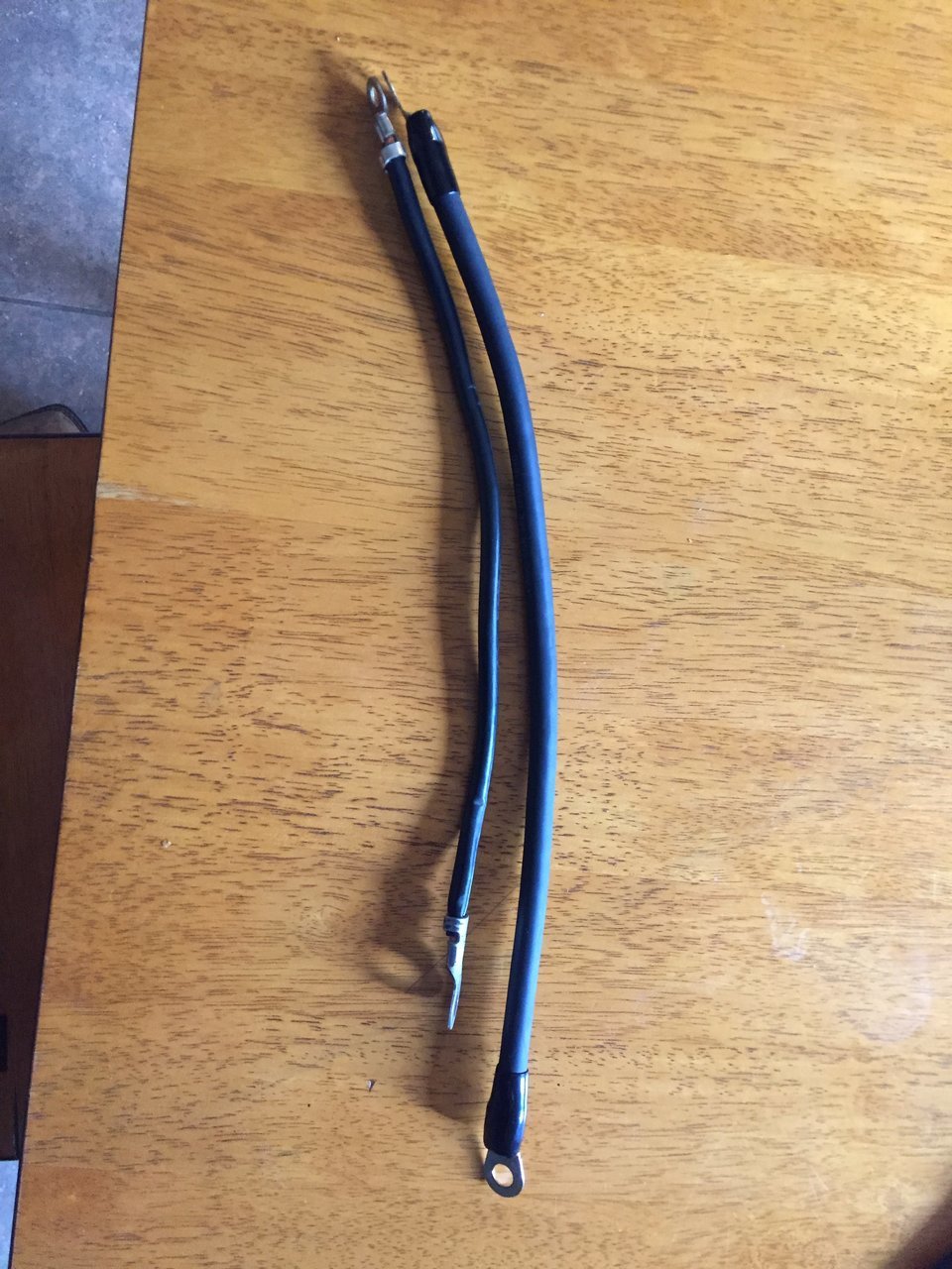

    How much longer did you need it to be? What size gauge? Im about to order my cage and 31 battery

    I ordered it 16 inches and it’s 2 gauge wire
