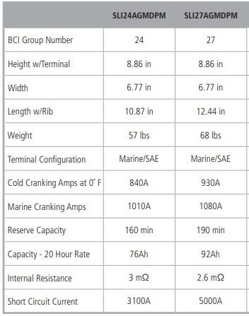

    Bit of a thread revival here, but I went ahead and just pulled the trigger on a Group 27M X2Power SLI27AGMDPM battery from Batteries+Bulbs after reading this thread. When comparing the Group 27M's 92AH capacity with the Group 31M's 103AH capacity, I figure the 10% increase in deep cycle capacity wasn't worth the extra cost of the custom bracket, which now can't be purchased anymore since Pelfreybilt is no more :(. Slee offroad looks like the only place that makes a 31M bracket for a 2nd gen Tacoma.
    The 27M still has plenty of cold cranking amps at 930A, when the factory spec for cold climates is 710.
    Curiously, they also offer the SLI27FAGMDP, which is a Group 27F battery that is an OEM direct fit for the Tacoma, marketed as a starting battery, but also is described as a dual purpose starting/deep cycle battery. It appears to have the same dimensions (although BCI dimensions actually specify the 27F is a tad shorter than the 27M), is $20 cheaper at $360, has a 60mo warranty vs 48mo, and has an identical 92AH capacity. I'm guessing that, with all other things equal between the two, there may not be any real difference in battery chemistry between the two, and the M just has extra screw posts to make it a marine battery for the extra $20 cost difference. And now that I see that there is a $30 rebate on the F, I think I'm gonna go ahead and cancel my order and get the exact fit replacement. Wow, I kind of did a 180 here with this post...

    What’s the reserve capacity of the 2 you mentioned? I know one is 195RC.
    ETA:
    They’re both 195RC. The 27M has double posts, the positive on the opposite side and 150 more CCA’s than the 27F.

    The 150A difference is between Marine Cranking Amps and Cold Cranking Amps. Cold Cranking Amps are the same between the two. Besides extra/flopped terminals, everything else looks totally identical.
    They're taking 20% off online orders for truck batteries this month, and have a $30 mail in rebate for the 27F, so in comparing the Group 31M + Slee Offroad bracket, I'm getting 10% less capacity, but at 50% less cost.
