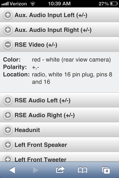

    Thanks War horse....any idea on the back up camera? Most of these HU's have an RCA composit input, but i guess without tearing out the stock unit, I don't know if the stock uses RCA>...

    if you are ok with saudering you can cut an rca strip back and sauder to these wires for the factory backup camera! I will be doing this, this weekend and let you know how it goes!
