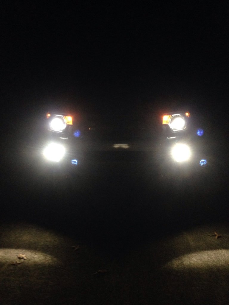

    I just installed these on my '13. Super easy install thanks to the OP.
    Now I don't have to be ashamed of my yellowy fogs compared to my Retrofit headlights.
    I also did the fogs on anytime mod.
    Pics coming from my phone in a minute.
    ChadsPride likes this.
  5. Dec 31, 2014 at 4:09 PM
    #25
    DolphinJohn
    DolphinJohn Well-Known Member
    Aug 2, 2012
    #83954
    351
    Nature Coast, FL
    '13 Access Cab 4x4 SR5

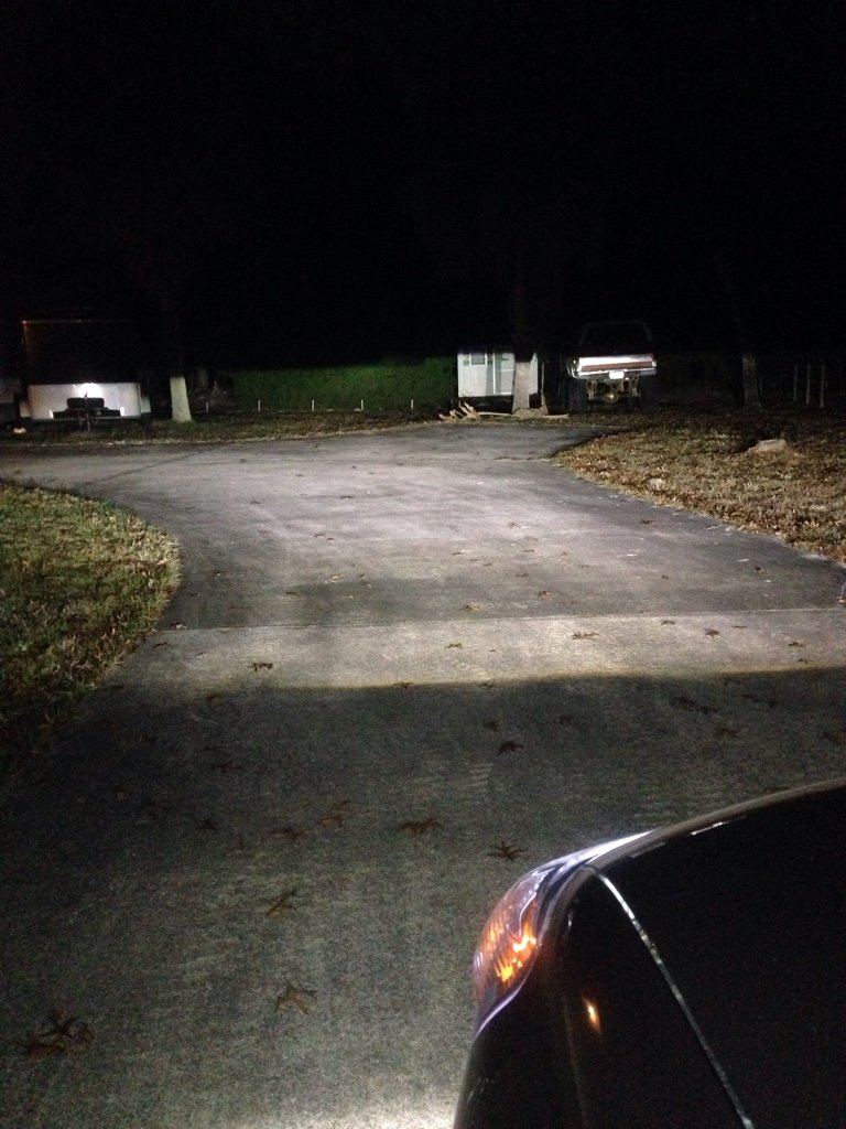

    The flash on my phone causes you to see the LEDs, when you look at the lights you don't see them, they just look like clear glass.
    Retrofit headlights and fogs on
    Fogs only (my driveway has a very slight incline towards the door)

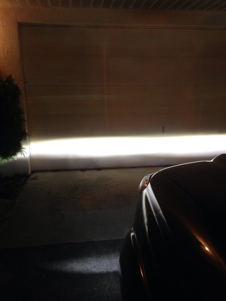

    Don't want to mess up your write up thread but do you think I need to adjust the fog's? Should they be up higher? Thanks in advance.

    Honestly, I almost never see my headlights against a wall like that, so I wouldn't be able to judge if that is what mine look like. You can always try it on your own vehicle and see if you like them adjusted up or not. Just a simple screw turn. Sorry, not so helpful on that part. Haha

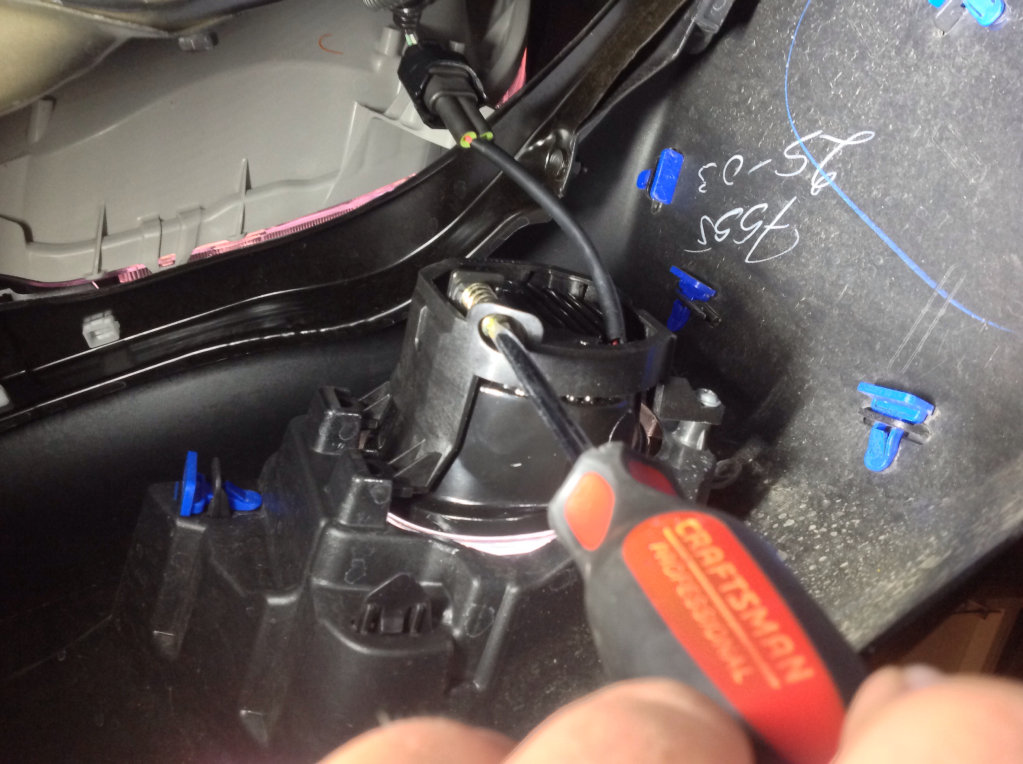

    No worries. Do you know how they adjust? Just up and down or can they be adjusted left to right as well? Also, which direction on the screw goes which way? I.e clockwise makes them go up or down? I have noticed that a lot of my light is pushing to the left and right of the truck and not so much out front. Not sure if thats how they(fog lights in general) are supposed to project light or not.

    They should only adjust up and down. To bring the light up (the light that you see against a wall), turn the screw clockwise, down would be counter clockwise. Fog lights aren't meant to be overly bright, but you should be getting a pretty equal spread from the front out to the sides. But yes, you will get more light off to the sides with these compared to your OE fog lights.

    This is the screw. It's a...brass looking guy.

    I'm tracking on where the screw is to make the adjustments. My question is which direction on the screw makes the fogs go what direction...? and if there is a horizontal adjustment or just vertical...
