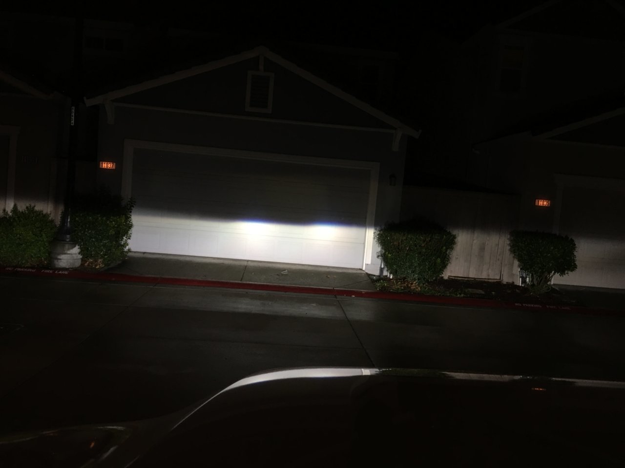

    Ok I have a problem I noticed after a few days. I have the xenon depot 4300k philips hids. The passeneger side hid light doesnt come on sometimes. To get it to turn on when it doesnt wanna light up, I have to keep turning the lights off and on again until the passenger side fires up. Does anybody know if i did something wrong? Most of the time they both turn on fine. Heres a pic of when i started up my truck to drive to the store and the passenger side light didnt turn on.

    Seems like a bad ballast. I had crappy eBay lights that one did this. Switched them and the other side was having the problem. Try that to make sure

    Sorry to hear you are experiencing an issue with your Xtreme HID kit but I can further help you out. Since passenger side is not always coming on it's most likely a connection issue since with HID bulbs and ballast they either work or don't.
    Can you send me a PM with your order info and I'll help you troubleshoot the issue.

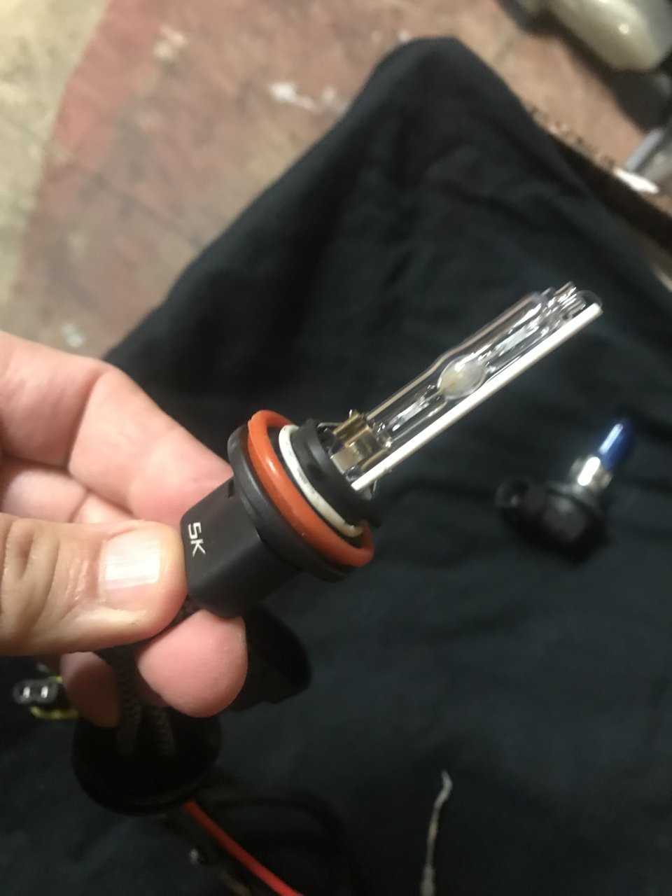

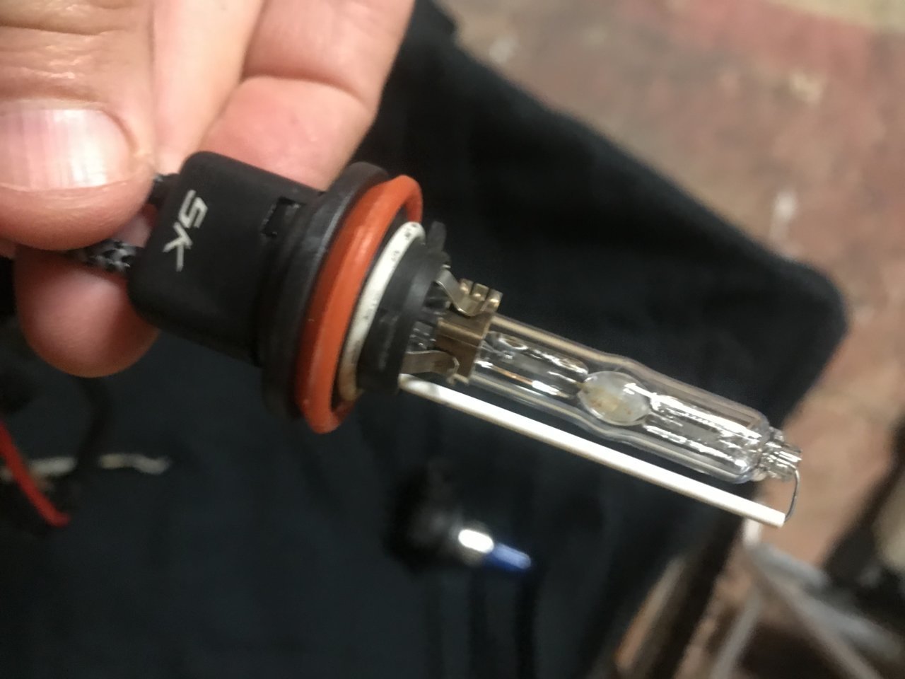

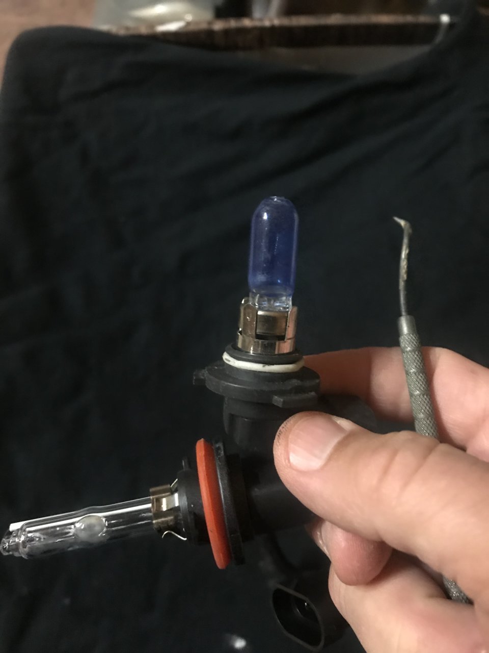

    I THINK that this did actually work. I bought one 9005 light and used the o-ring from it. Put it in the truck..drove around (with my other headlight still being LED) and I didn't notice any shake...so I went down and bought another bulb, put it in on the other HID and in the process of trying to tighten it down in my headlight the bulb clips actually snapped off..rip. I do wanna say that it did significantly help or get rid of the shake. Sadly I will never know now.
