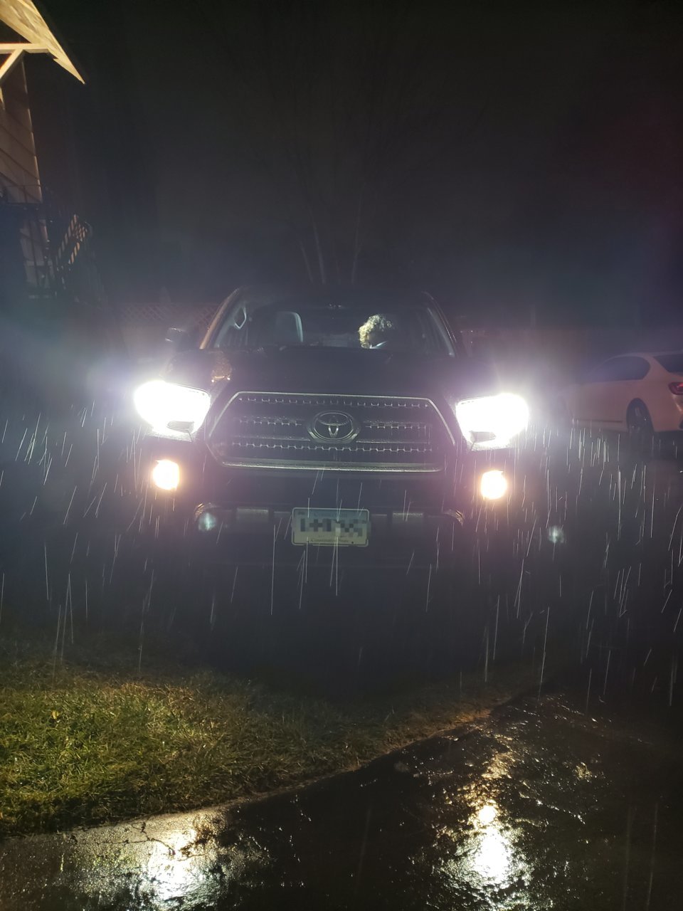

    Installed my @XenonDepot Phillips 4300k HID kit, I've read about what a difference it is on TW but you don't appreciate it until you compare, holy cow!

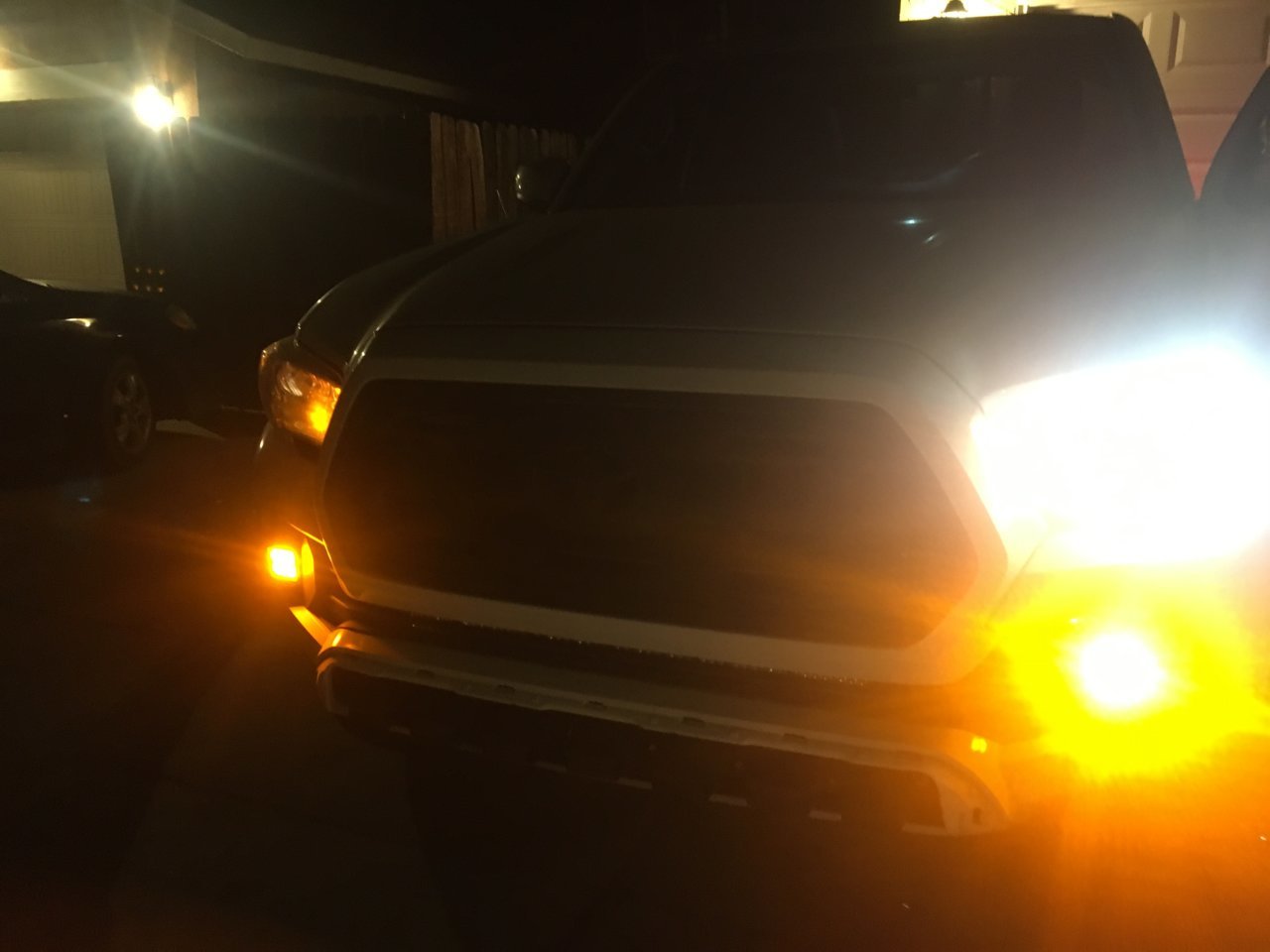

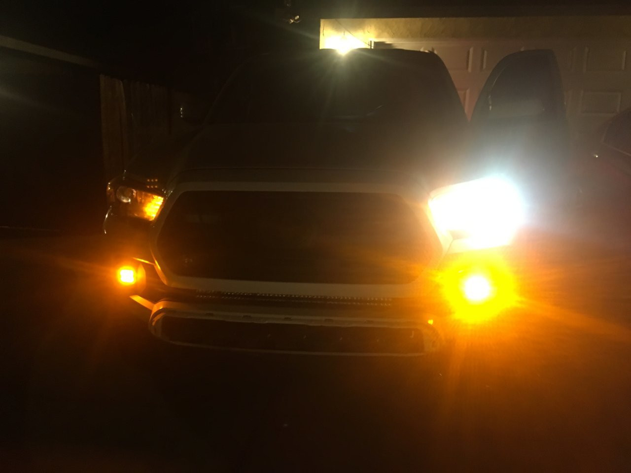

    i installed my 5000k HID kit the other day.. my driver and passenger lights seem to be a diff color... the driver side is noticeably more white than the passenger side. when i am driving behind a vehicle and see my light reflection, its super noticable. anyone else have this issue?

    Thank you for the informative feedback and the pictures you provided. So it seems like the issue is not isolated to the rebased Philips HID bulbs as you also had a slight issue with the 5000K bulbs as well. Having said that, looking forward to hearing what happens with the Civic as to my knowledge we haven't had reports of this issue.
