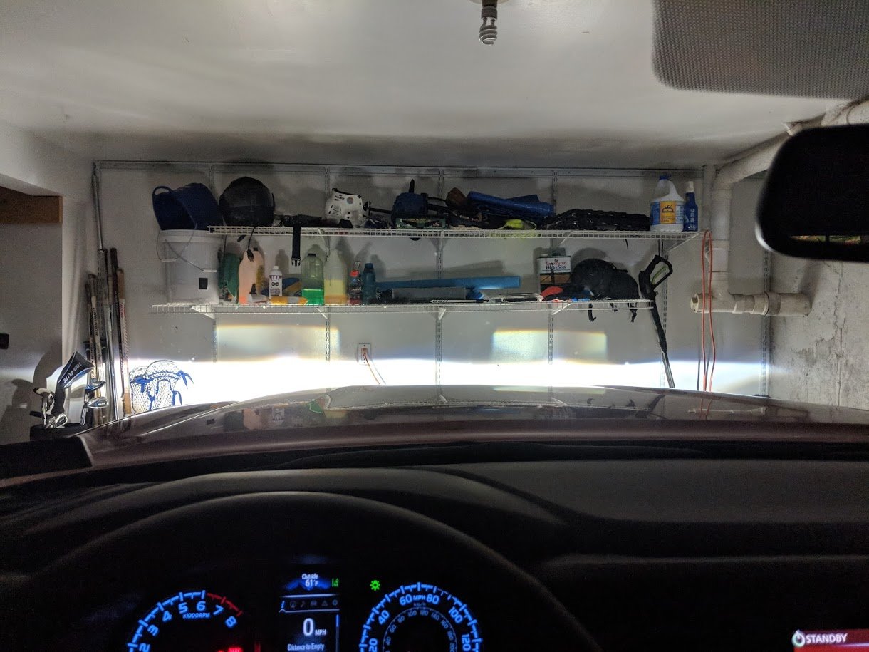

    @XenonDepot got my lights in but for some reason my driver side will not work. I've checked my ground points and connections. What else do I need to try?

    If you used the relay you can bypass it and just do a direct connection, that's what i did. After that just start swapping bulbs then ballast with other side and do a process of elimination. Basic trouble shooting!

    That fixed it, by passed the relay harness and it fired right up.
    big fan of these so far. now just need it to get dark so i can test em out.IIphx8z8XghSIl2wdz6Hi7_MthxKG4fdndKml90z_aa613ef4387e965339536c0ecbbd6b644686a94a.jpg
