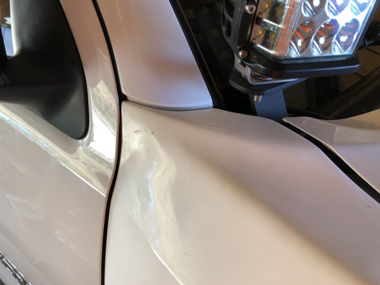

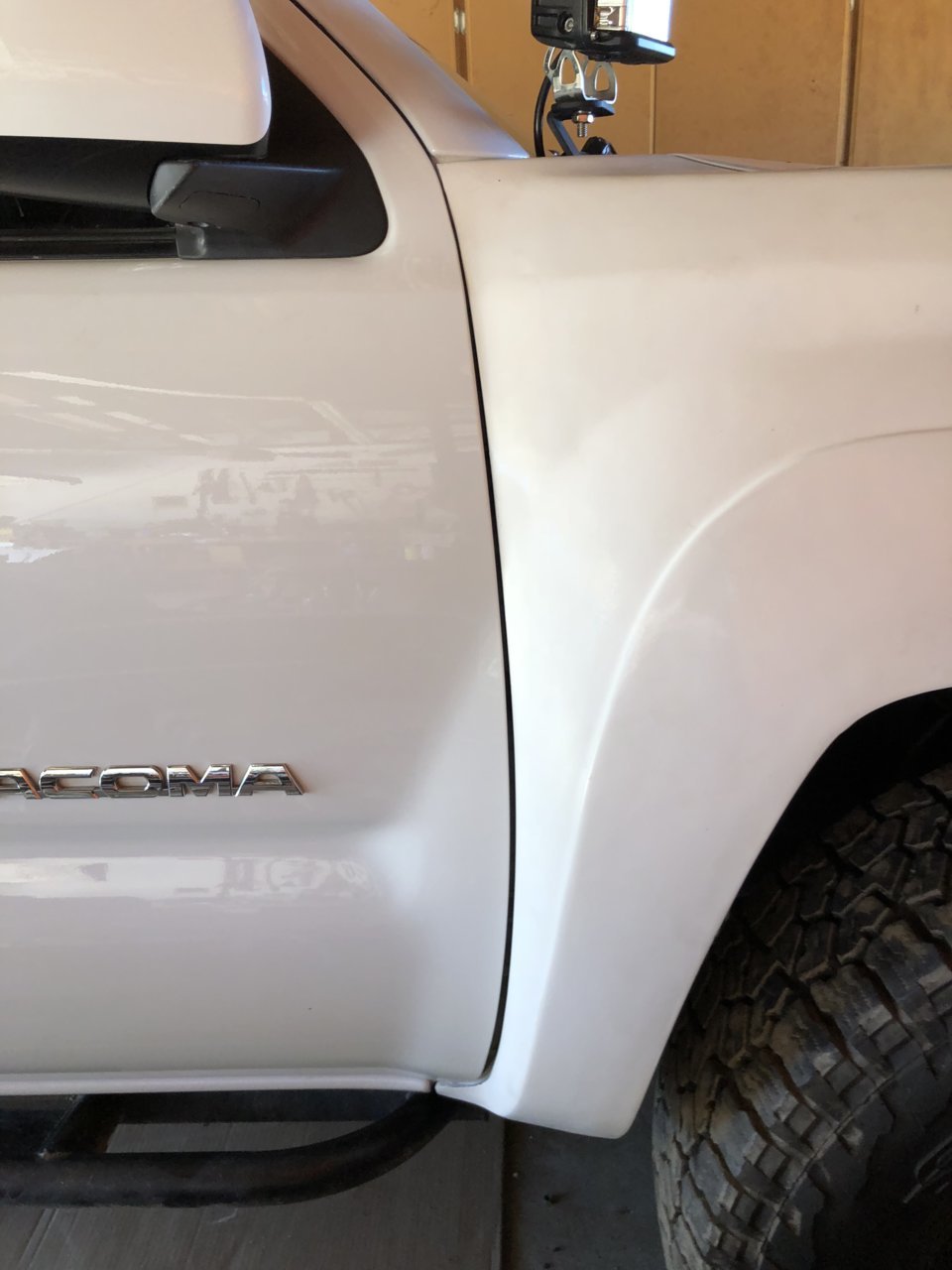

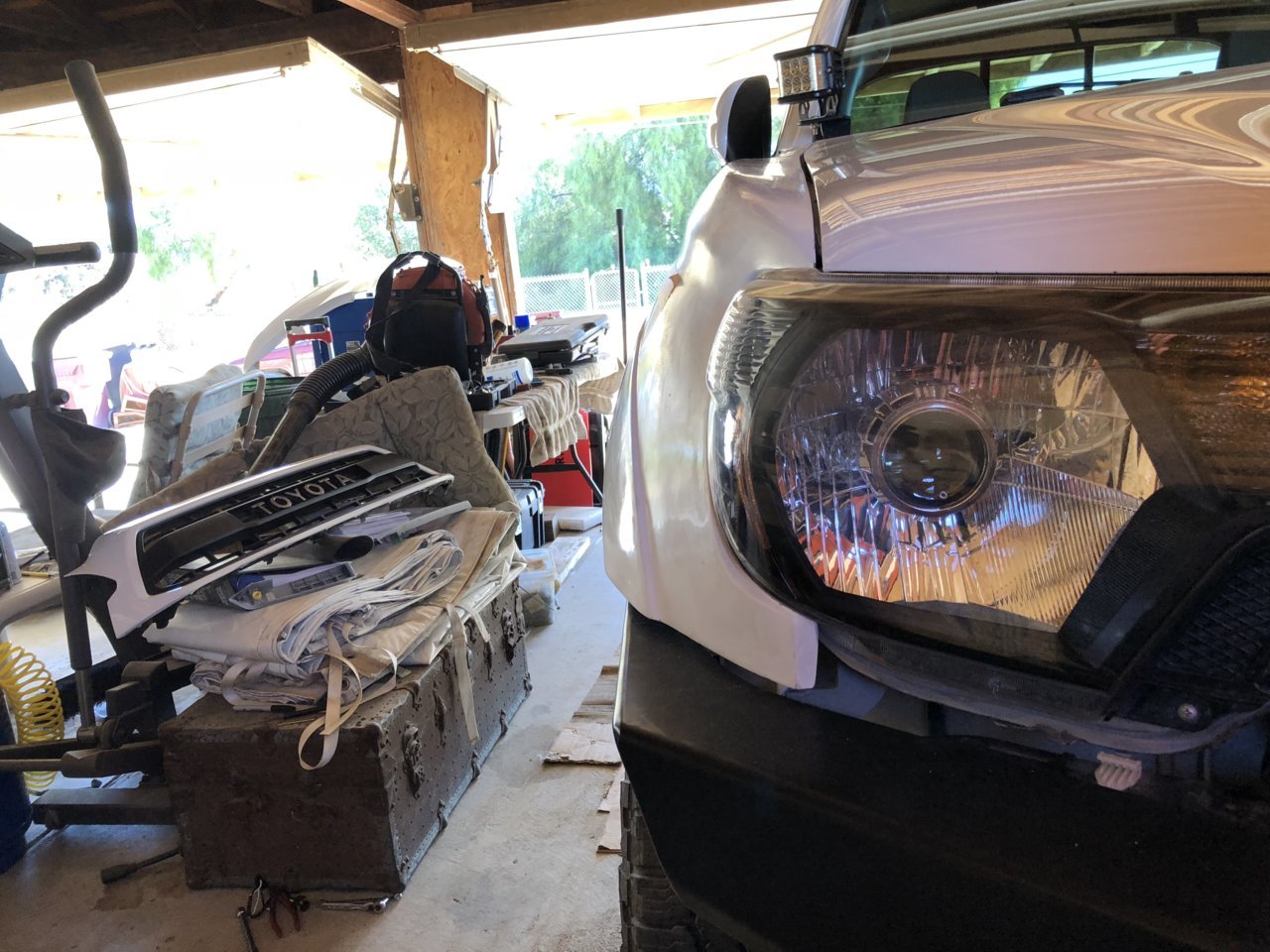

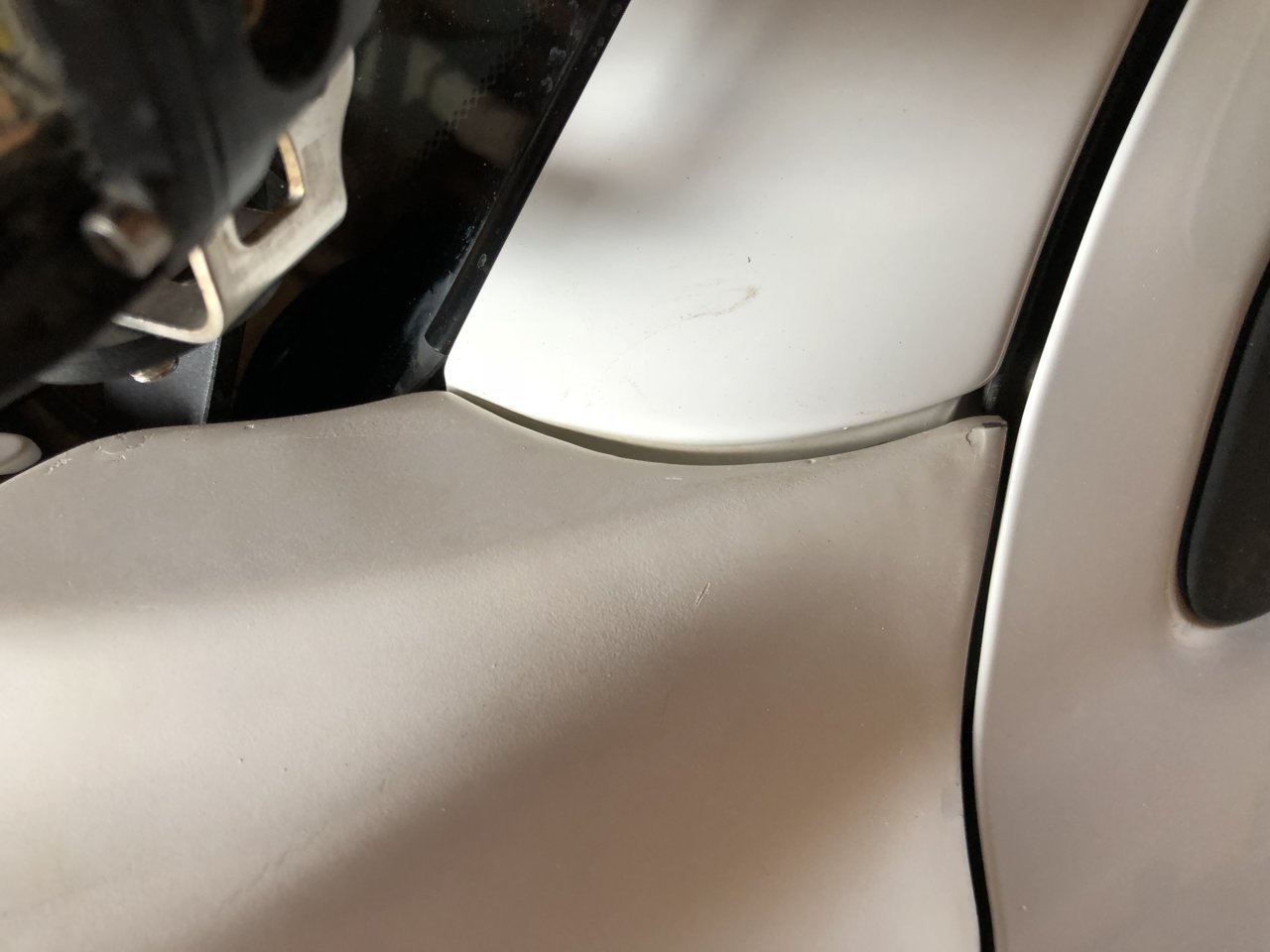

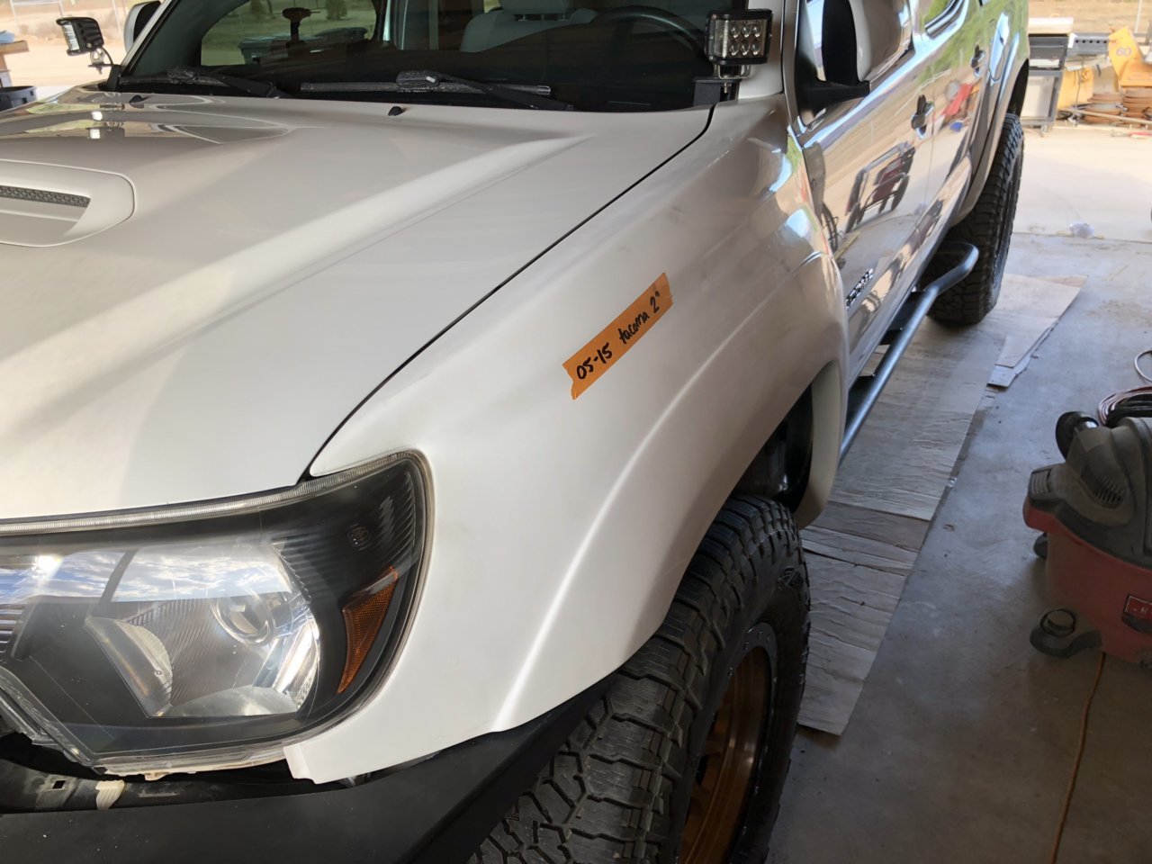

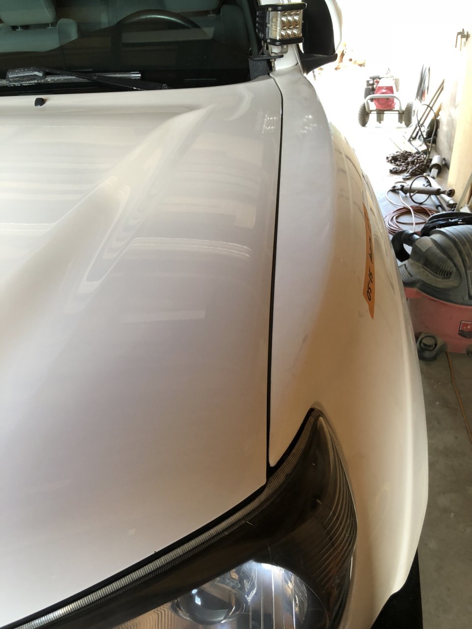

    390CAD4A-4872-4AF5-80DC-97AF4078E579.jpg 2FEE0AC0-20E7-4B25-B410-6F9DD47C52BD.jpg 7D99943B-18F7-41BC-879A-61EACB411EBD.jpg BBA454D8-6180-411A-ADC7-124B665B8293.jpg BC4B78B6-A162-4DE8-96AE-F2EEF143E576.jpg 8153899F-5B97-4198-A046-1A4021DF0AF0.jpg 22D255BE-E811-4D6F-A4A2-A72FDAE498AA.jpg 96B6B46A-54F0-4D0A-AF4F-3D9564BB75EA.jpg
    Here is my progress on installing my front fiberglass. The drivers side was my first time installing glass, I probably could have got it better, but again it was my first try. I am accepting that they are not going to be perfect. This is all the work I am going to put into it for this weekend, they are about 90% there. I have a few more things to button up. But for now I am bolting up the stock fenders so I can still drive the truck.

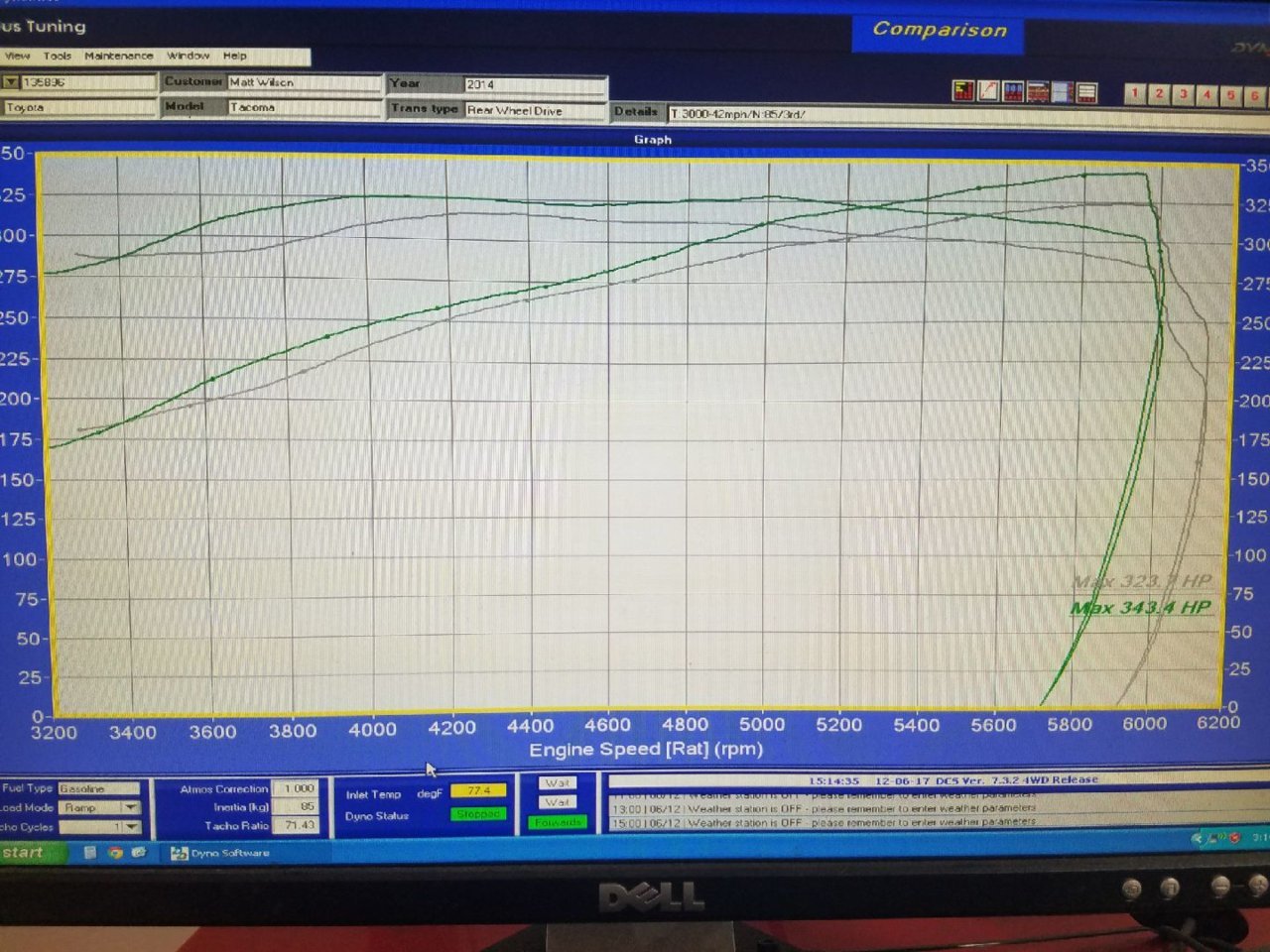

    saw your post regarding your dyno tune. I have a slightly different setup (smaller pulley, long tubes, etc) but curious what #'s you were putting down. just looking to get an idea of where I would be at. wanting to snag that v2 handheld ASAP.

    Good to see it over 300. That was my main concern .lol
