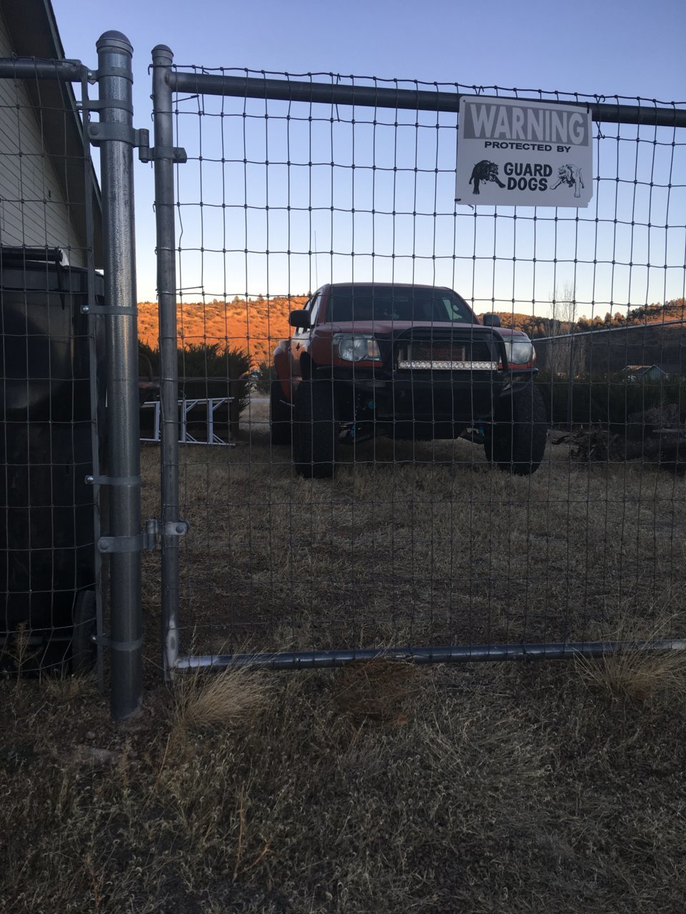

    Maintenance is a snowball lol. Abused the truck for the last year, then ended up spending around $600 on maintenance before my dunes trip a few weeks ago.
    Got to do this
    Then bought the dd
    So I could do this
    The beast has been locked up until needed again

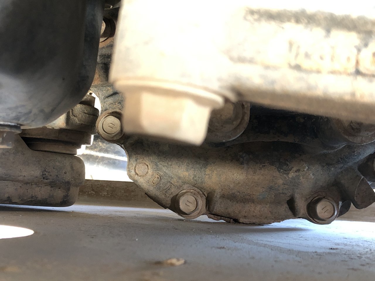

    While I am doing my maintenance today I have confirmed the front skid plate was making the popping noise

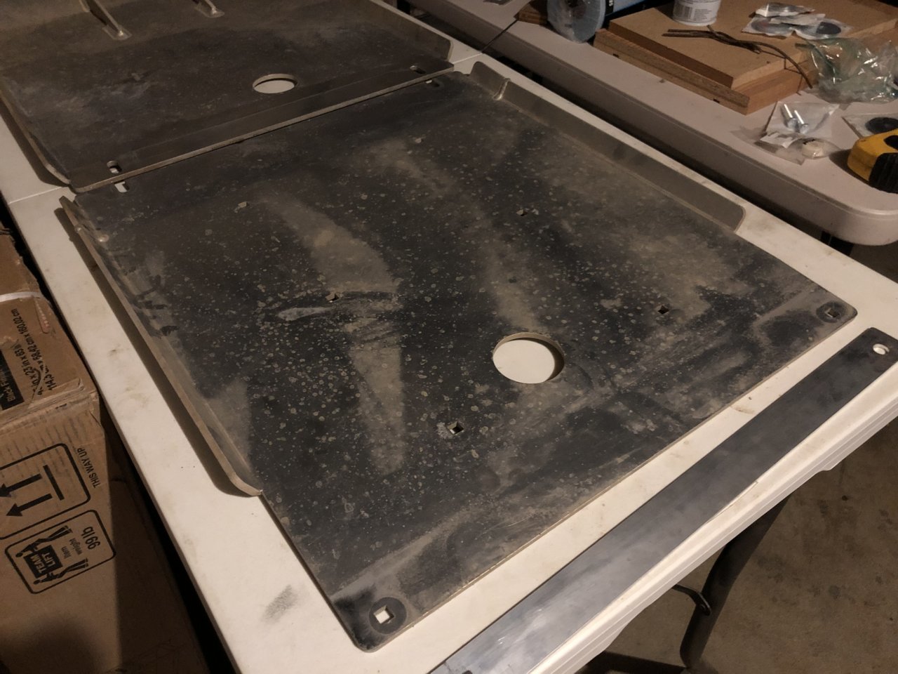

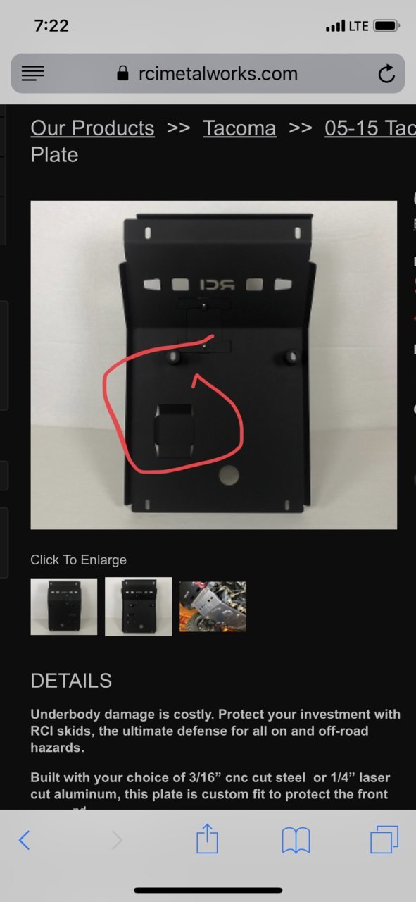

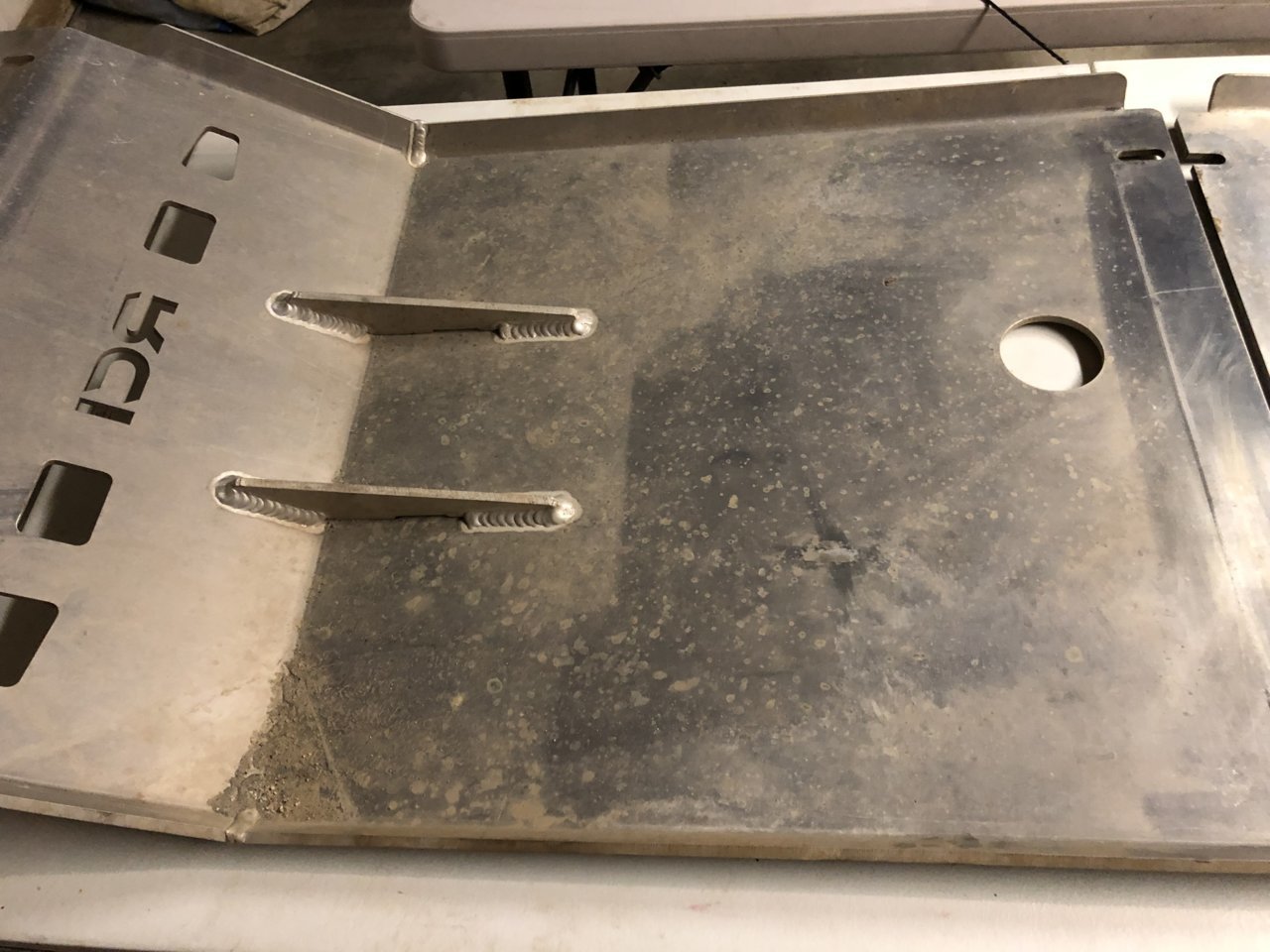

    Overthis last weekend I modified my skidplates to prevent the front diff from contacting, and also noticed my ypipe burned a good spot into the trans skid plate, so I spaced it down more.
    As you can see my skid vs the skids rci sells now, it seems this is issue has been remedied.
    Here is a pic from where the ypipe was hitting the skid
    You can see one of the flat bars I made to use as a spacer. Still added some washers everywhere, but made two of those bars one for the very front of the ifs skid and one for the back of the trans skid. I used 2 washers and longer bolts for the center connection.

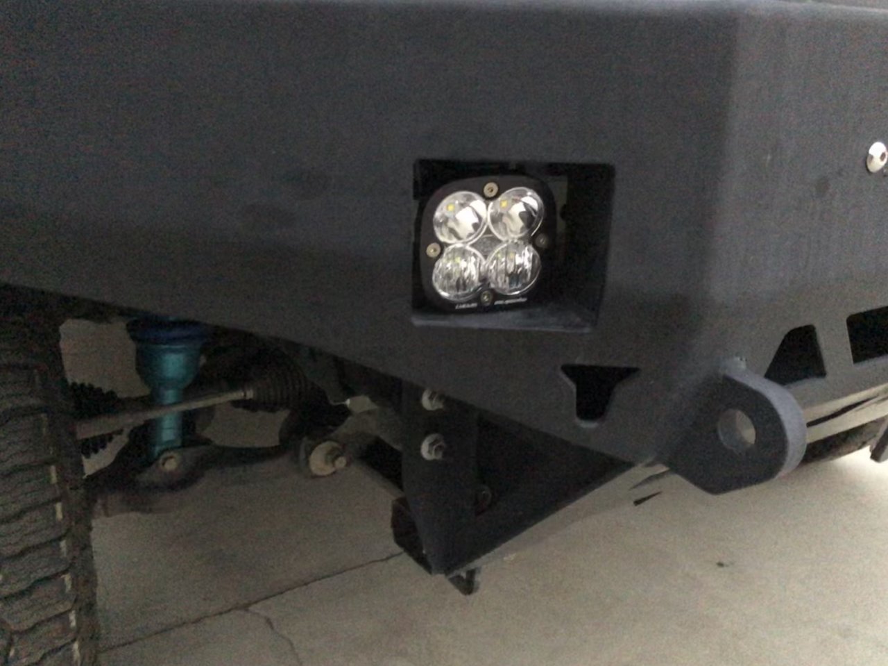

    And to top it off I finished with install two baja designs squadron pros to replace the very worthless Amazon fogs I had in there. Crappy pic I snapped before leaving to work this morning.
