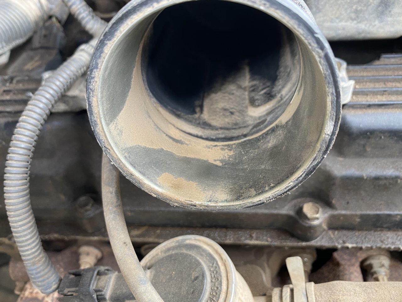

    This isn’t what you want to see when pulling off the airbox...

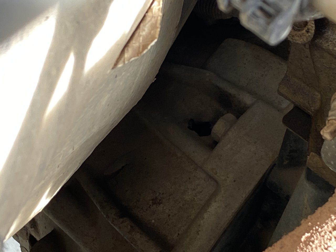

    I could get it rebuilt for like $2500. Then I wonder about all the other things that have been neglected. Like I don’t even know how this happens look at these holes/gashes in the top of the trans housing o_O
    Some fckry is afoot

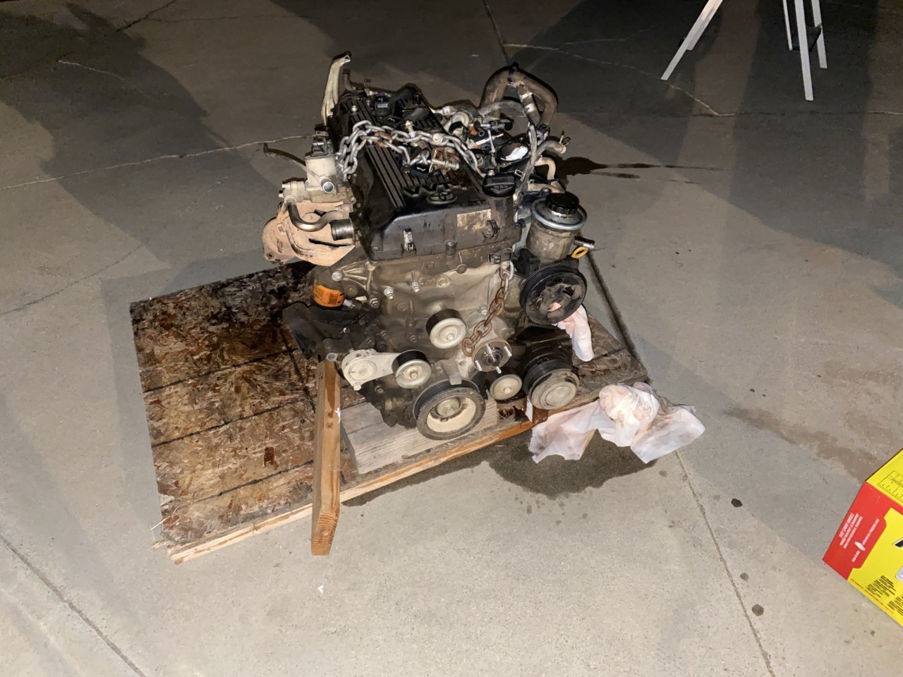

    9F474316-FE65-40AA-B3FB-542EA9CF0D82.jpg 32A04F77-2D84-4CC6-8A2D-6231D9219F0A.jpg
    Engine is out

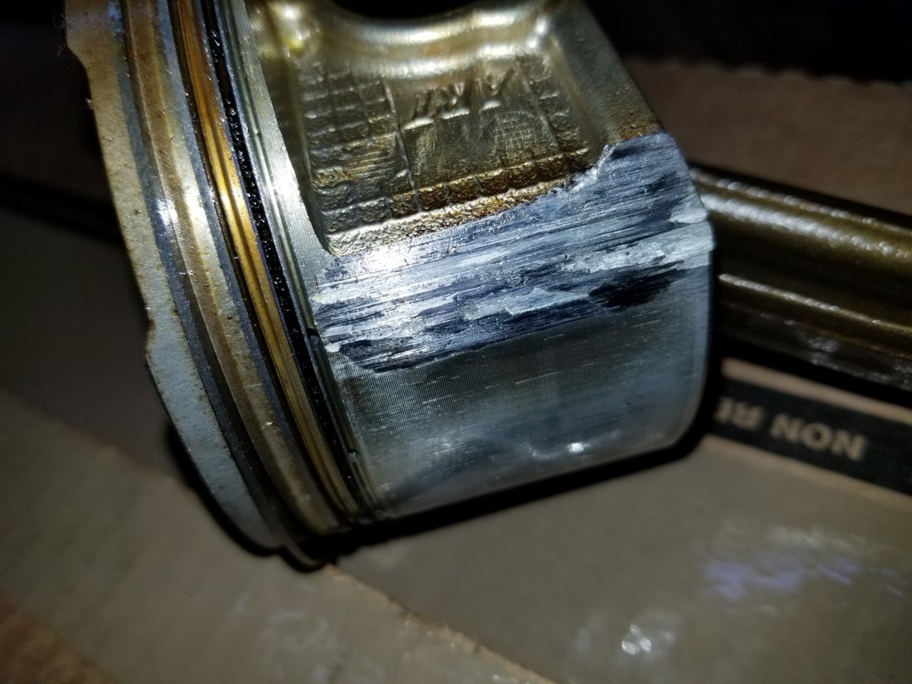

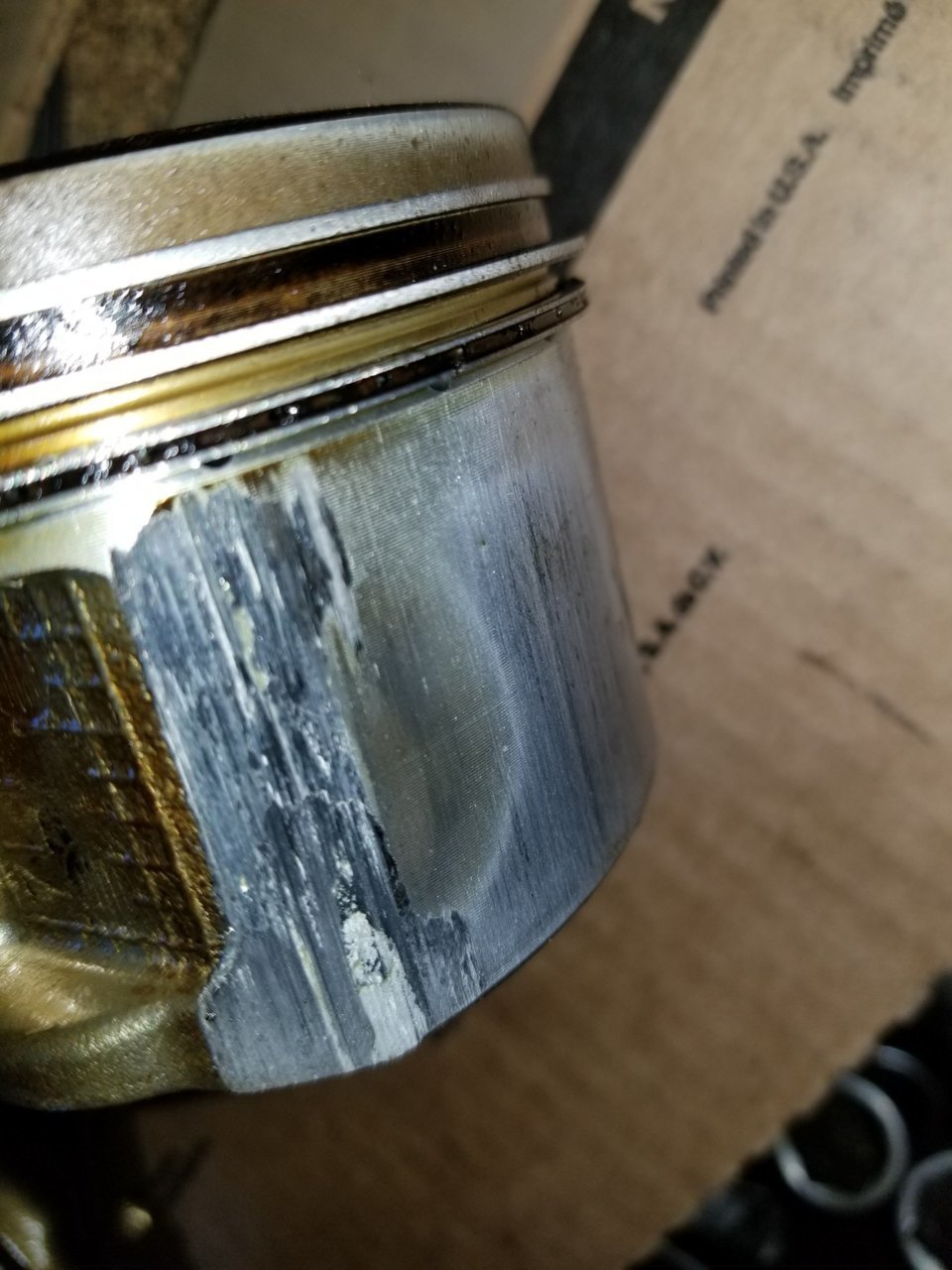

    2479A7B9-0F56-4F9B-A87E-0A13F2D86705.jpg 4284CCF4-6A53-4AA9-AE95-A2949DD88061.jpg
    F in the chat for cylinder #4

    Little bit of sanding and polishing will clean it right up. Slap it back together and run it lol. Or v8 swap

    Haha yeahhh. She is gonna get rebuilt, probably gonna be a like 2.9 L after everything is said and done if the sleeves can be bored out. I like the 4banger so I am gonna stick with that for now. With the final goal of making it a 2tr-fte haha
