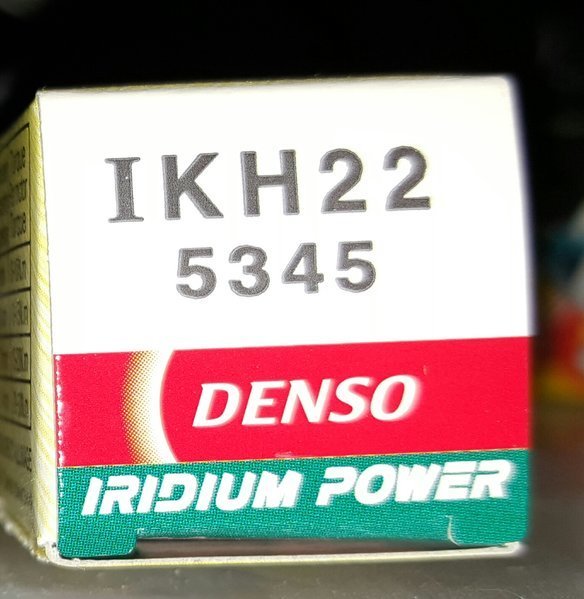

    Denso Iridium ik20

    Was thinking of doing my plugs, belt, and s/c oil today too. I need to see if anywhere has those Iridium plugs... Cuz my dumbass ordered factory plugs.. Should have went cooler (ik20)

    The ik20's?? Damn... Might just hold off then and order em from ebay.. Then just sell these plugs to someone..
    Anybody need plugs?? Lol

    22's? Hmmm..
    @jberry813 maybe you can clarify? I ask because I saw your recommendation for ik20's in another thread.

    I think the 22s are just the next level of iridium over 20s but I am not really sure. I was looking at new plugs for my truck as well.

    IK20 for supercharger. IK22s for supercharger and URD piggyback with smaller pulley. General rule of thumb is you go one step cooler plug for every 50hp gain.
    Also depends on what you gap the plugs at.

    So I'm running the stealth pulley, with toyota tune. Was going to do factory gapping with ik20's. Think that'll work?

    Ahh I was referring to the 5vz engine. I haven't done any tuning with the 4.0.

    Got ya, thanks for the clarification! I found the old plug boxes that were installed with the blower.. Ikh22, will probably just play it safe and run those again.
