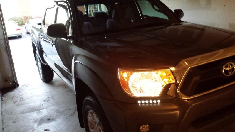

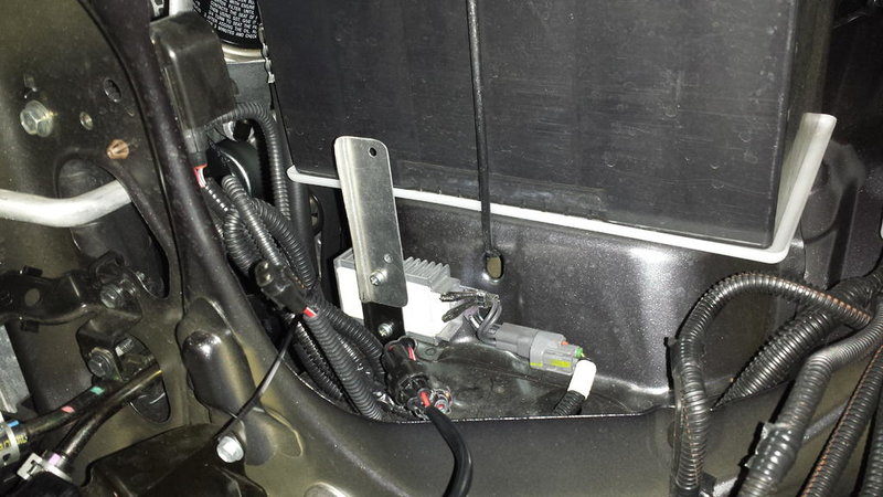

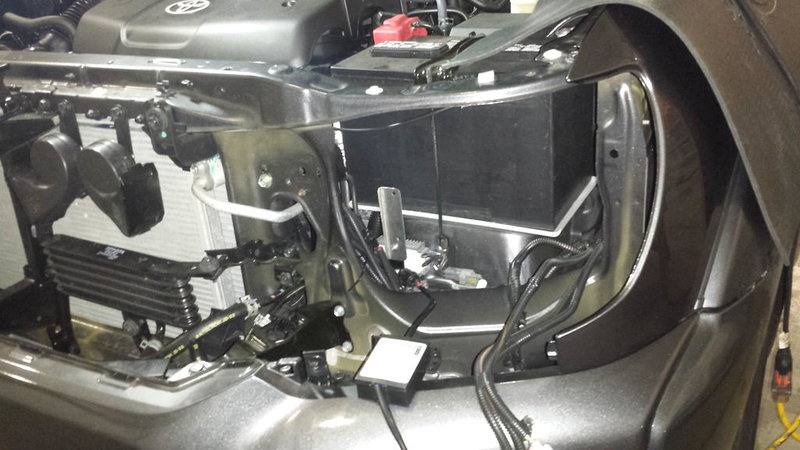

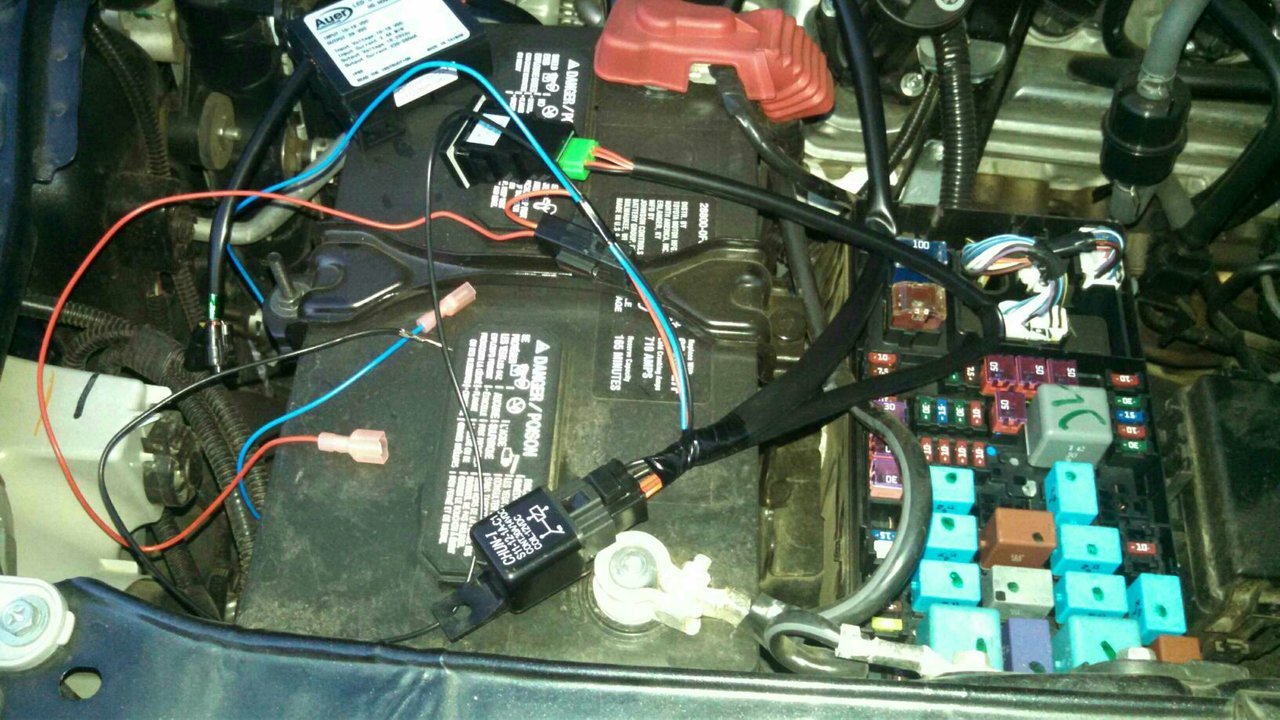

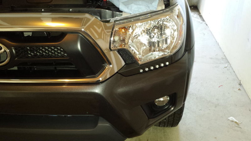

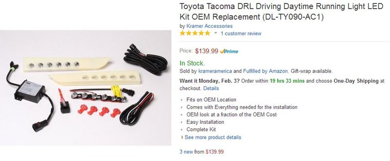

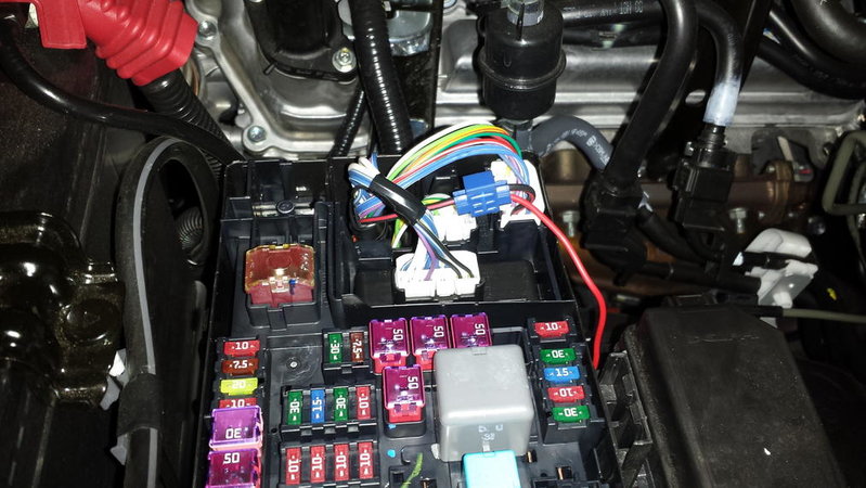

    Here's my install of the LED running lights on my 2013. Almost everything was ordered from Amazon.com.

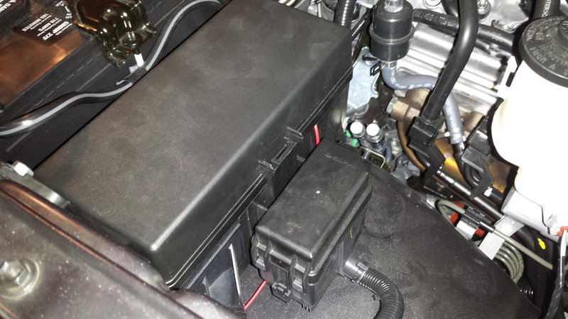

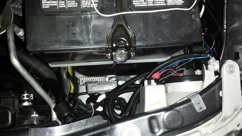

    Hey I ordered the same kit but haven't installed yet. Over all are you happy with it? What kind of work did you get into in the fuse box?

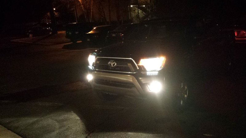

    Yeah I am really happy how it turned out. The fuse box was really simple, I just piggy backed off of an accessory wire so that the lights come on when the key is turned into ACC. They come on full bright with just the DRL selected but go to 50% when the headlights come on. I might change it a little bit so that they go to 50% when the side marker/parking lights are selected too.

    Wow, this is the exact reason I clicked on the lighting forum. I was hoping someone wired them in light you did. Ive been trying to figure out how to wire then into the DRL position instead of the switch.

    Everything looks similar except this stupid switch so frustrating d5a4196a70c437cab64147d21e45aa10_4a1710e4bca3862b2aa2b24f72c8e0da3a4dbcd1.jpg

    Where does that blue wire go on yours?

    On my bluesea block? It's power to the relay. Then from the relay to my switch inside the cabin.

    This one. Switch? The one on the turn signal?uploadfromtaptalk1440554783035.jpg

    That's the OPs photo. I was confused and replied you with his photo, thinkjg you were the OP

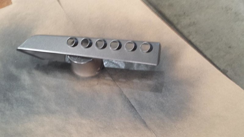

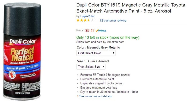

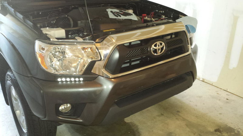

    Be careful with duplicator clear. It does not harden like real clear coat.
    Looks good otherwise.
