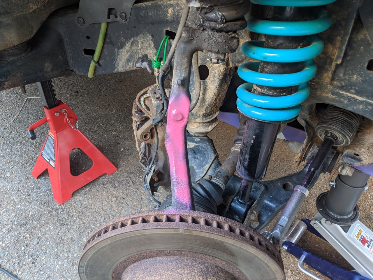

    These have mostly been showed here in bits and pieces, so heres the consolidated version that t4r saw:
    Mid-Frame Rust Hole
    This past week was my spring break, so I had some truck mods planned. I was getting ready to make a skid plate for my trans and tcase areas, when I discovered some rust holes
    1st hole was about mid frame on the passenger side and the second was right where the frame connects to the trans crossmember. Both of these, and all of my other rust problem areas, are on factory weld seams. So my thoughts are that the weld seals were not properly prepared before paint
    [​IMG] [​IMG]
    I did not get to the trans crossmember hole this week, but I did get to the one on that mid frame seam
    Started by cutting it out, and it was crusty. Used a combination of the grinder and plasma cutter
    [​IMG] [​IMG]
    Interestingly enough, the weld seam was super crusty, but the other side of the frame was mint looking. These frames are welded together of C shaped sections that are offset, like hardwood floors, so weld seams aren't directly across from each other
    [​IMG] [​IMG]
    I then made up a patch piece and painted the inside
    [​IMG] [​IMG]
    Here is the rough cut hole that was cleaned up a bit from here. Before cutting the hole entirely, I made a little crossmember to span the hole area and keep the frame from spreading
    [​IMG] [​IMG]
    The I burned it in and painted the outside to prevent future rusting. There is an exhaust hanger here, so I did drill and tap an appropriate hole so it could be reinstalled.
    [​IMG] [​IMG]
    1/2 Gusseted Spindles
    I've had these spindles since August, where I purchased them from a junkyard and stripped them down. Just got caught up with school and didn't get around to them. Came with spindles, great condition dust shields, some parts store wheel bearings, OEM speed sensors, and the speed sensor wiring harness
    [​IMG] [​IMG]
    I ordered the JD fab tacoma gussets and welded them onto these OEM spindles
    [​IMG] [​IMG]
    [​IMG] [​IMG]
    Then I painted them black, made a joke post for my friend @EatSleepTacos on TW, and then lost a bet and had to paint them Patrick Star pink lol
    [​IMG] [​IMG]
    Installing the driver side was a breeze!
    [​IMG] [​IMG]
    I was worried about tire to spindle clearance, since I'm running low offset wheels, but it cleared fine for street driving! I was thinking I'd pick up some 1/2" bora hub centric spacers to keep scrub radius low, while also adding a bit more room there for a budged, aired down tire. The are close enough that they'd probably rub when aired down
    [​IMG] [​IMG]
    The doing the passenger side led to problems. Started by breaking the wheel speed sensor and ended up finding out that spindle must have been bent. The tire was contacting the gusset and was really close to the UCA with the ball joint slider in about the same position as the driver side. Also looking down the tire, the wheel was cambered in much more without changing any of the alignment.
    [​IMG] [​IMG]
    It was a big bummer, and I was trying to go wheeling the next day, so I quickly reversed it all back to the original spindle. Fortunately or unfortunately, I'm now pretty quick at this. Also added some pink to the stock spindle for good measure
    While I was in there, I also did Sankei 555 inner and outer tie rods, since I think mine were original at 238k lol. They didn't actually have a lot of play in them, but it was a "while I'm in there" kind of job
    so now I have 1 gusseted spindle, and 1 regular spindle. Hence the title, 1/2 gusseted spindle lol. Hopefully I can just buy one gusset and make a day out of gusseting my current spindle.

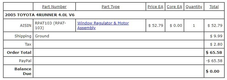

    window regulator met an untimely demise yesterday when my friend decided it would be a good idea to hold the window button down, so I couldn't roll it back up, while yelling penis out the window. Initially was looking at just the motor, but the whole regulator has to come out anyway. The assembly wasn't as expensive as I was expecting, so I just got it all. managed to snag the last AISIN part on rock auto.
    in return they received 1 entire trip around a roundabout with no swaybars at a speed of my choice. thanks to my broken wheel speed sensor, safety was completely disregarded
    I'll be taking pictures to hopefully do a writeup on T4R of the replacement. Found one of the driver front door, but the rear windows and regulator are setup a lot differently. I'll put the pictures in my build thread here as well for entertainment value, but I'd guess the tacoma door regulators are different.

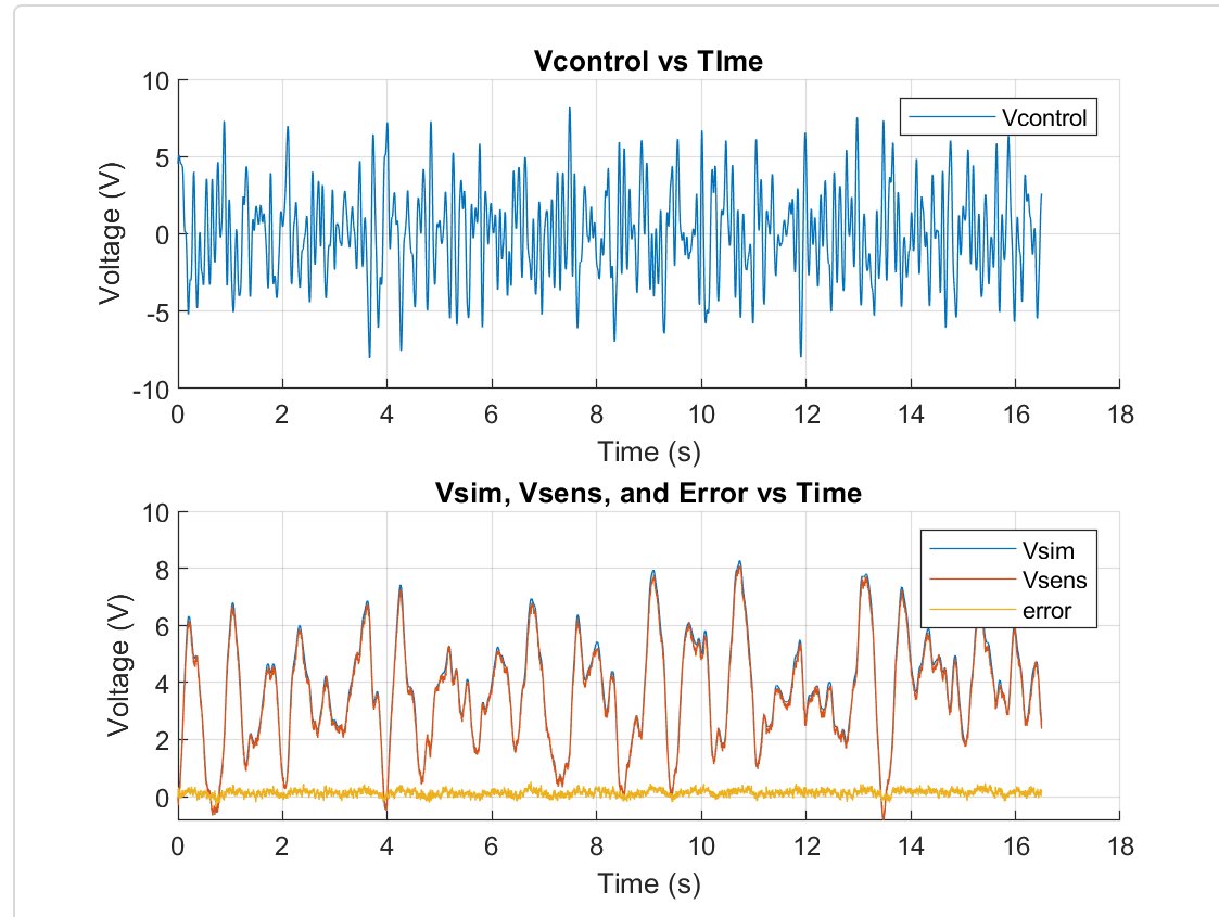

    Doing some nerd stuff at school, but I'm always trying to draw connections from all the theoreticals to the real world stuff. Recently worked on a lab that reminded me a lot of speed sensor control and speedometer correction that would be applicable to our Toyotas. In the moment, doing things like this lab is kinda boring. In hindsight, this stuff is really cool and explaining it here helps me to solidify it further. I tried to not use any jargon, so hopefully it makes sense for anyone interested
    Essentially, an servo motor is given some voltage input, and an encoder reads the position/speed. However, there is some random noise signals that are mixed into the voltage input. The goal is to filter out the noise, while also adjusting the speed/position read by the encoder to be representative of the motors actual speed/position. The motor position control system is sometimes hard to wrap ones head around, but its very similar to a house thermostat. The values read from the position encoder are like the thermometer in the room. Noise is like opening and closing the door, which varies the room temperature slightly. Input to the motor is like what your HVAC system does to try to regulate the room temperature based on what its reading from the thermometer
    This would also be just like the signal coming off of the speed sensors on a 4runner/tacoma, where there is a speed signal + some inevitable noise. The adjustment between the values read by the encoder and the actual values could represent the correction to speed signal for larger tires.
    In this below graph, Vcontrol (blue line, first plot) is the voltage going into a micro controller. it represents the speed of the motor + a random noise signal (liken to room temperature when the door opens and closes - a lot of little changes in temperature)
    Vsens (orange line, 2nd plot) is representative of the control signal after is goes through a bandpass filter. The bandpass filter filters out frequencies above and below some threshold values to try and eliminate the noise. (liken it to the temperature in the room without opening and closing the door, but would include long term temp changes like opening your window for a while to let in fresh air)
    Vsim (blue line, 2nd plot) is representative of the simulated time response from my analytically derived function. The function is derived from an basic electromechanical system by hand, and then put into the computer and combined with the Vcontrol input to get the Vsim output we see plotted.
    Error is the difference in Vsim and Vsens. The Vsim value follows Vsens very closely on the graph, but Vsim actually has a magnitude difference from Vsens due to how the position encoder works. The magnitude difference here is representative of the larger tires size affecting the speedometer by X%. In my project, I wanted the error to be 0, but with larger tires it represents the difference in speedometer reading and actual speed
    nerd stuff, so may have limited entertainment value. but helpful for me to explain it and draw the connection
