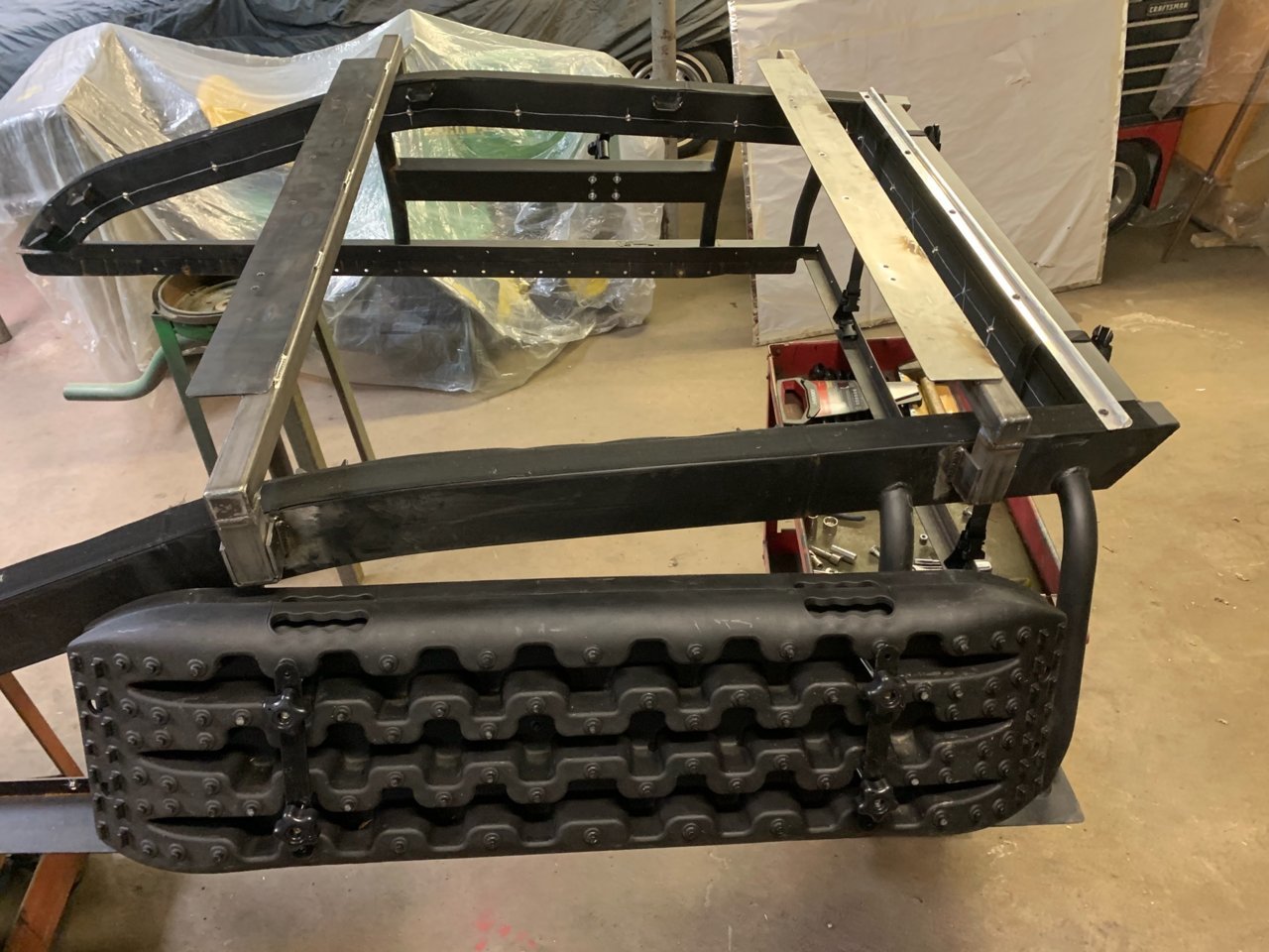

    I got made custom bars with a bigger and wider plate to disperse the load, I got rid of the factory clamps you pictured above.
    dbbowen2 likes this.

    Is the clamp removable? Can you just run a bolt straight through the tent and bars? My thought is that it would be easier to not deal with a "universal" type of clamp.
    surfandturf likes this.

    Do this...dont use the clamps. Just bolt straight to the bars
    Taco_Craig[QUOTED] likes this.
