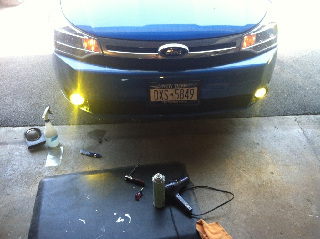

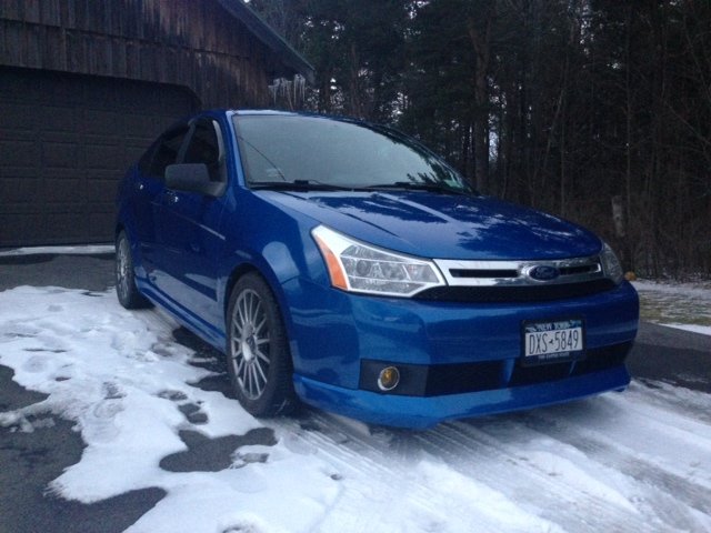

    Go with vinyl overlays!
    These are the same ones I got for my focus and they worked great and actually made the light yellow and not lemonade colored.
    http://www.ebay.com/itm/08-10-FOCUS...Parts_Accessories&hash=item2569d69c76&vxp=mtr
    I have a spare one, I will go see if it's big enough to fit.
    ----EDIT: Yes they are big enough
    here is what they look like: left side is overlay with 3000k hid. They look much more yellow if you use a halogen bulb. I went back to halogens and that is what is in the car right now.
    this is 3000k hid bulbs with the overlays
