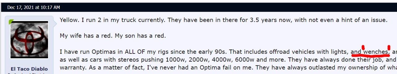

    Back in the day, I was running 3, 4, 5 wenches at a time in my rigs. :rofl:
    Winch... winch is the word I was attempting to type.
