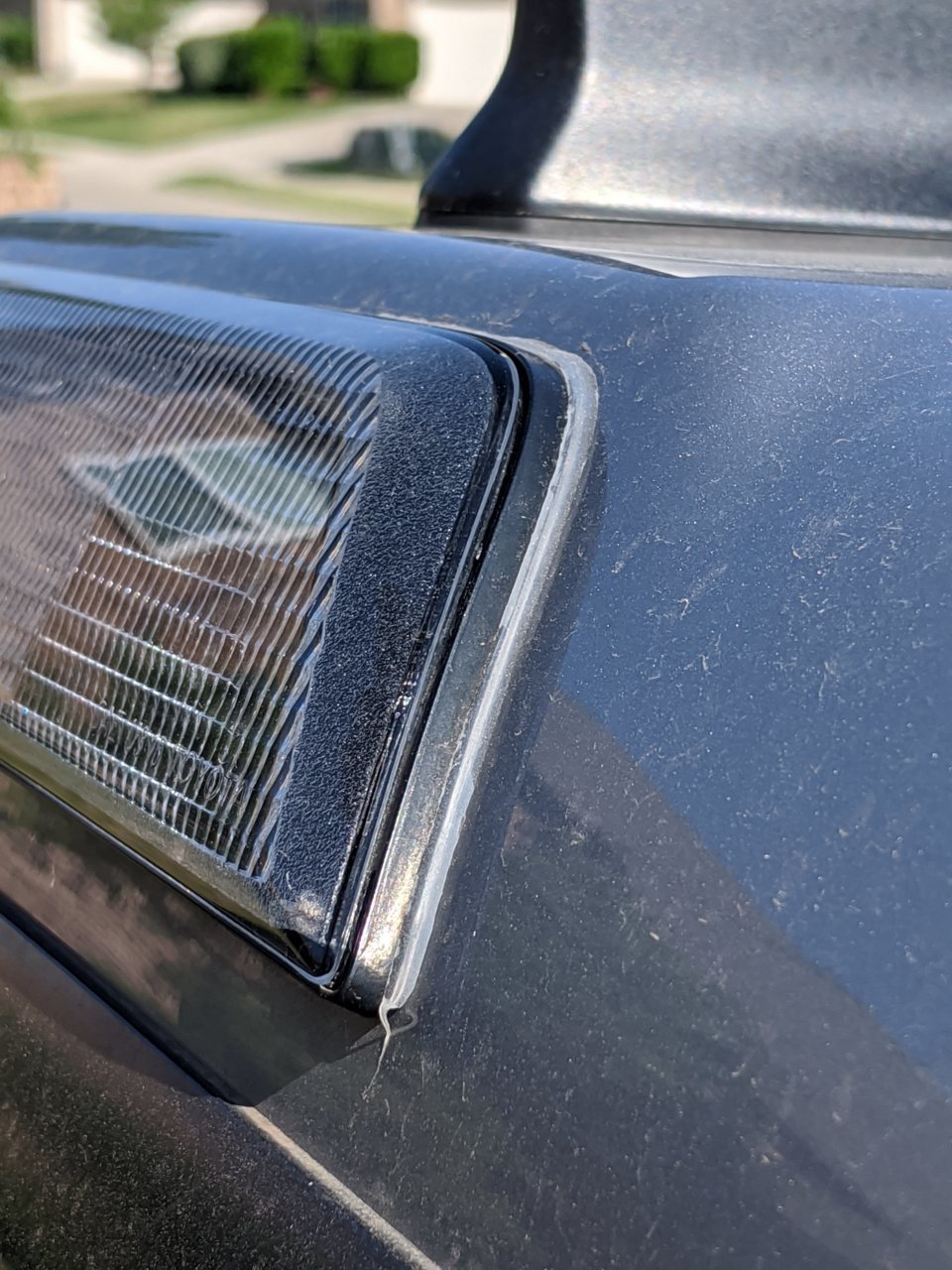

    Mine just leaked for the first time about 2 months ago. Almost 4 years old and 50k miles on it. I ran a small bead of silicone all the way around and no more leak.

  18. May 4, 2020 at 3:04 PM
    #58
    suaveflooder
    suaveflooder Well-Known Member
    Feb 28, 2018
    #245929
    1,291
    2021 4Runner Venture
    Ugh, I may just do this. I hate taking my truck to the dealer. I want as few people as possible touching this truck.
    you pull the light, silicone, and put back on?
  19. May 4, 2020 at 3:08 PM
    #59
    Stoked
    Stoked Not So Well-Known Member
    Oct 31, 2018
    #271183
    201
    Jeff
    Celina, Tx
    2016 DCSB TRD OR
    No, left it in place. If I was gonna go thru the hassle of dropping the headliner, I would have bought a replacement. I just got a new tube of silicone, cut the tip as small as it would let me, and ran a nice, smooth bead around it. I figure I can pull it out and re-do it whenever it needs it.
