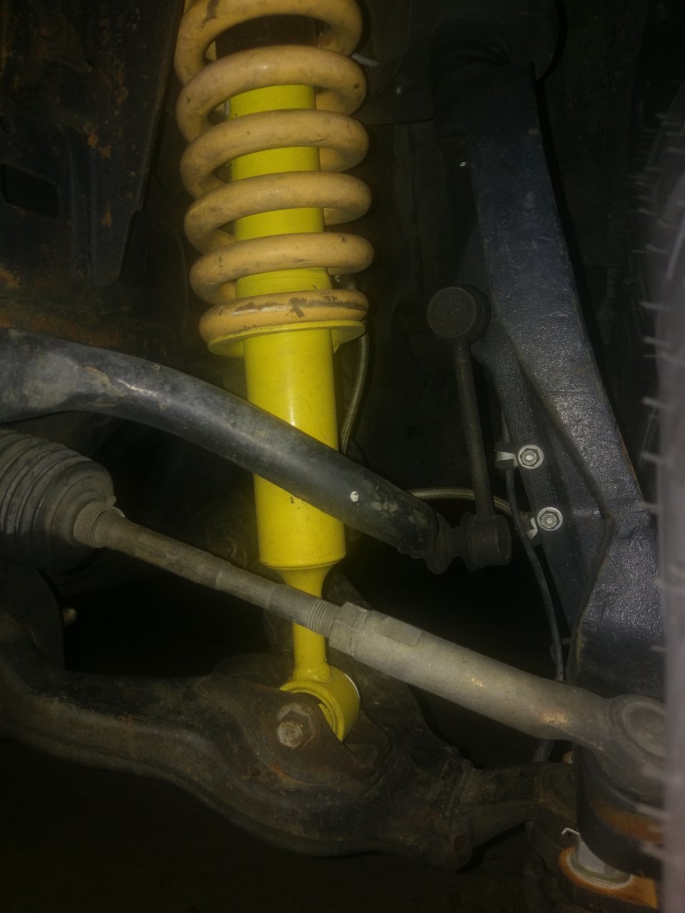

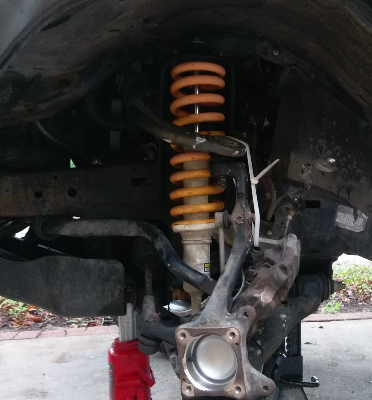

    #51

    It's midnight here, I literally have TB of pics and Vids of my truck, short notice best I can do. But you get the point. See how the Rancho's, like Freedom's have a flat base at the bottom of the coil? The iron-man and Dobinson's don't, like all other good struts.

    I never noticed this until just now reading my own post, lol! See my 2nd pic, the spring is scraped up after I removed the Rancho's, the scraping from rubbing matches yours.

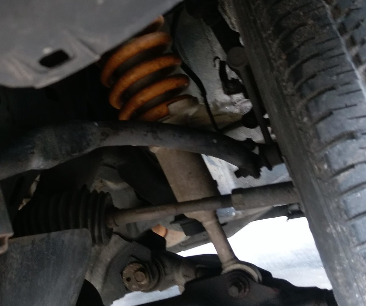

    The second to last pic look at the Rancho in the foreground, see rub marks?
