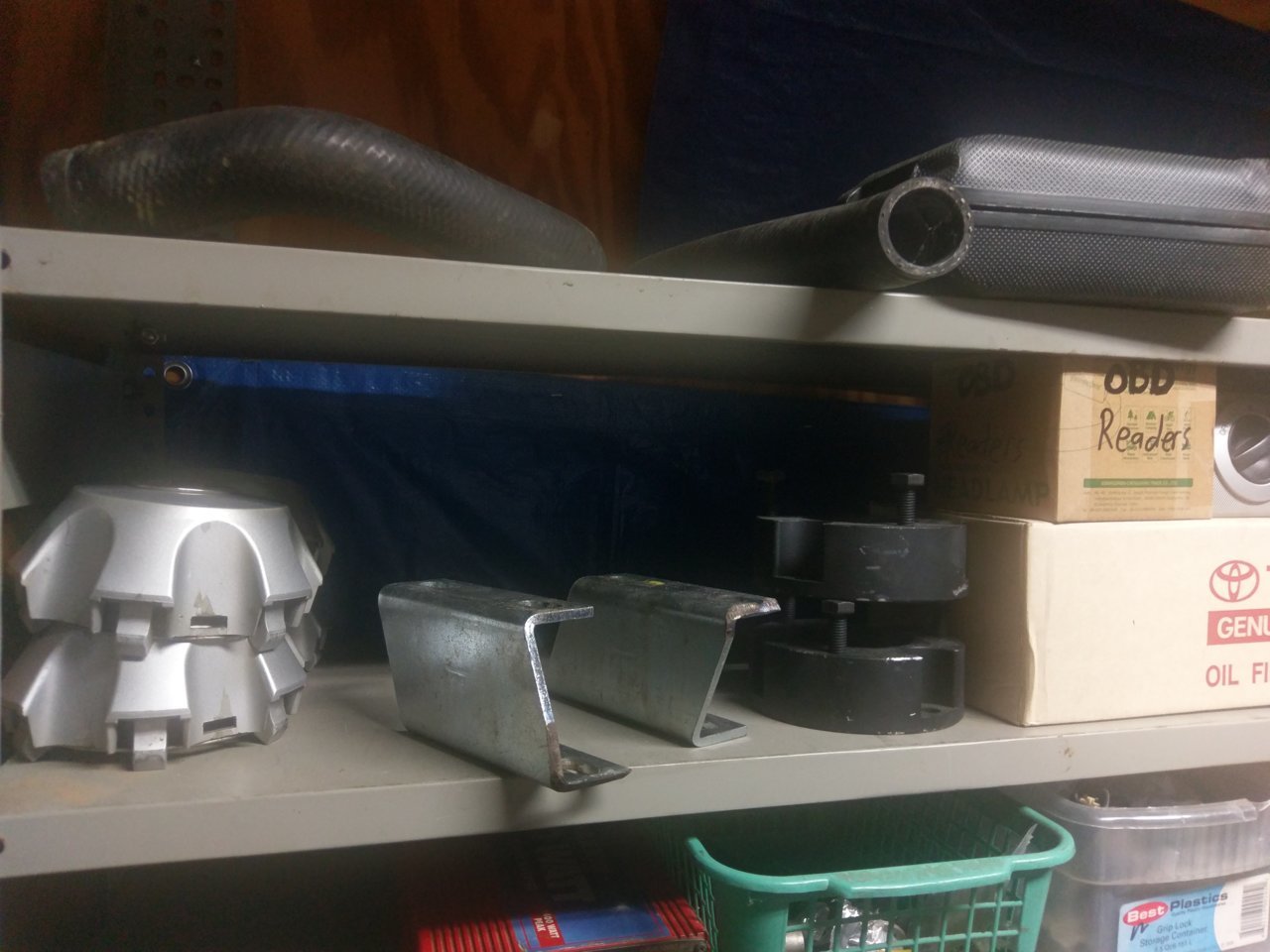

    I noticed the spacers on your shelf in this pic. Isn't your tagline: "friends don't let friends drive with spacers" hahahahaha. I'm happy to see that you removed them.

    Man, awesome rig!
    Lol, never installed. MaxTrac sent them free with spindles :) I did have spacers about 10 or so years ago for a little while, pulled them, put 5100's, pulled them shortly after, put coils. Learned my lessons the hard way... Wasting alot of time and money. Hence " friends don't let friends drive with spacers"

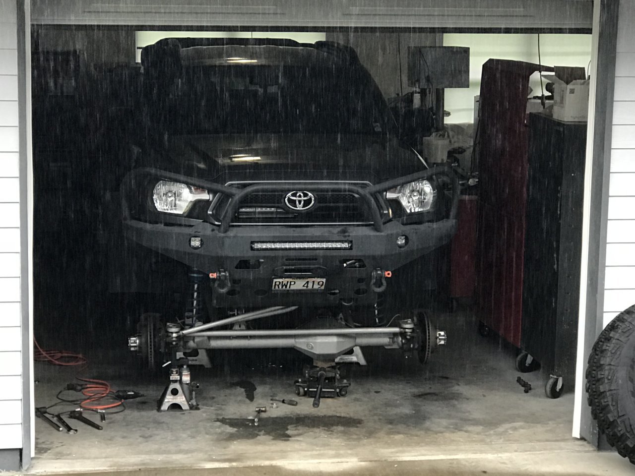

    I was checking on links today and making sure everything is still tight.
