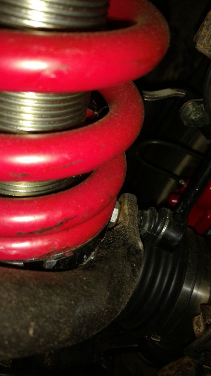

    It looks like your coils are sitting really low on the shock and that's why the swaybar is so close to the spring and seat. I have the OME nitro shocks and 885x springs and my bar is not close to the spring or seat. I can easily get my hand in between the swaybar and spring. My truck is sitting about 3" higher than stock and I have the Readylift 67-5012 swaybar relocation brackets which does position it further forward. Is your spring a larger diameter than stock at the bottom?

    @JL8Jeff They are 2.5" springs, so yes, larger than stock/oem. I decided to keep them on the lowest setting because I didn't want the extra lift. Turns out the bottom setting is too "soft" and the ride height is too low. I'll crank them up tonight and possibly remove the sway bar relocation kit. That should fix the rubbing issue. Still wanting to toss the sway bar though... but I'll just settle for a second truck.

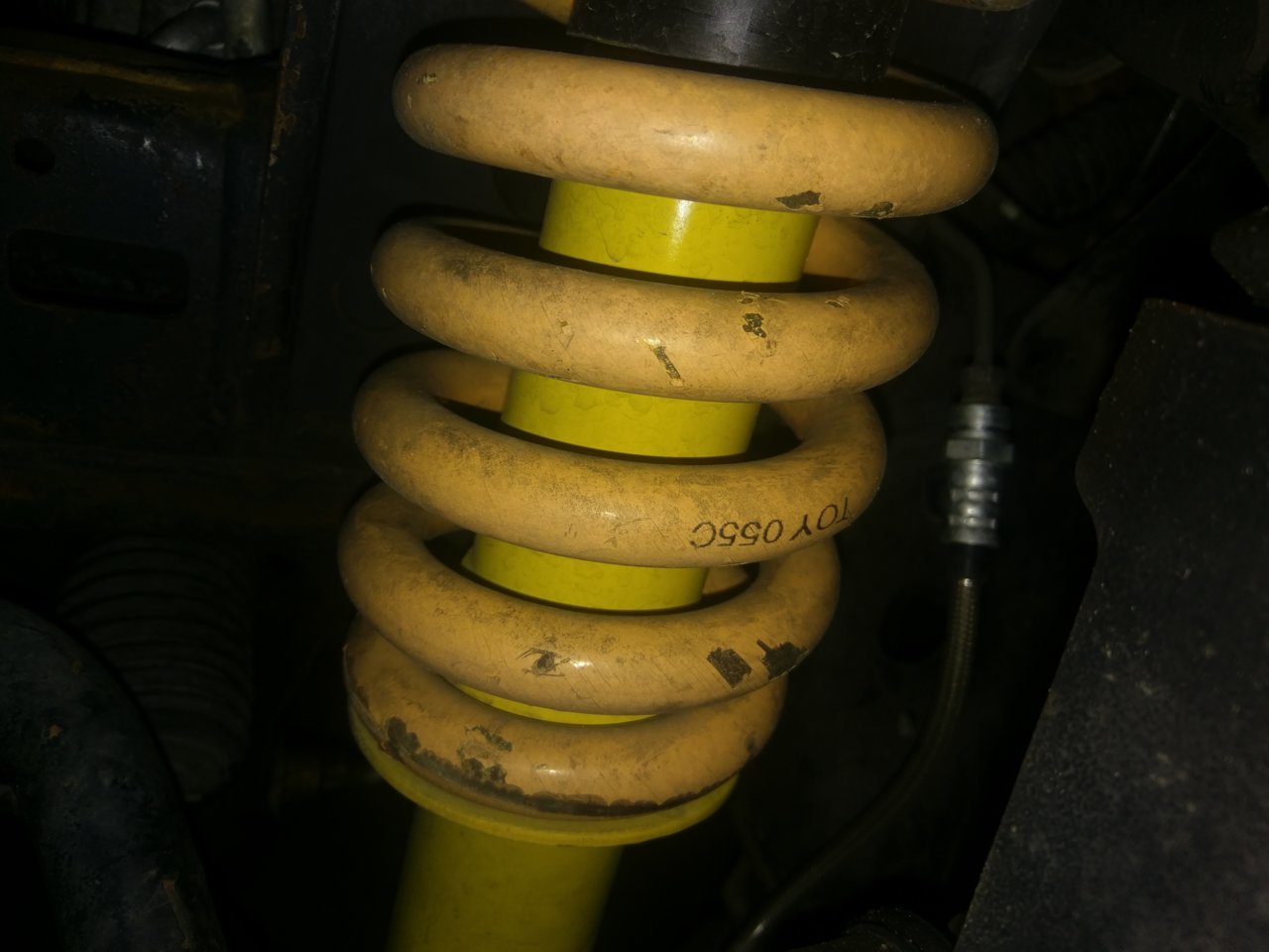

    Your point is???? TOYO55C and Rancho9000's at time of incident.
    Although in my opinion, Rancho 9000's are so poorly engineered that they should be pulled from public sale for Tacoma's I DOUBT they were the cause with 2012 TOYO55C 810 lb coils?
