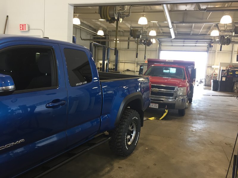

    As above, what went in can come out. Hammer as exactly in the reverse direction of how you pulled as you can. May be worth using a short piece of rebar or a sacrificial socket extension between the hammer and hook. Angle grinder if it doesn't work.
    Don't forget to touchup primer/paint any bare metal once the hook is out.

    The only thing I can think of is... wrap another strap through the hook, not the eye, and wrap that around the under side of a floor jack or a tree root. Then find a solid place near by that is higher than the axle and start jacking. It needs to go towards the front of the truck too so you might have to find a way to jack it up with the jack handle towards the front or jack from a location closer to the front of the truck.

    Propane torch around the hole to heat the metal, then start tapping with a hammer and it should drop out eventually.

    But all seriousness aside, heat around the hole, and pound it out.
