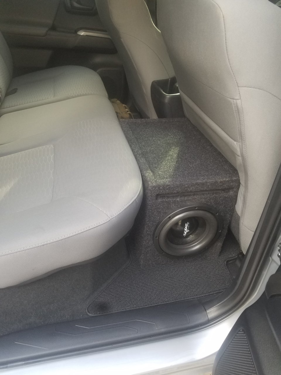

  7. Jul 8, 2018 at 3:37 PM
    Deacon Blues
    Deacon Blues Well-Known Member
    Sep 7, 2017
    #229363
    1,468
    Colorado
    2017 SR5
  8. Jul 8, 2018 at 4:15 PM
    Deacon Blues
    Sep 7, 2017
    #229363
    1,468
    Colorado
    2017 SR5
    It's not subtle....but it is loud as fuck lol.

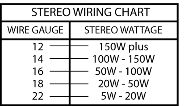

    Does this look like something decent to use for an LOC?
    https://www.crutchfield.com/p_142SLC4/Scosche-SLC4-Line-Output-Converter.html
    Also, others are saying the stock speaker wires can handle up to 75 watts. Which is true? 50 or 75?

  15. Jul 8, 2018 at 8:32 PM
    Deacon Blues
    Sep 7, 2017
    #229363
    1,468
    Colorado
    2017 SR5

  16. Jul 8, 2018 at 8:39 PM
    #16
    Deacon Blues
    Sep 7, 2017
    #229363
    1,468
    Colorado
    2017 SR5
    badhabit2break likes this.
  17. Jul 8, 2018 at 9:43 PM
    #17
    asayan
    asayan [OP] Member
    Jul 8, 2018
    #258718
    12
    Gotcha. But still begs the question: Is the stock wiring 16 or 18 gauge?
