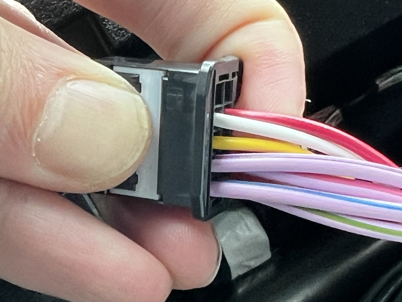

    I’m very confused. There must be something on here already, but I keep coming up empty handed, and crutchfield has something that doesn’t match up with mine. I’ve attached a few pictures of what I’m working with. By all means, reply with a condescending message, so long as it’s attached to several links addressing the same thing…

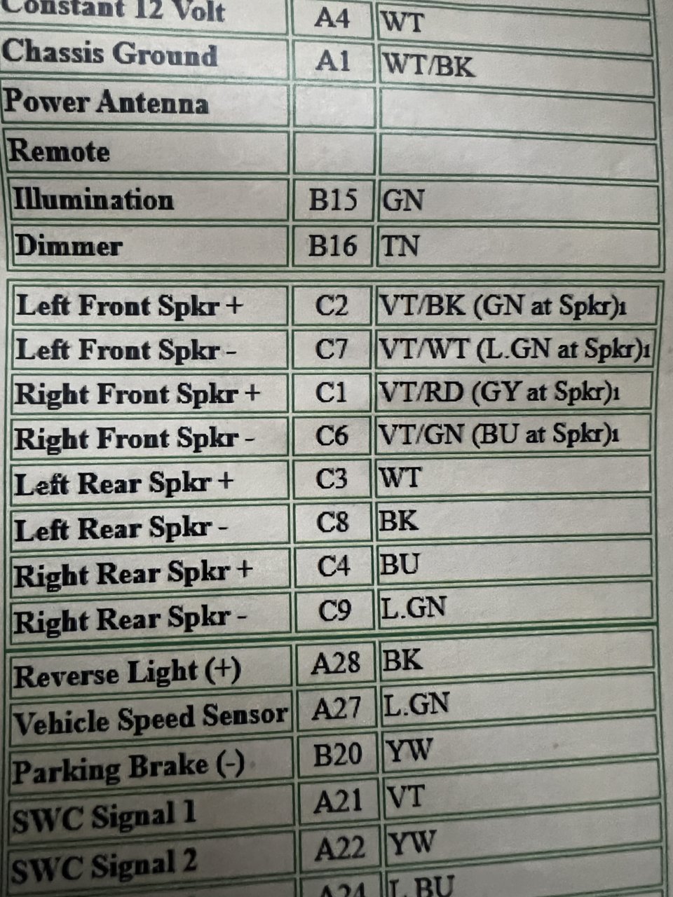

    This is from Crutchfield

    I think you've might've found half of your answer:
    https://www.tacomaworld.com/threads...bl-wiring-diagram.656554/page-8#post-27386489
    https://www.tacomaworld.com/threads/2020-tacoma-sr5-non-jbl-wiring-diagram.656554/#post-22896170
    Have you tried sending a PM to Destin Meeks?
    Does this help any with the other half?
    https://www.tacomaworld.com/threads...y-installation-complete.658383/#post-22986435
    https://www.tacomaworld.com/threads/2020-taco-sr5-speaker-line-colors.656552/#post-22896177
    I still need to double check a couple of things on my 2017 harness. :annoyed::smash:

    I have the diagram from crutchfield. I put it in my thread.
    I used red as remote turn on and also red and white as right rear. Black and yellow as left rear. The other purples are the fronts. (Double check the diagram, I am going off memory)
