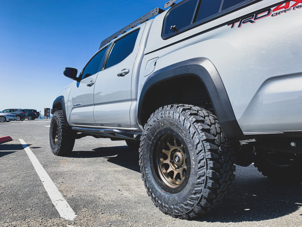

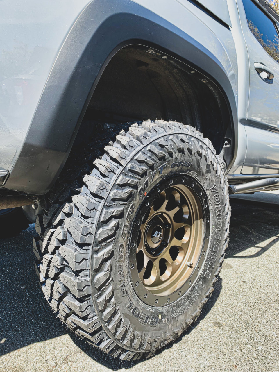

    295/70/17
    25BF3061-D584-4E57-B2D8-8C955A6FB8BB.jpg 2E1D0750-DB59-460E-A0CA-7539B02100C0.jpg

    Any rubbing issues?

    Nothing so far; haven’t wheeled yet though.

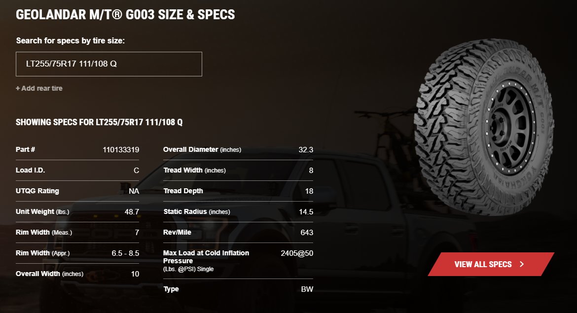

    So you went this size with a 9 inch wide wheel? I see conflicting posts that 255 on a 9” rim isn’t good. Mind you I won’t be airing down rock climbing.

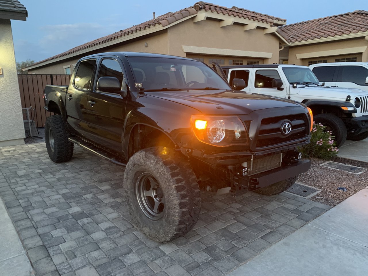

    These will be my next tire in 315/75/16. They look great and sound great from feedback of others. My milestars are ok but VERY soft and are cupping despite rotating every 5 k.

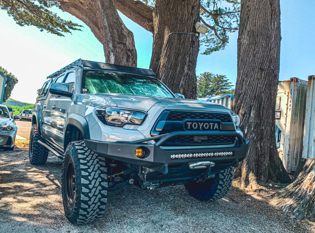

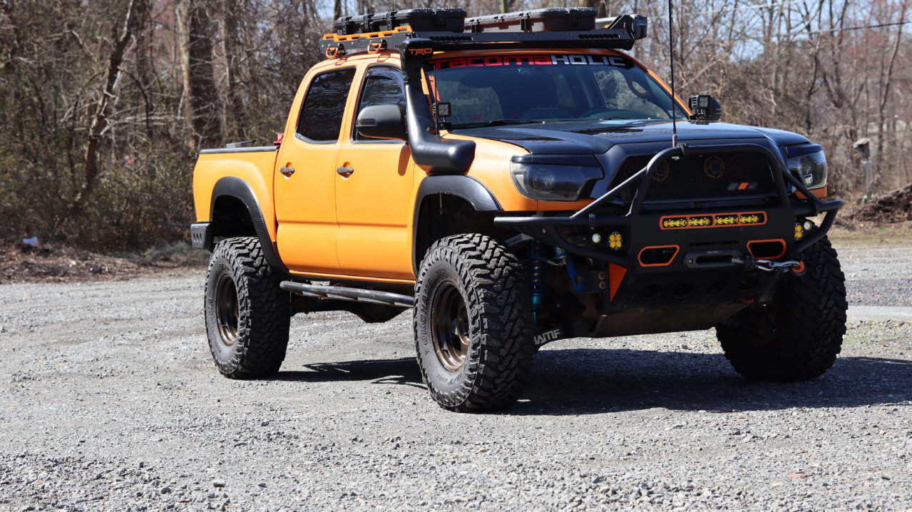

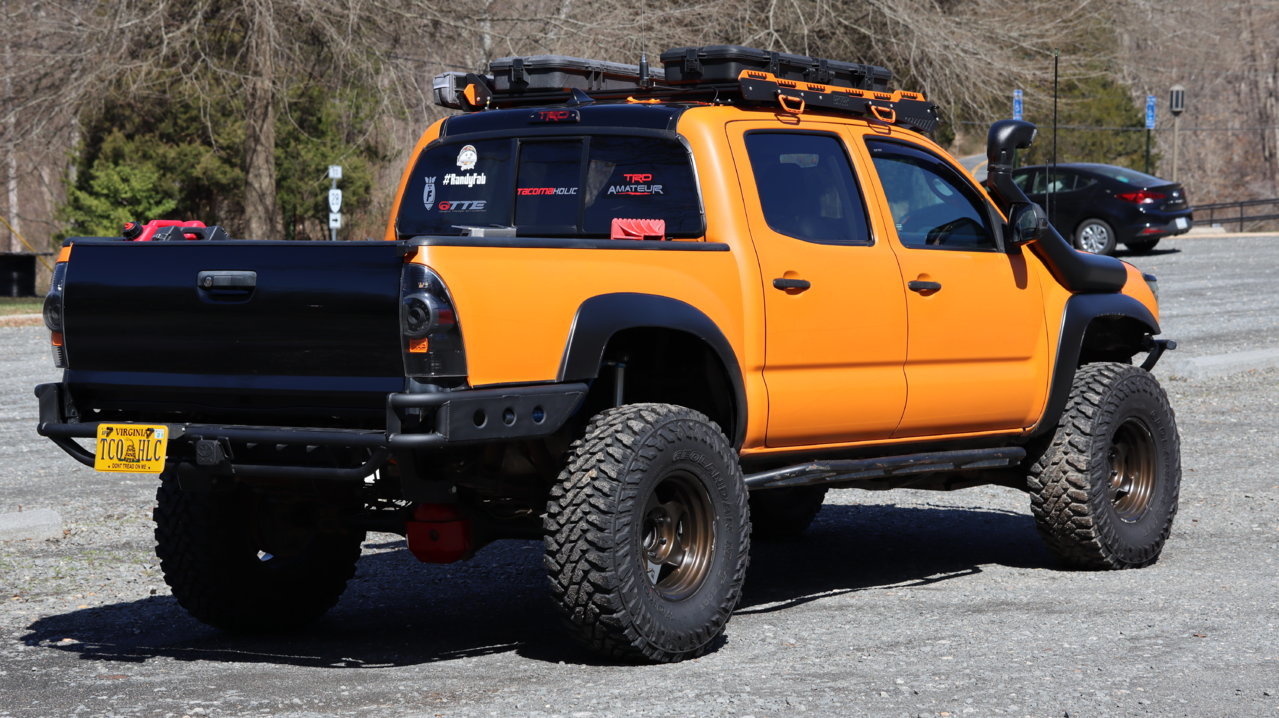

    Love mine in 315/75R16

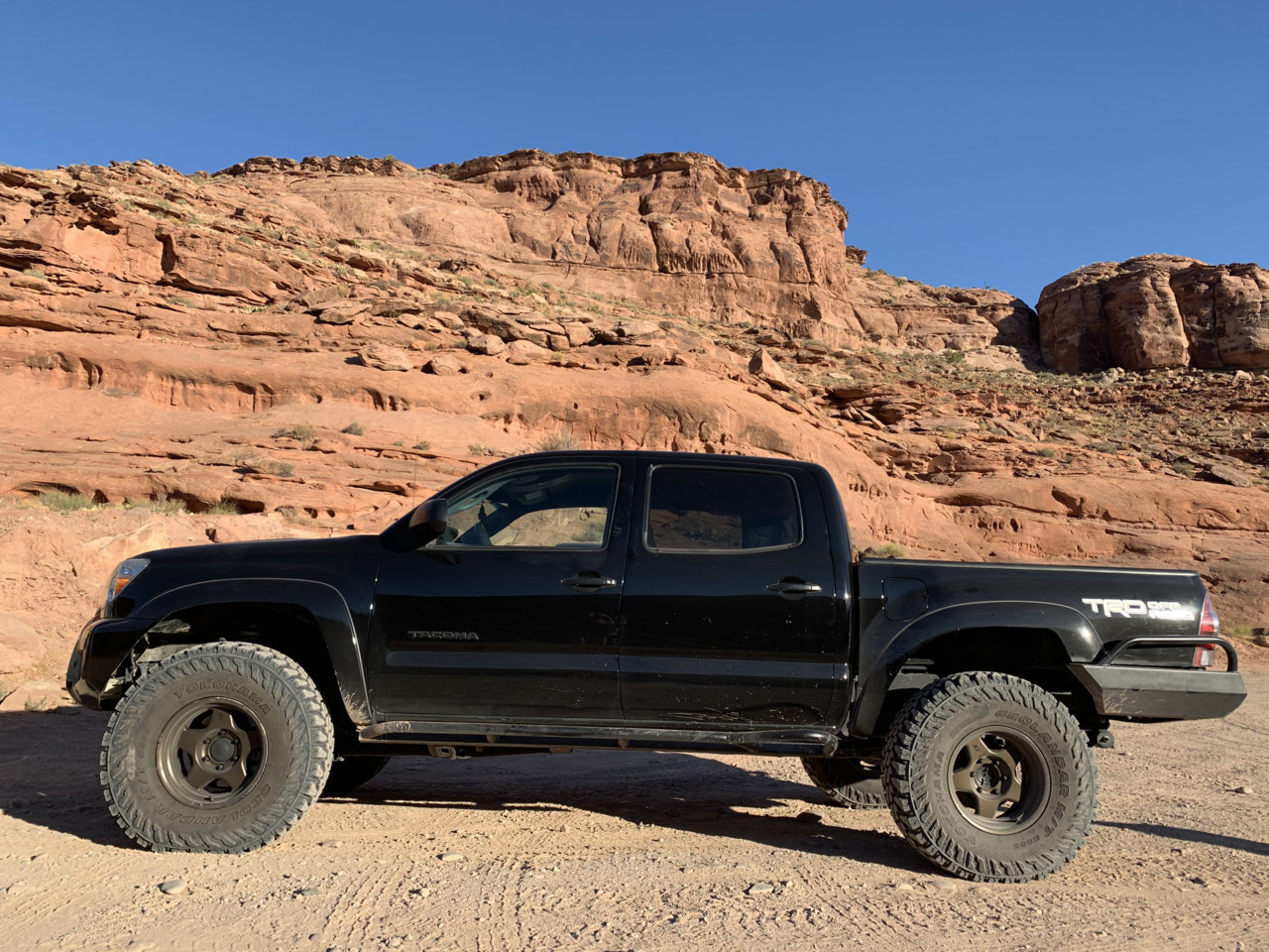

    Proper, buddy has the same wheels and tires.

    Dannnnnnnng those look like 37’s there. Love it

    I would not put a 255 on a 9" wide rim. Per https://www.yokohamatire.com/tires/geolandar-m-t-g003
