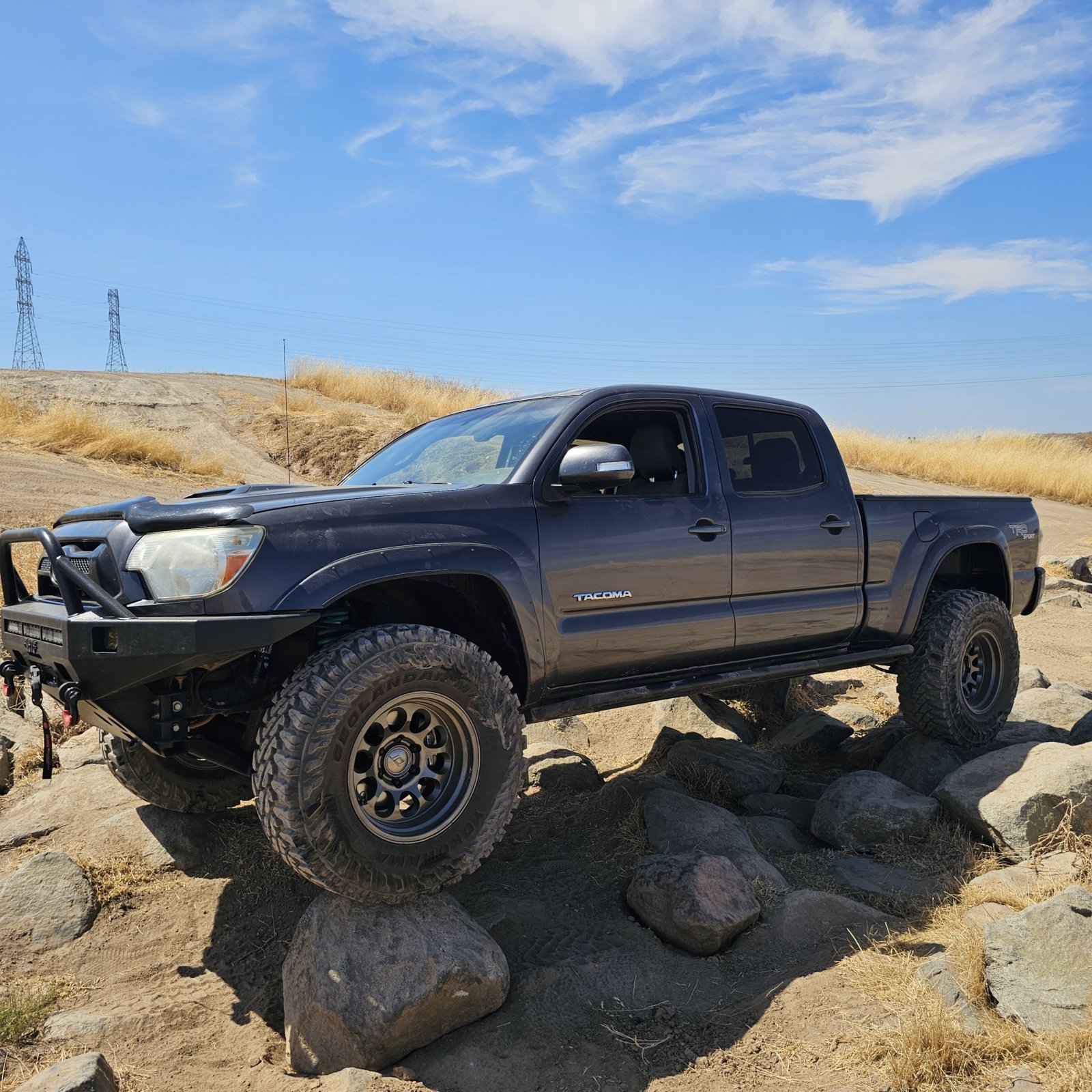

    I've been wanting to get these tires for a long time and finally got them recently.
    Crawling on the rocks and playing in the mud they're awesome! These things are going to be fun come winter when there's lots of mud to play in.
    35/12.5/17
    SCS Blaze 10's -38 offset

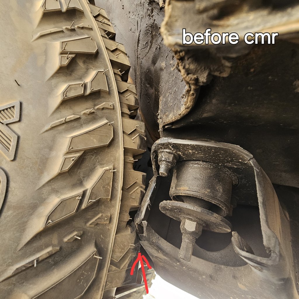

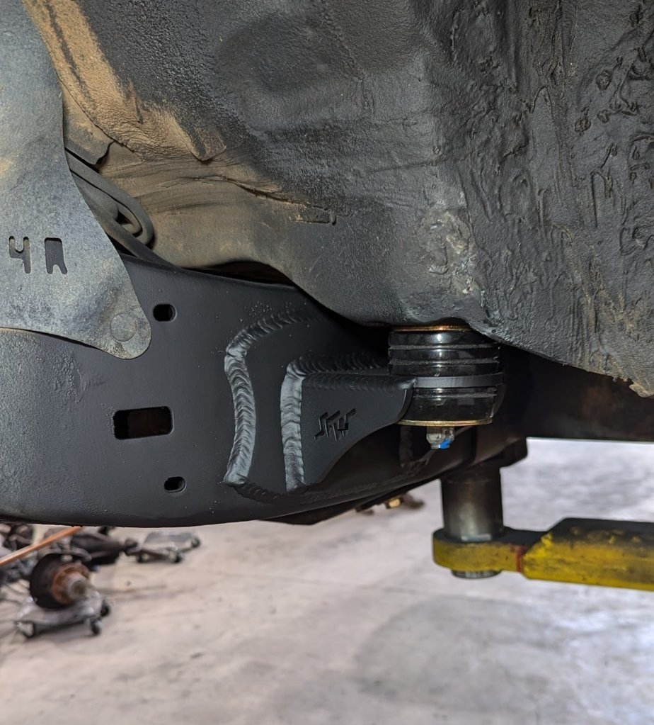

    Did you have to cut into the cabmount a lot and trim the back of the wheel well to make the 315s not rub with those -38? I have -25 and I was worried there would be a lot of cutting involved

    I did a CMR. And beat the hell out of the fire wall with a sledge hammer.
    I have 35/12.5/17 not 315's which are slightly different in hight and width but very close. I decided I would buy exactly what I wanted and would then cut and beat whatever it took to make them clear.
    In this pic below I started by cutting most of the cab mount off and did not rub unless I would turn into a steep hill at full lock/stuff
    Here is pic of my CMR which clears at full stuff/lock very well. Will also clear 37's

    Wow.
    Wow. I've looked at the relocate. I'd definitely want to find a local shop who really knows what they are doing before I commit to that.

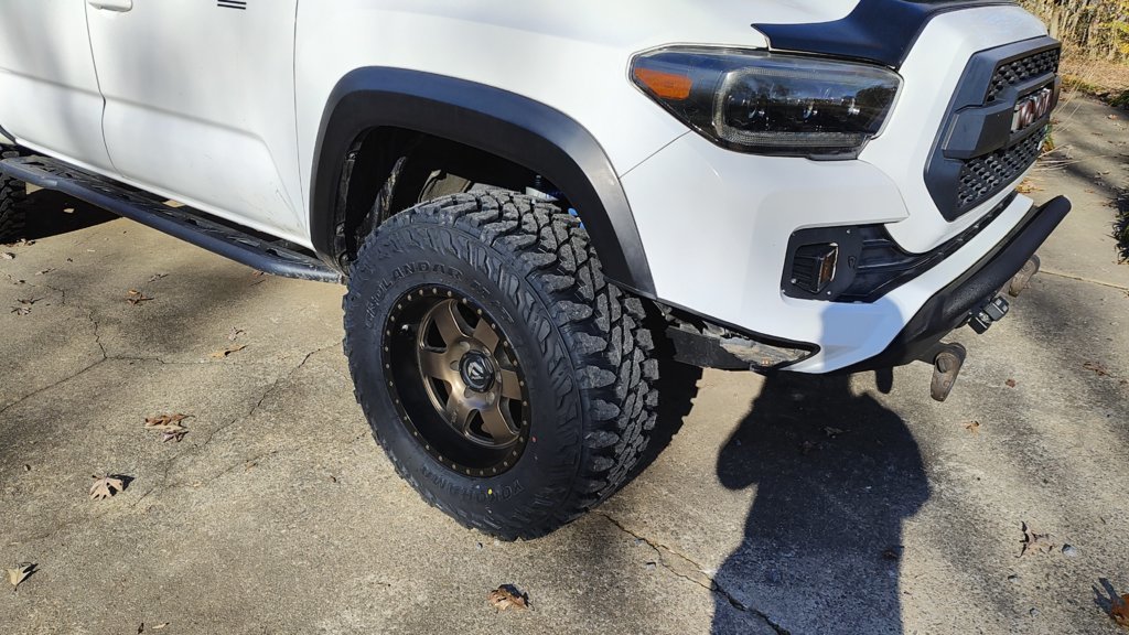

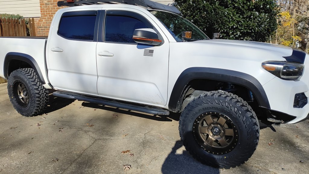

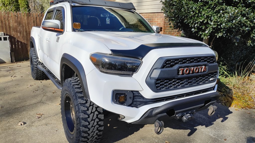

    IMG_20241130_101922361_HDR.jpg IMG_20241130_101932043_HDR.jpg IMG_20241130_101944599_HDR.jpg
    Finally stepped up to the plate and swapped the old ridge grapplers for these badboys.
