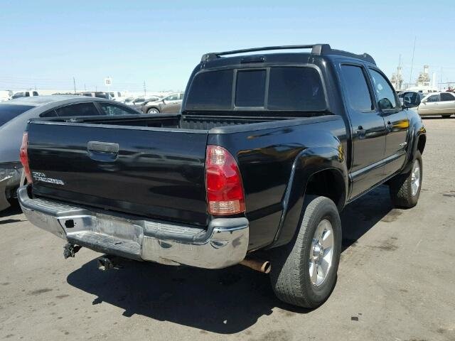

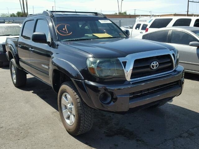

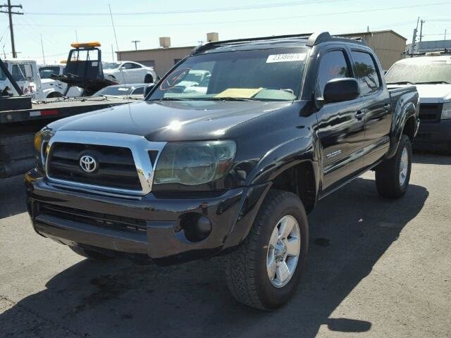

    I sold my last Tacoma August-ish 2010 and have been kicking myself ever since. The gold one is my old 2002 4X4 DC DSCN02332.jpg
    I was browsing COPART auto auction and came across a pretty good deal, I bought it right away and hopefully I don't regret buying it since I didn't look at it in person first. If I hadn't bought it right then (Buy it now) I would probably not have won the auction 12 hours later. It does have a salvage title due to a minor collision and theft but other than a few dents on the roof it looks really good. I've been doing all my own work for about 8 years now and can handle pretty much anything it needs. My current truck was stolen as well and it's been great for almost 2 years.
    This is going to be a more practical replacement for my 2001 F-250 7.3 SuperDuty (22 feet long and 7000 pounds of diesel power isn't very practical)
    The basics about the truck:
    2005
    Black Sand Pearl
    4X4
    Double Cab
    Auto
    Based on the picture, maybe a small lift?
    About 147k miles
    Fairly clean interior

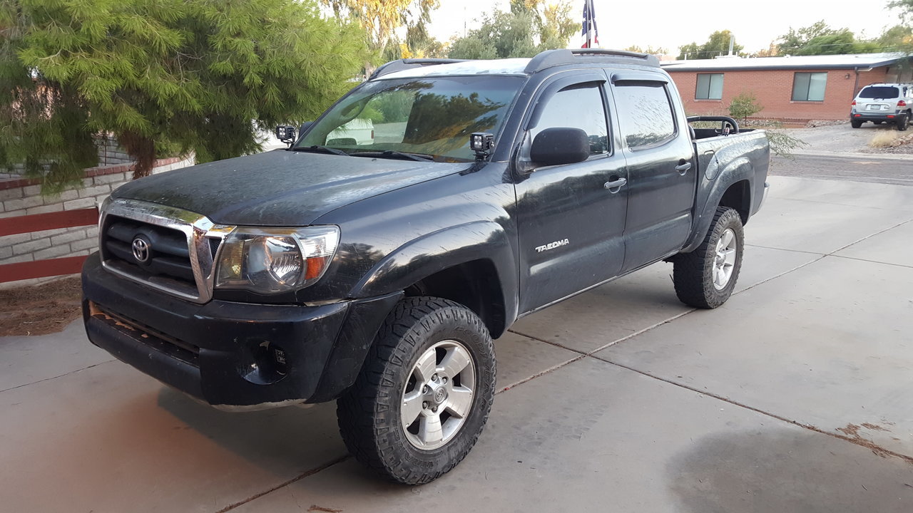

    More recent pictures:

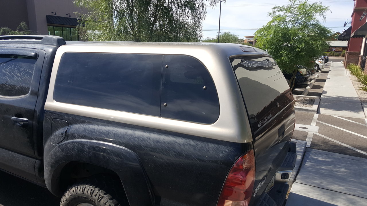

    And the camper shell to replace the bed rack/tire carrier.

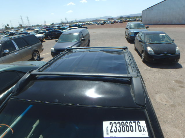

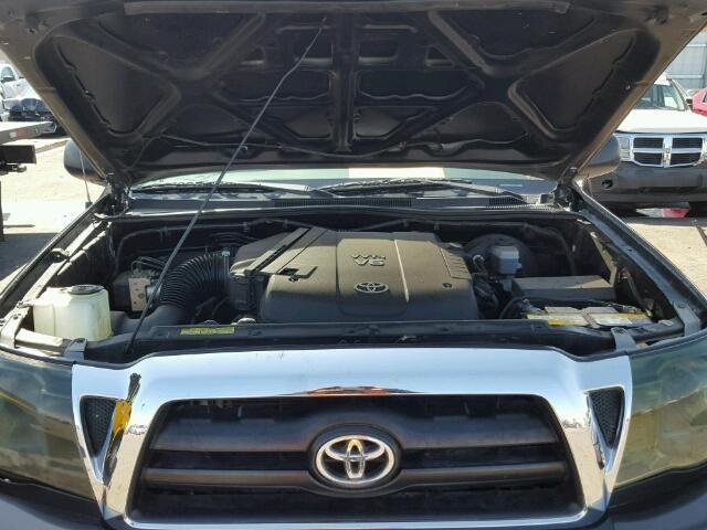

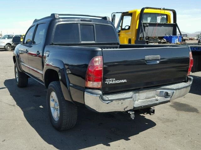

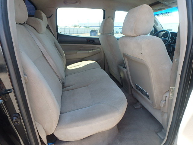

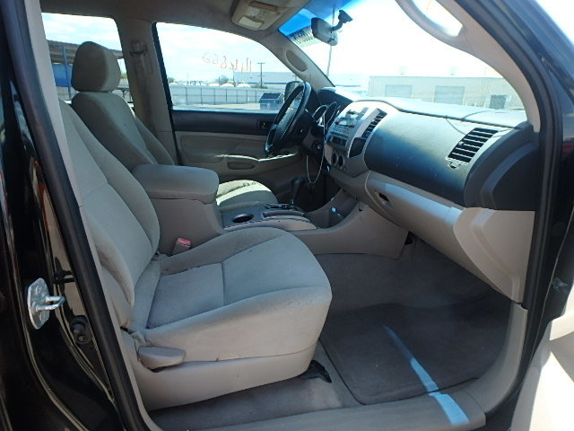

    Here are the rest of the auction pictures. I'll have some reconditioning to do but even after the fairly outrageous fees from COPART I ended up getting a pretty good deal, I hope. I get to pick this one up on Friday!
    Back interior.jpg Back Left.jpg Back Right.jpg Engine.jpg Front Interior.jpg Front Left.jpg Roof.jpg

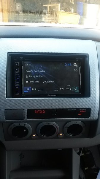

    --New Stereo

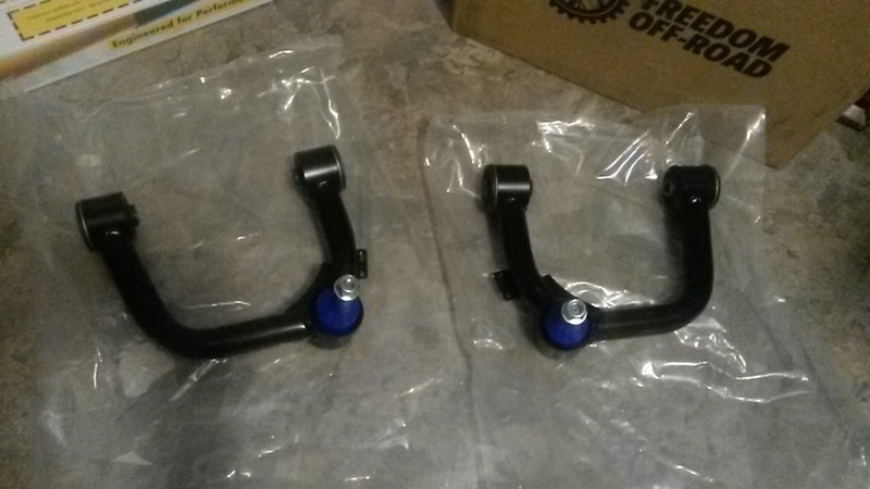

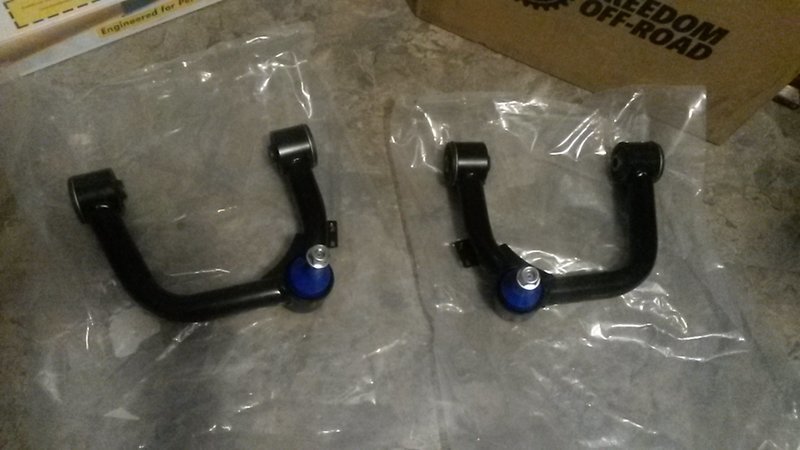

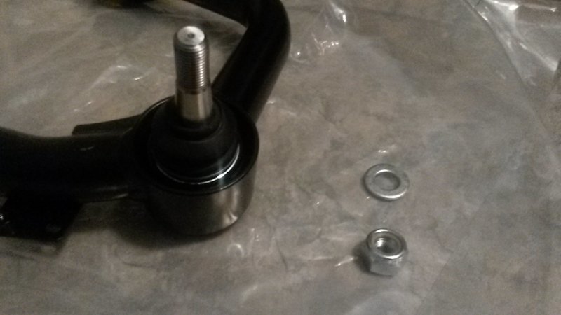

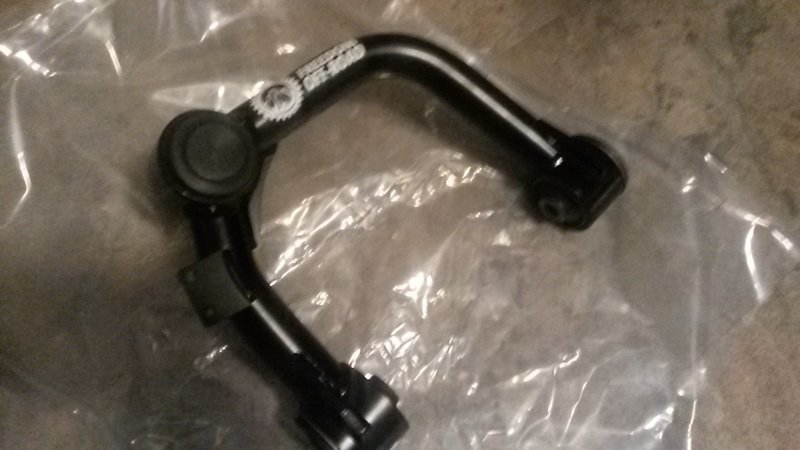

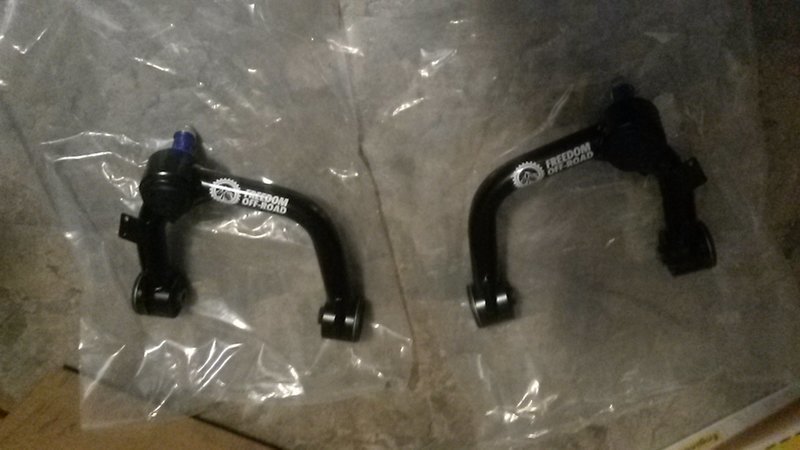

    -I ordered Freedom Off-Road UCAs, I've never heard of them before but for $269 I figured I can try them and see how they are. The pictures are terrible, my phone is 3 years old and was outdated when I bought it. the companies website could use some attention, there seem to be a lot of things missing from it, I bought through ebay. 99% chance they are made in China.
    The control arms themselves are fairly basic, "heavy duty" tubular control arms, some reinforcement at the point there the tubes meet at the ball joint housing and again on the points where they mount to the truck. these are sealed ball joint UCAs, not uniball, probably one reason why they are so much cheaper. The paint missed on a couple spots and the welds aren't amazing, but since I'm not doing any hardcore off-roading anytime soon they shouldn't fall apart. They are advertised for 2"-4" of lift, I'll be running 5100's with OME 887s and should have 3 inches up front, so these should be just fine. I'll get more pictures once I get them installed.
    http://www.ebay.com/itm/Freedom-Off...ash=item43fd0d891f:g:7zUAAOSw-0xYb5XF&vxp=mtr
    20170211_233309.jpg 20170211_233312.jpg 20170211_233326.jpg 20170211_233341.jpg 20170211_233358.jpg

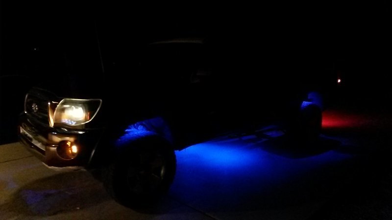

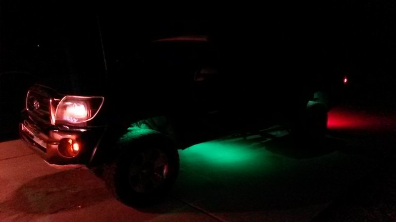

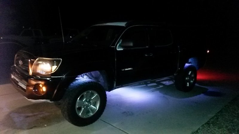

    My wife helped me get my rock lights installed.
    You can see the CaliRaised LEDs and the Eagle Eyes that don't really fit.

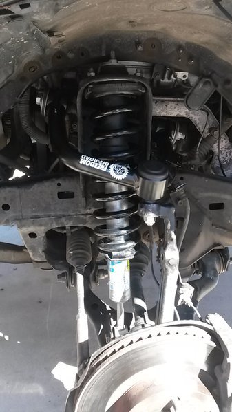

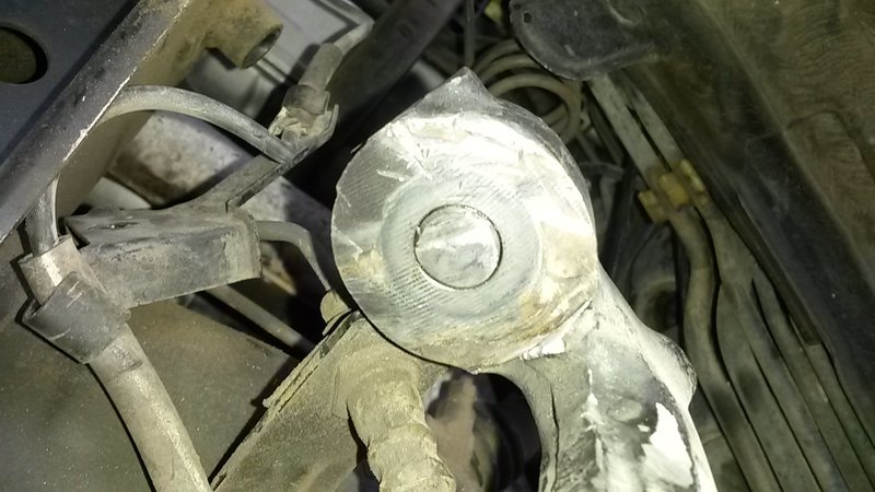

    Got started on the front suspension today. Drivers side UCA bolt refused to come off, turned into a circle, I cut the ball joint off and now the truck sits on jack stands until tomorrow.
    Did the sway bar delete since that was the only thing my tires were rubbing on.

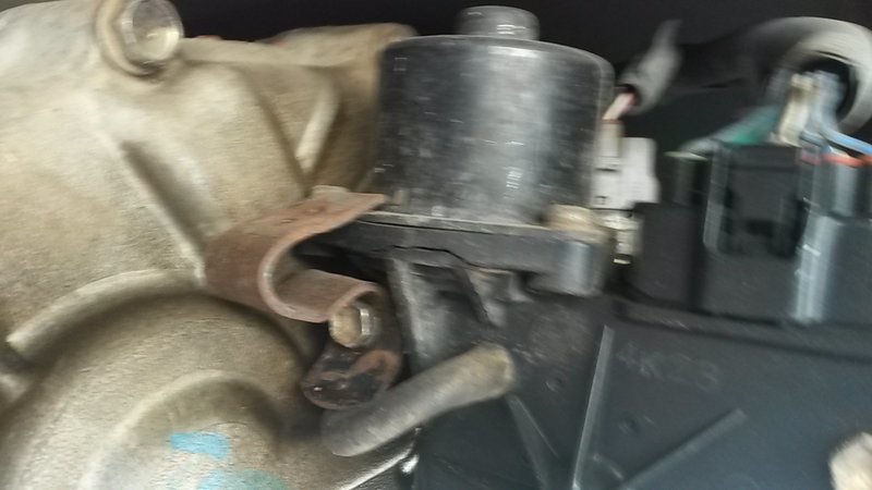

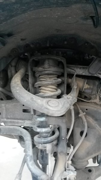

    I did some suspension things recently... this is most of the setup I'm going with (AAL not pictured)
    Old garbage spacer lift :puke:
    The ball joint that just wouldn't budge.
    And finally getting it all back together. Rear will be done soon-ish.
    I discovered a crack in a thing. Terrible picture.

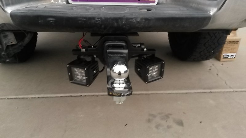

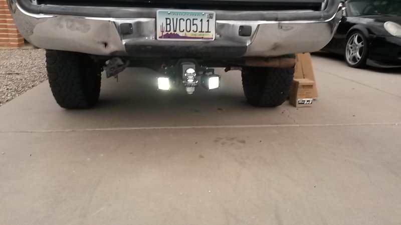

    Installed some 24W aux rear lights, poorly wired and probably temporary (testing the product)
    And them on (much brighter at night)
    The P/O poorly wired the stock system back in after removing his aftermarket setup. One of the wires started melting and smoking and my stock head unit was dying anyways. Got this display model for 1/2 price. Spent <$200 on the whole thing (install kit, wiring harness..).
