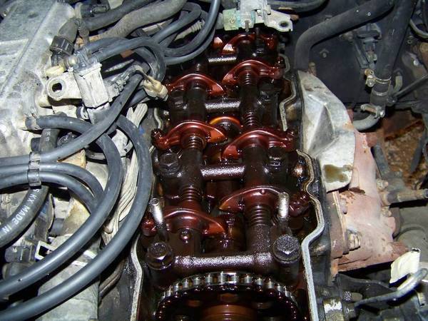

    I wanted to do a compression test on the motor before I started on the timng chain, but my gauge is a piece of crap. It seems logical to do because if I need to pull the head for some reason I would rather do it at the same time. My gauge doesn't hold the reading, you actually have to have 2 people to do the test, one to hit the key & another to watch the gauge. Does anyone (Keith) have a good compression tester I could use? Or does anyone (Andy) want to come over & help me do the test with mine?

    I ended up renting a compression tester last night & got some dissapointing news. Nothing I wasn't prepared for. The compression was nice & even across all of the cylinders, just low. I got 100, 100, 100, 90. I'm looking into what my next move will be. I really don't want to rebuild the short block yet but I'm sure it will need it soon. I am going to look into adjusting the valves & possiblly going ahead & replacing the timning chain & taking the head in for a valve job. The timing chain is def. on the loose side but from what I can tell with just the vavle cover off the guides appear to be intact, so that is good. I am sure if I do all of that the compression will at least be better. I think that even with low compression it will prob run fine, just be somewhat short on power. I will do some research & check back in.

    is that a dry test, or with oil? that does seem low..
