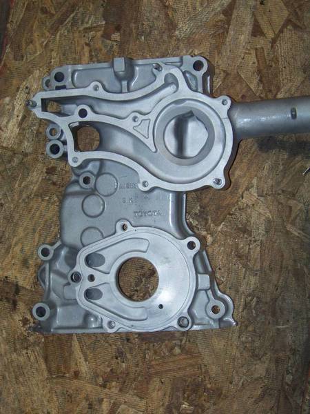

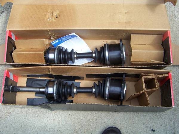

    A few picture updates. I scored a hell of a deal on these brand new axles on Craigslist. I am going to go ahead & install them & keep my originals for trail spares.
    A fellow TW buddy hooked me up with this tail gate, thanks a bunch man! It has a couple dents but nothing I can't pop out. It will damn sure keep my beer cooler from falling out on the trail!

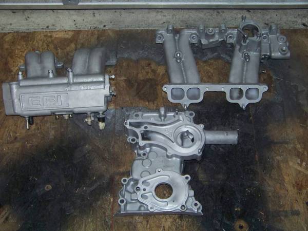

    This is the finished product on the intake manifold & timing cover, I sprayed them with some dupont clear coat. It made them a little darker than they were right after bead blast, but I think they turned out good.
    Thats all for now, my head gasket set & new head bolts should be in tomorrow so it will be time to get this bad boy back together & in the 4runner. I might get it back in by Sunday, maybe next week, just depends on if I run into any hang-ups.

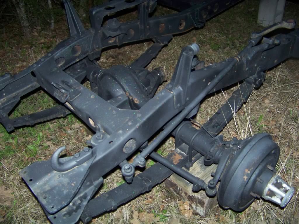

    Rob, did you say that land cruiser frame belongs to you?

    Front Bilstien 5100's Set @ 1.75", rear 5100's & TSB springs, Flowmaster, TRD seat covers, Toyota All weather floor mats, 265/70-17 Michelin LTX AT2's, some Debadgeding, BHLM, led bed lights, 886 back up lights, fog lights anytime mod, Extra d-rings, Toyota bed mat, sockmoney TRD decals, Kenwood 890DNX, Firestone ride-rite air bags, 2 car seats.
    Yes, it 's mine, At my buddies place right now, I really don't have a place to put it. I would love to sell or trade it for something cool, If you know of anyone that could use it, let me know. I don't know a ton about it, other than that it is between 70 & 76 model fj40. I found a chart to figure it out on another forum yesterday, I just need to get the numbers off of the frame & I will know exactlly what year it is. I have been told that the front diff won't make a good donor to SAS my 4runner.
    I'm pretty sure that it is a width issue. The axle is to narrow. I know that it could be made to work, just needs to be modified. I haven't looked into it that much because I have decided that I could long travel the front for less $$ than I could SAS it, plus I think that a long travel 4runner would just plain be cool & different! :D I have been trying to log into yotatech & check the responses on my thread over there but they are offline for some reason. I will let you know as soon as they are back up. Of course, I could let it go cheap enough that you could still afford to modify it if you wanted too. :)
    Mine are def. FJ40 axles, 57" & 56" long & drum brakes all around. It's a damn shame that these are not the most desirable axles, they seem to be in excellent / rust free condition along with the frame. What would be super cool is to buy a fiberglass FJ40 body to stick on this frame.
    Here is a quote from my thread on yotatech.
    "Its a pre 76 FJ40 frame and axles. Some 75's had drums, some had discs though. They are small patern knuckles (steering arm bolt pattern), not small knuckles. Based on the hubs it is not likey a ball and claw front axle. The front passenger side frame rail will have a vin number stamped in the outside just below and to the rear of the of the tow hook.
    Diff ratio is most likely 4:10 but could have been changed at some point.
    You could upgrade to minitruck or 60 series knuckles and discs on that axle housing. I would recommend a complete 60 series axle. If you are going to wheel hard it is the way to go. Save you stripping mini truck ring and pinions."
