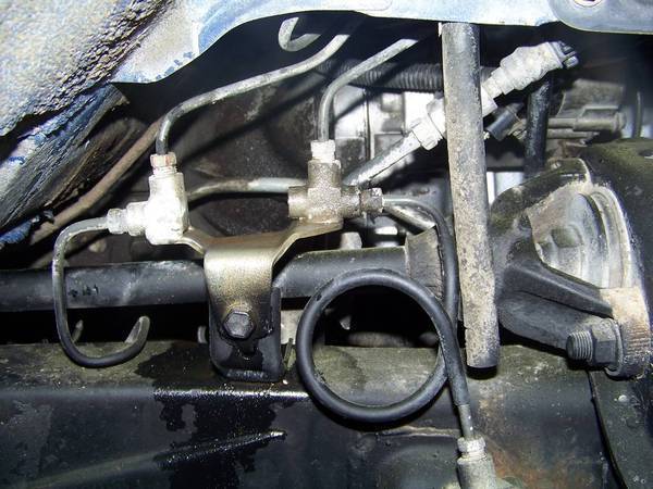

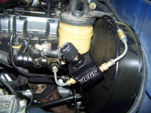

    Of course things did not go as planned last night :(. I got the old load sensing proportioning valve removed & ran all of the neccesary brake lines. The double flaring tool that I rented was a piece of crap, but I am pretty happy with how it all came out. Like most of the other who have done this I decided to put my new adjustable proportioning vavle in the engine compartment by the master cylinder instead of the rear frame rail for easier adjustment. Besides fighting the flare tool, everything went pretty smooth & came out nice untill I went to remove the bypassed brake & didn't have the correct plug. I guess my plan is to take one of the old brake line fittings & fill the trough hole with weld to plug it off. At any rate I should be able to take care of that issue in a matter of 5 minutes, then the brakes will just need to be bleed. Here are a couple of the pics.
    I decided not to mount the new proportioning valve because it would have been a pain in the neck to run the new brake lines, but they are so rigid & the proportioning valve is so light that it doesn't move at all.
    This is how I did the rear line, 1 line was eliminated & this one was redirected from the old proportioning valve directlly to the rear brakes. I would like for this line to be a little higher & tighter but it was a pain to bend without kinking.
    Finally this is where the other end of the eliminate brake line tied into the equasion in the passenger side wheel well. You can see where I need to put the plug.
    All in all it doesn't look like much but took me a couple of hours to do. I think this is going to be a good fix for my brake problem & a nice upgrade aswell.

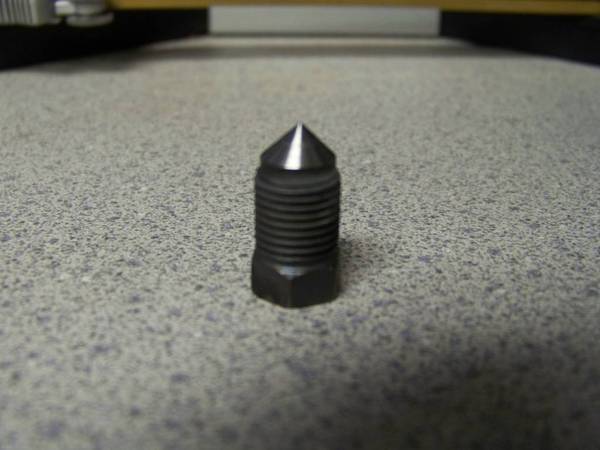

    Just finished this bad boy, It is the plug for the brake line "T" on the passenger side wheel well. I took the original Flare fitting & welded a 3/16" steel rod inside of it & machined it to a 45 deg. point. Should work perfectlly. I love working at a machine shop [​IMG]
