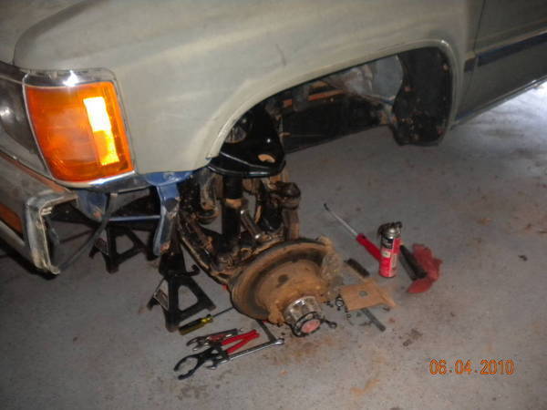

    A few pics just to prove that work is actually taking place, even though at this point I have done more damage than good. The upper ball joint is giving me hell, I beat on that son of a biatch for an hour & a half last night & can't get the tapper to let go of the knuckle. I enlisted the help of a ball joint seperator & ended up destroying the rubber boot. Napa has some in stock for cheap enough.
    I took some measurements to see how much the ride hiegth will change with the BJ spacers. Sits pretty damn level right now....35-1/4" on all 4 corners.
    Notice the upper ball joint is still attached to the knuckle. Even though I am no longer going to use it, I gotta find a way to get it out of there.
    Wonder where all of that red mud came from :rolleyes:

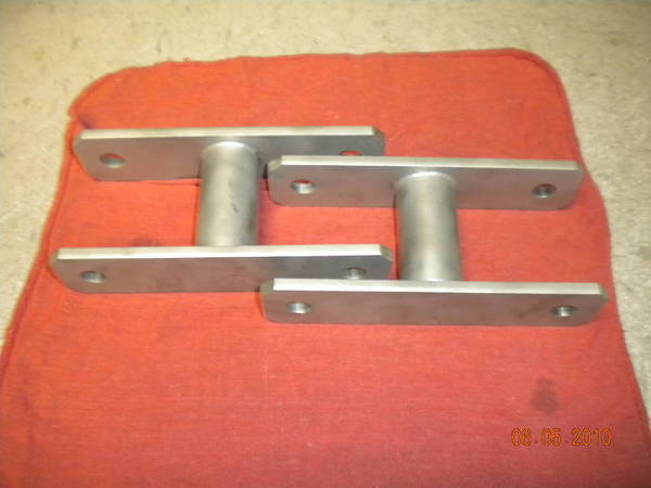

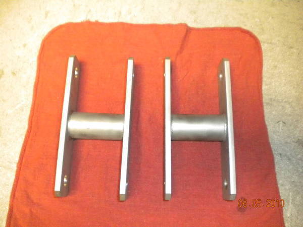

    Well the spring shackles are done. I got started working on the seats but it was just too damn hot! I don't know if you guys can tell by the pics, but these bad boys are hell for stout. Thanks Todd for the beautiful welds.

    Damn, those are some ridiculous welds :thumbsup:

    Todd is the best welder I have ever seen, you should see what he can do with exotic materials...titanium & such. I'm very happy with how they came out, they make my stock shackles look fit for a clown car.
