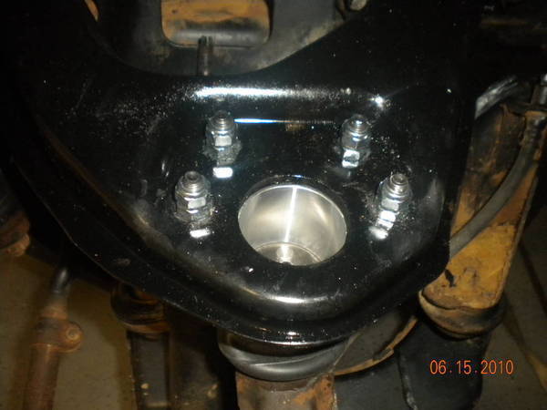

    Got the drivers side Ball Joint spacer in last night. All I can say about it is what a pain in the ass it was to get in there. I can't beleive it took me so long to do just 1 side. Anyway.

    Thanks guys, I am pretty proud of them, now hopefully they work as good as they look. I've read abunch about them on Yotatech & everybody loves theirs & claim to get 2" more lift & travel out of them. I am going to need longer shocks though. Maybe some homebrew extenders to start with.

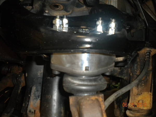

    I took a better pic of the BJ spacers that wasn't so close. Other wise just more of the same. At least it is better than just self bumping :eek:

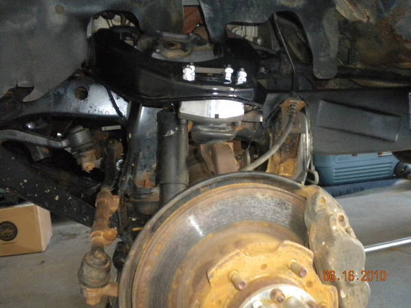

    Having some problems here. I got the second BJ spacer installed in no time flat, no fighting or cursing. It was very easy. I put the tires on & set it down to find out that the first side I did is in some sort of bind. NO SUSPENSION TRAVEL AT ALL! Not even a 1/2". Something is not right. I pulled this side apart at least a week ago to get measurements for the spacers & the LCA has been hanging ever since. I think that the CV Joint is in a bind with the manual hub. I am trying to get the hub off now but it is in a bind also. I tried pretty hard to dislodge it but I really don't want to force it to the point of damage. The CV joint is definitely in a bind with the hub because with the hubs on FREE I should be able to turn the wheel separate from the axle like I can on the other side.
    Also, I have to get some wheel spacers before I can ride on the BJ spacers, the UCA is rubbing the tire :(
